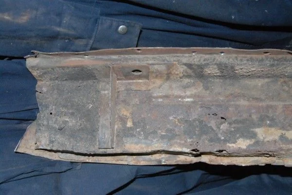

Here you go! The first picture is what you see when looking from the front of the truck towards the rear. The second picture is a top view which is normally hidden by the floor and "D" pillar. The center of the sill is basically a continuous section with the exception of the hinge area. As you can see there is a body mount captured in there as well. The back of the frame sits in the pocket in the first photo.

Exactly what you see in my earlier post from one side to the other including mounts and tailgate hinge area.

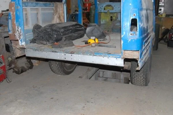

All that I did to remove it was drill out the factory spot welds so when I reinstall the new piece I will simply weld at the factory locations to mimic the spot welds. As for the curved section at each end, I left that there to see, and give me options, with the rear quarter panels which should also cover that area. The last thing I want is that the rear quarters and the rear sill stop with a 1/4" gap from each other! The curved up parts that fair into the "D" pillar are part of the rear sill as well and I will be instructing Paul to include that. He prefers to make the entire piece anyways.

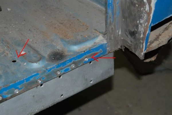

Here's a picture of the rear of the truck showing the sill missing. That should help clear things up. The red arrows are where the row of factory spot welds are to hold the sill in place. If you examine your truck you should see the same thing. The row of spot welds continue right to the inside of the quarter panel which is why I had to open up the corners.
