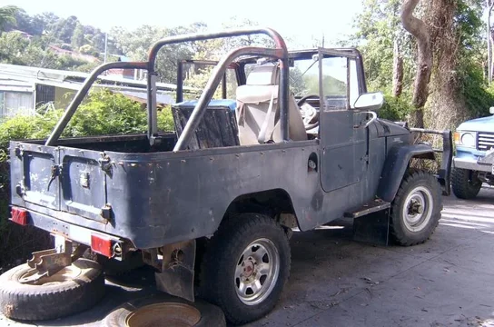

G'day all, I am currently rebuilding my 1968 fj45p and was told of a parts car that looked like mine and was going to be s****d so went to look and its a 1962 fj43 . I ended up draging it home on a trailer but now what to do, are they worth anything as ive never seen one here before. thanks. 005.webp
Super cool find. Glad you saved it. Doesn't look too bad from the picture. My dream project is a 43 soft top (love that wheel base). If you can't find a use for it or buyer there, let me know. I'm sure I'm not the only one that would love to have it. Definitely worth saving either way.

Thanks for all your replies,i will keep it complete as it may be worth restoring to somebody. Do the doors look original as they are shorter than my fj45"s. Almost looks like fj25 door cut outs. hope this post is ok in the 45 section. thanks. warren .
Door opening looks different than anything I've seen. Would like to see some better detailed pictures. The doors appear to be from a later 4X series that have been cut off at the bottom. 1962 would have had bug catcher vent windows. These look to be the newer style. A FJ25 and early FJ40 soft top door would of had a angle up at the back of the door. These look like the standard hard top opening only shorter at the bottom. How is the windshield held up? In the US up until the 64 model the windshield used a stud on a bracket that was held down by a nut. The nut had to be removed to lower the windshield. The barn doors on the back open the other than the ones we got in the US. Are the supports in the tub forthe spare tire carrier on the left side. The reason I asked the license plate bracket mount on the right door is for one we didn't get until sometime in 1974 which makes me wonder if they were changed at some point. I think this may have had the ambulance style soft top doors originally. If this was mine it would be done as a original soft top with soft top door on front since they would be easy to cut down. Soft top ambulance doors in the back with OEM soft top bows.
Post pictures of the inside door openings, door hinges, windshield hold ups and the inside of the back doors. Does it still have the side shifter three side. It should have one that the shifters come out the right side. This is the only transmission I know of that had right and left hand drive models. From mid 63 the top plate was different but the housing was the same.
So many questions and yes it well worth restoring.
Here is a link to would was sold as a 63 tub but ended up being a 62. There are pictures of what a early FJ40 soft top tub door openings looked like. The windshield latch system had been changed to a later style. I will check my early FJ40 microfiche. I have 62 and 63. May cover the FJ43. Also what is the first number on the VIN on the frame. This will tell year of production.

Is that tape or fabric on the inside driver side sill?
It looks like the panel under the doors has been lifted and the doors have been shortned by the shape of their bottom. Worth keeping to restore.
I doubt the bottom panel has been lifted. It looks to be the same height as the FJ40 soft top model of the same year. Just not angled up at the back. Would like to see a better picture of the bottom of the doors. They are the bug catcher vent window type, correct for 62. I've seen both crank and slide up windows on 62s. Curious if the lower hinge fixed nuts in the door were added or there from the factory. The early soft top that hinge is higher than hard tops, while the top one is the same height. It was a soft top model since it has teh clamp for the bows in the back corner. The bracket is there for left side spare tire carrier. Here in the US we only had the left side carrier that wasn't tube style in 75/76 hard top models. The hardest part to find on those is the catch on the rear sill.
What does the back of the transfer case look like? The cover for the transmission tailshaft have four bolts and round tube (early)? Or does it have six bolts and tampered (later post mid 63)? Does the engine block number match the one on the VIN plate? Rear axle have the centered diff? Keep the pictures coming.
