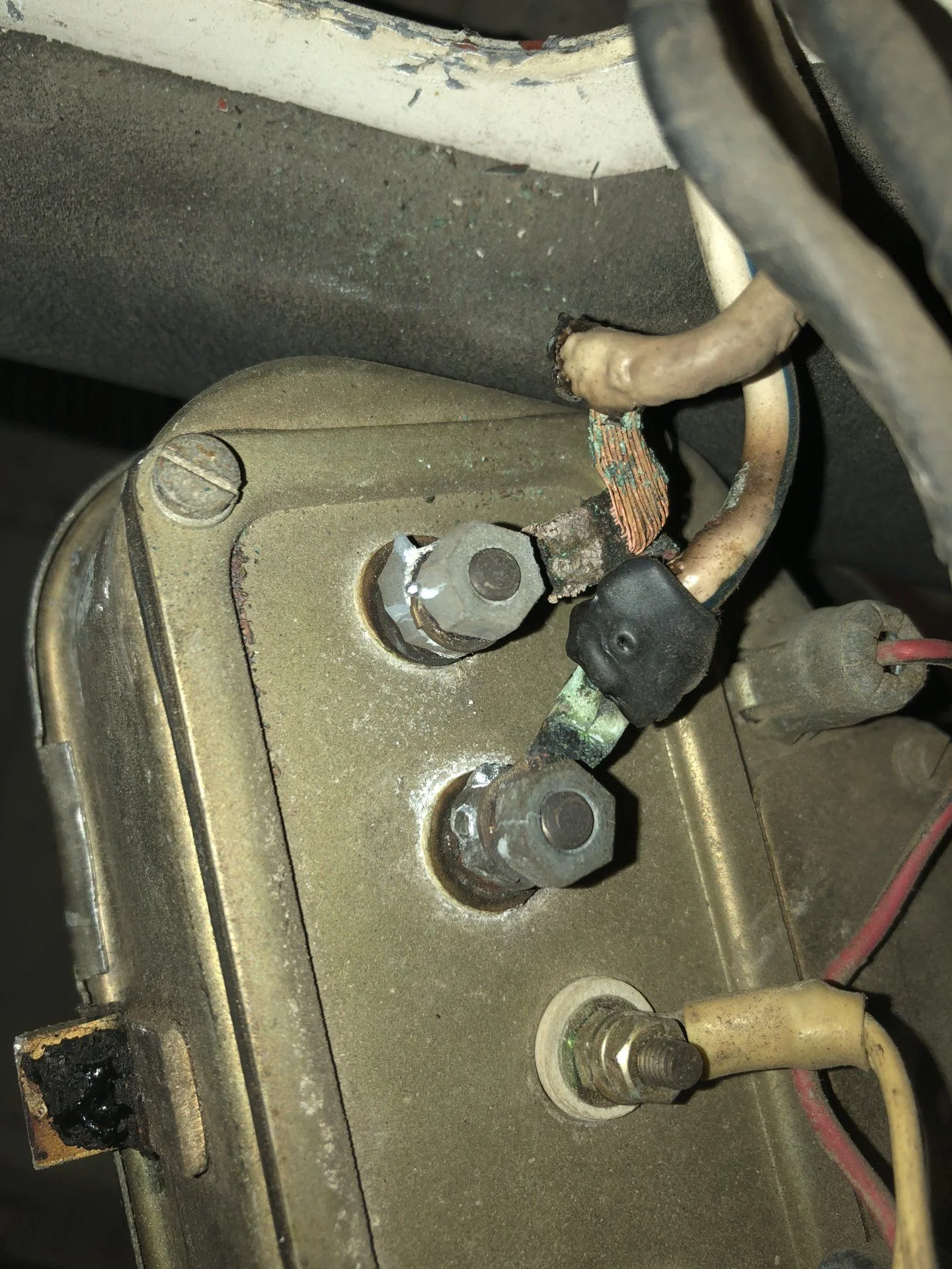

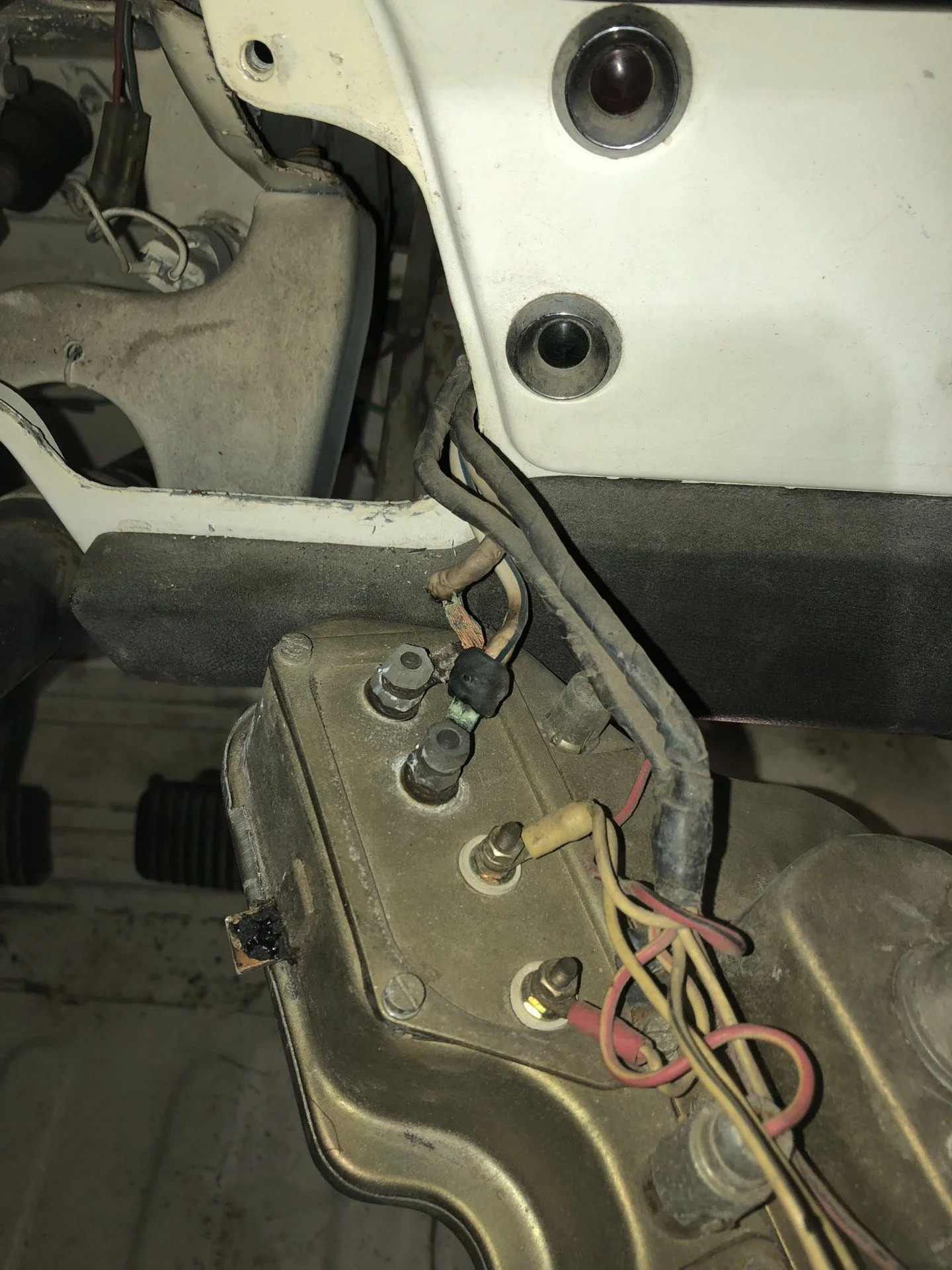

Pulled the instrument cluster loose the cables to the amp meter sure look suspicious:
Uh yeah, I would say you have found your issue! Hopefully that melting is only right there at the connections and not all through the white and white/blue wires? Looks like it may have shorted right at the amp meter connections. Take those connections loose, clean them and the post, n tape it up good, and try it again.
I also sell those amp meter ring terminals for the white and white/blue wires. You can cut off the bad wire and crimp/solder on the new terminals. You should have plenty of slack to do it. Send your address to fj40coolerman at gmail dot com and I will get you a total for the link and anything else you might need. I will build the link tonight.

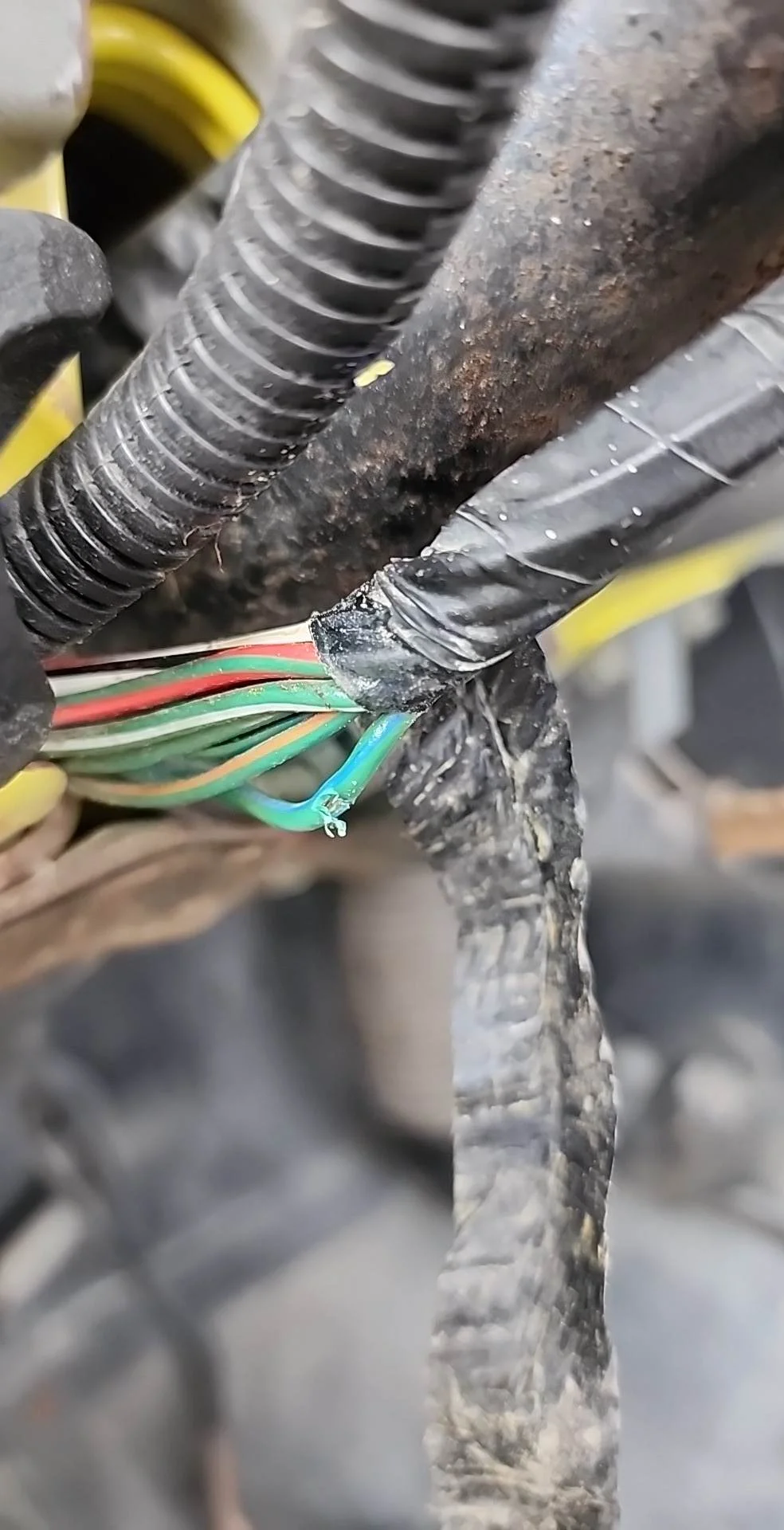

Having the same issue as the one who started this thread with my '76 FJ40.. all lights work except turn signals. I tested a few things already, including the "GL" wire that is mentioned in a service manual I have.
If this wire pictured is the GL wire (green-light purple), i get around 8 volts with the turn signal switch in the resting/off position and 0 volts when I turn the switch one way or another. Does this rule out that the turn signal switch is bad?

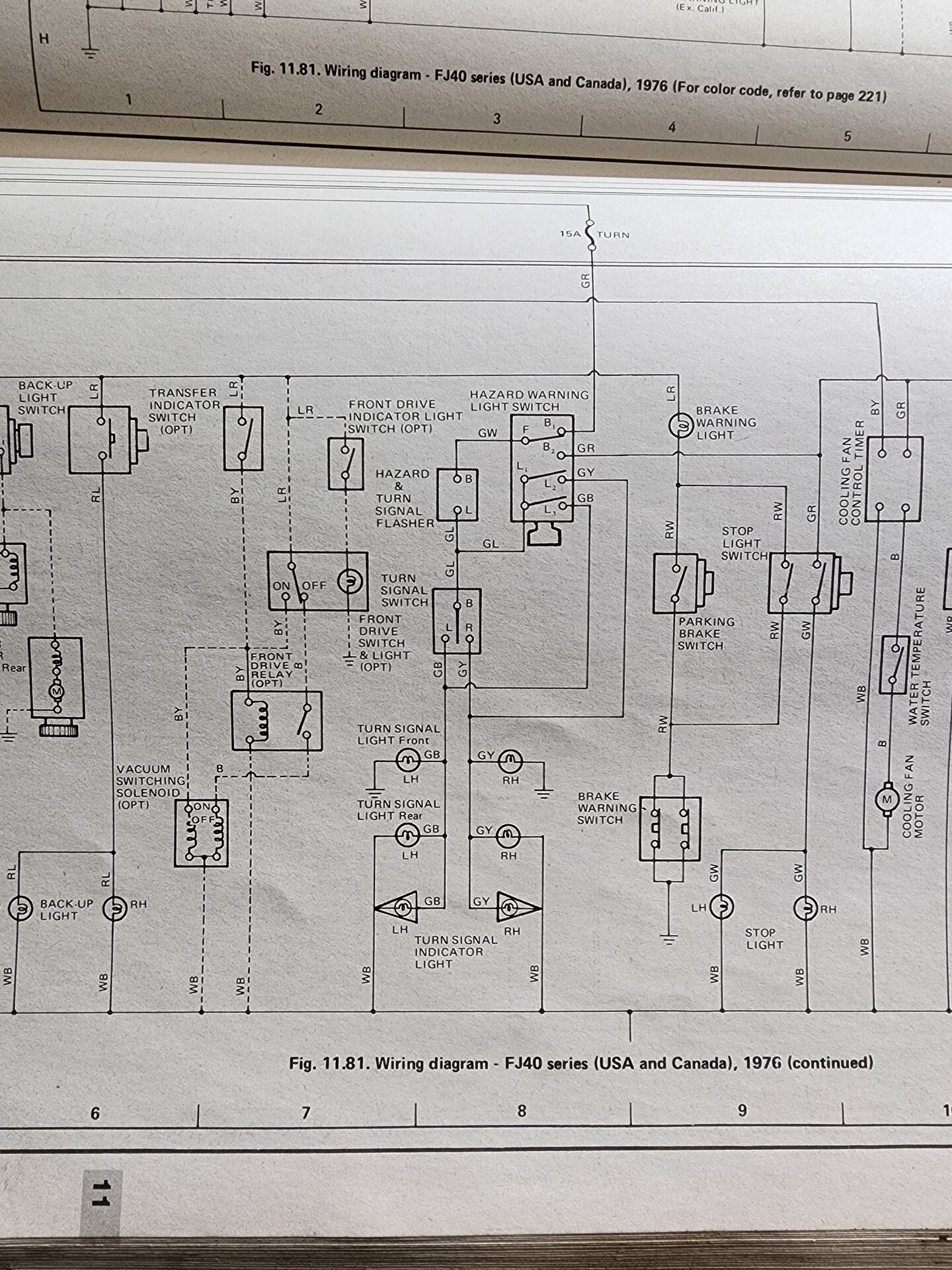

As you see in the wiring diagram, the hazard lights are powered through the stop fuse, while the indicators (turn signals) are powered from the turn fuse.
Both run through the hazard switch connector.
Check the hazard switch connector isn't corroded or loose.
Check the turn fuse is sending power to that connector (when ignition is switched on).
The GL wire is actually two wires which join through that same connector. Check for continuity between them.

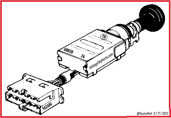

- here is a 3rd GEN. and 4th GEN. HAZARD SWITCH details Spec.
- a BAD CONNECTOR Housing / Housings / TERMINALS does cause the above symptoms
- so can the switch itself internally absolutely does burn up from age time corrosion ....
- the TURN SIGNAL switch CAN be involved here , but typically does NOT short circuit up top at the horn contact , BUT the LOWER two connectors CAN burn up in every way ...
- so Careful inspection of the 4pin and 2pin connector plugs is absolutely necessary here 100%
- the FLASHER BOX or CAN 81980- i have NOT seen burn up ever ? the do fail inside but do NOT cause any other bad electrical problems
- i offer both NOS and professionally Restored inside and out
HAZARD switches 's
- all post restore bench tested of course..... :)

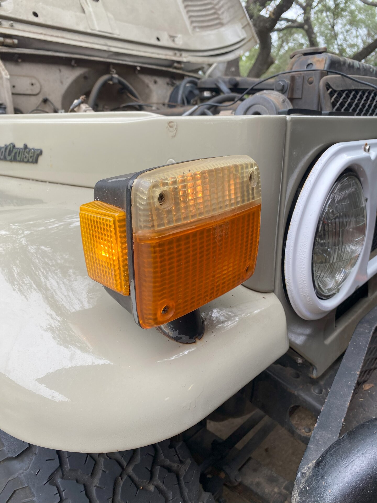

Here's one last bit of info. While checking the grounds I noticed one possible issue, but I need clarification. Correct me if I am wrong:
  1. On the front light assembly, the side marker is the turn signal. Should only be on when turn signal is selected.
  2. The top front is "parking light" on when the headlights are on.
  3. Bottom front is turn signal and on when turn signal is selected.
Is that correct? Because this is what I am currently seeing when the signals are "frozen" with right blinker on. Looks like the wiring is wrong.
The grounds are good, there is continuity through the bezel of the lights to the chassis.
The lights that are currently installed are:
  • Side Marker - 10 W
  • Front Top - 8W
  • Front Bottom - 23W
Thanks!
Seems like they're wired up incorrectly - maybe send a photo of the inside.
The fact that the top bulb is only 8W, probably explains why they're not flashing.
If you switch the 21W bulb into the top slot then they should flash. Albeit with the white bulb.
Then rewire them and switch the bulbs back.
Thanks, rewiring is complete on the driver's side and EVERYTHING IS WORKING!
The passenger side is going to be a bit more work as the wiring is trashed and the lights are very dim. I'll run new wires and (if necessary) resolder everything. Pretty sure we figured out the issue.
It was your mention of the "21W bulb" for testing that got me thinking this way. Thanks @45Dougal !!
Now, if anyone knows were to get gaskets for these light assemblies...:rolleyes:
Ok, Cleaned up the passenger side light. Stripped out the PO splice and corrected the incorrect wiring arrangement. Everything is working. Solid grounds and bright running lights. Blinkers blink and hazards hazard!
Need to add to the basic troubleshooting list, "Are the correct lights wired as blinkers?" :beer:
