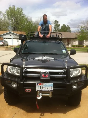

Here's a pic of the Donaldson on my 4Runner.
~Daniel
Sent from deep in the mountains of Honduras using only sticks and rocks.
~Daniel
And the 4Runner one looks like 10", if I'm not mistaken (H002425)...?
Yes it is a 10"... I have a V8 4.7L and I wanted to be sure to get plenty of air! Works fine and it seems to shift smoother actually.
