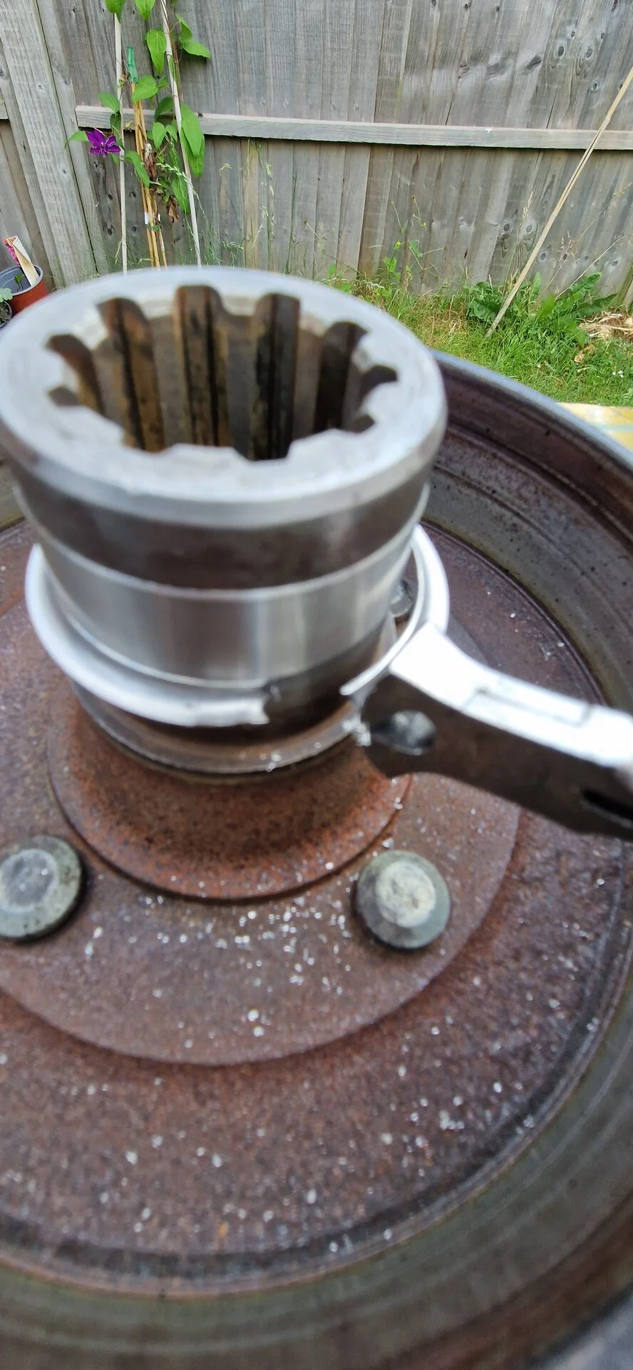

I've only used one on the handbrake.
As long as the worn shaft is true then just a bit of sealant should fill the wear.
If its heavily pitted or asymmetrical then maybe worth turning but if you're only turning down the thickness of the sleeve then it's not worth doing.
Otherwise you'd need a smaller size speedi obviously and seal to match.
Also remember that the drive end of the speedi has a radius, so it can't butt up against a turned lip
