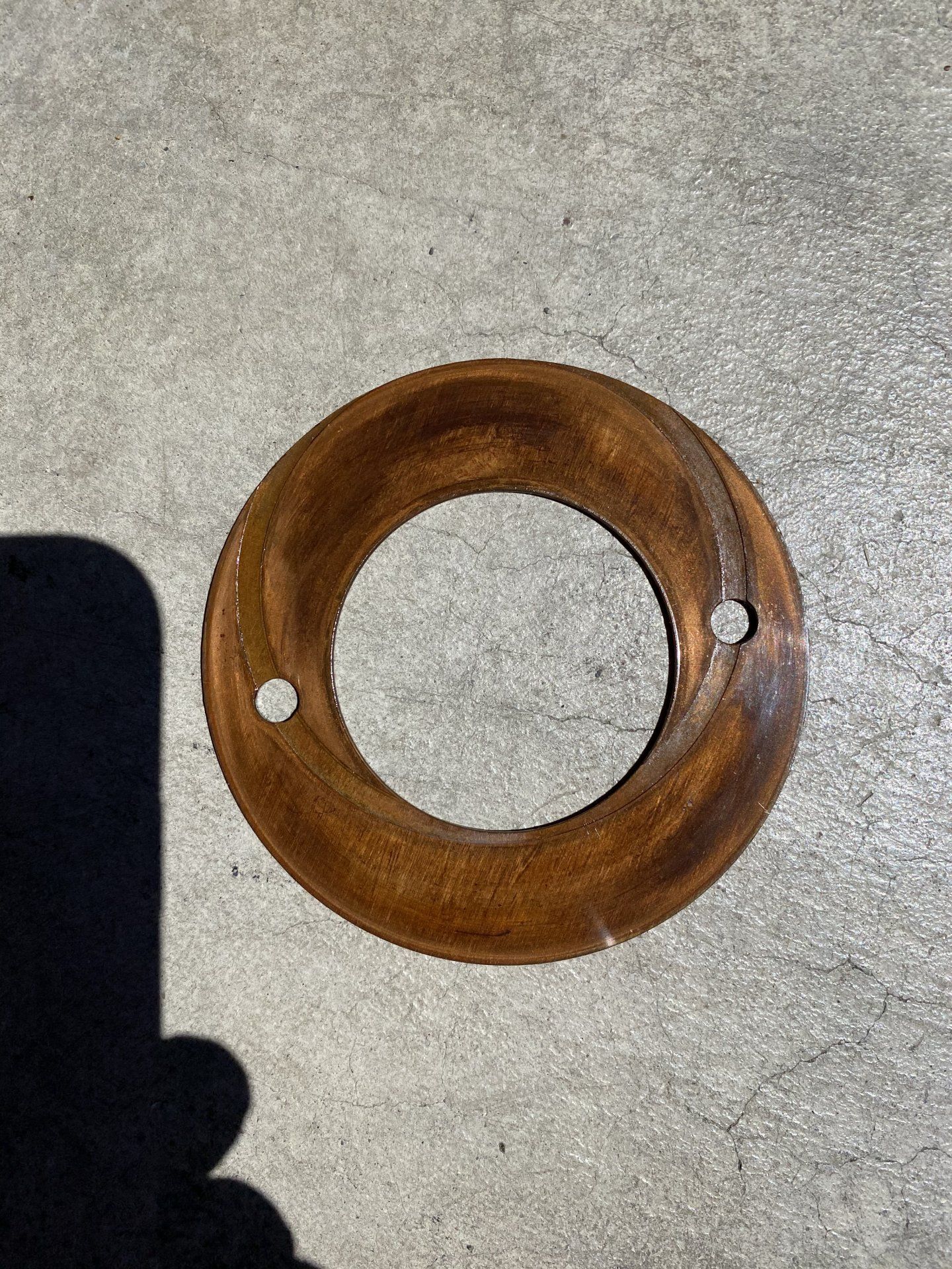

I am putting in a new Aussie locker in my 69. I replaced the wheel bearings and seals while I had it apart. But the Aussie locker said to inspect the thrust lockers and replace if necessary.
At first I thought the old ones were ok. Not warped or worn. They had this nice copper look to them. Then I looked closer and they had this groove on the inside of both thrust washers that looked like they had been run up against a pipe. So I thought I better get new ones.
But the new ones I got are 3mm less in diameter and I’m worried about dirt or a metal shaving getting in the gap.
So I looked at the original ones closer and the channel looks more like part of the design rather than wear. They look like a much better design.
Which ones do you all think I should use?
Is there a difference in the thickness between new and old? You're correct that the groove is indeed part of the design.
They are both the same thickness, about 1.50 mm.
The Aussie locker seems to require this thickness. The thrust washers come thicker if you need them but I found it is a very tight fit even with these smallest thickness thrust washers.
If the stock ones meet the required tolerance, I would reuse them.

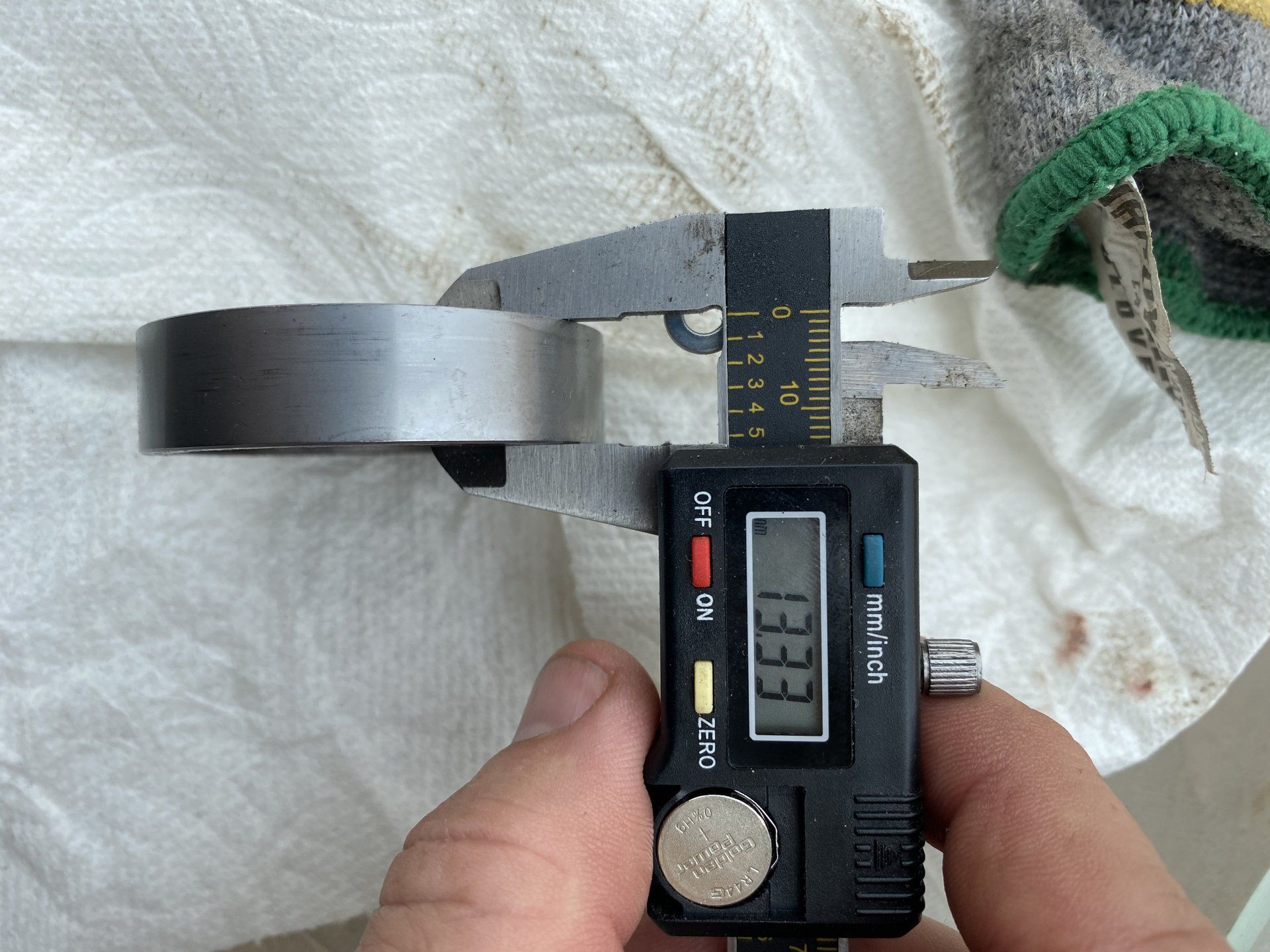

On the center gap I am supposed to be between 3.68 mm and 4.55 mm. I have values from 4.66 mm to 5.03 mm. Doing the math, I need to go to the 2.0 mm thrust washers which will reduce my gap by 1mm.
However, when I do that I will ruin my inner spacer gap. The Aussie tech support told me to use a belt sander on the spacer faces and take off .5 mm on each.
I am not sure I am happy with that solution. I’d rather have Aussie send me a new spacer but they said the land cruiser was unique and they didn’t have other width spacers.

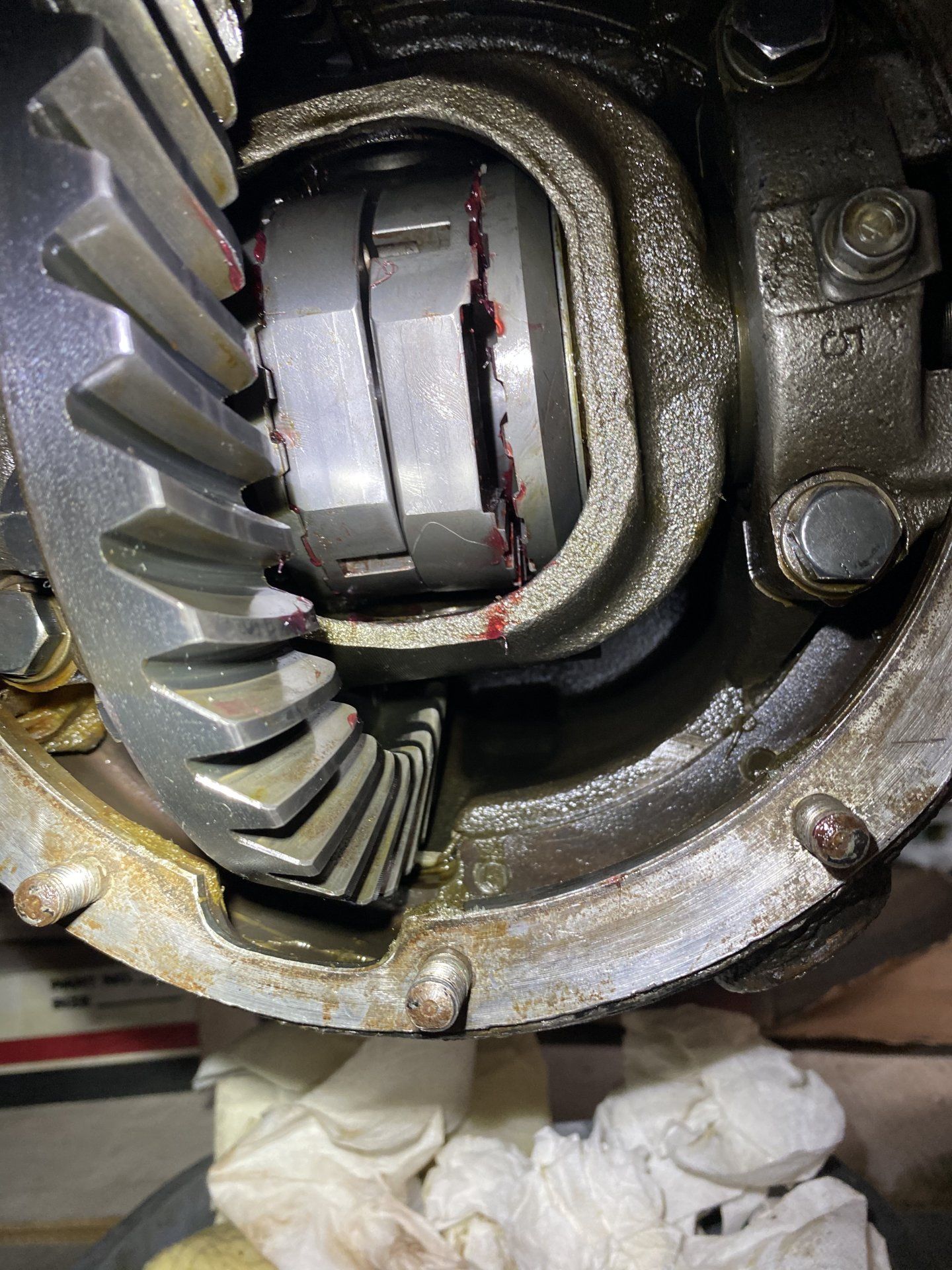

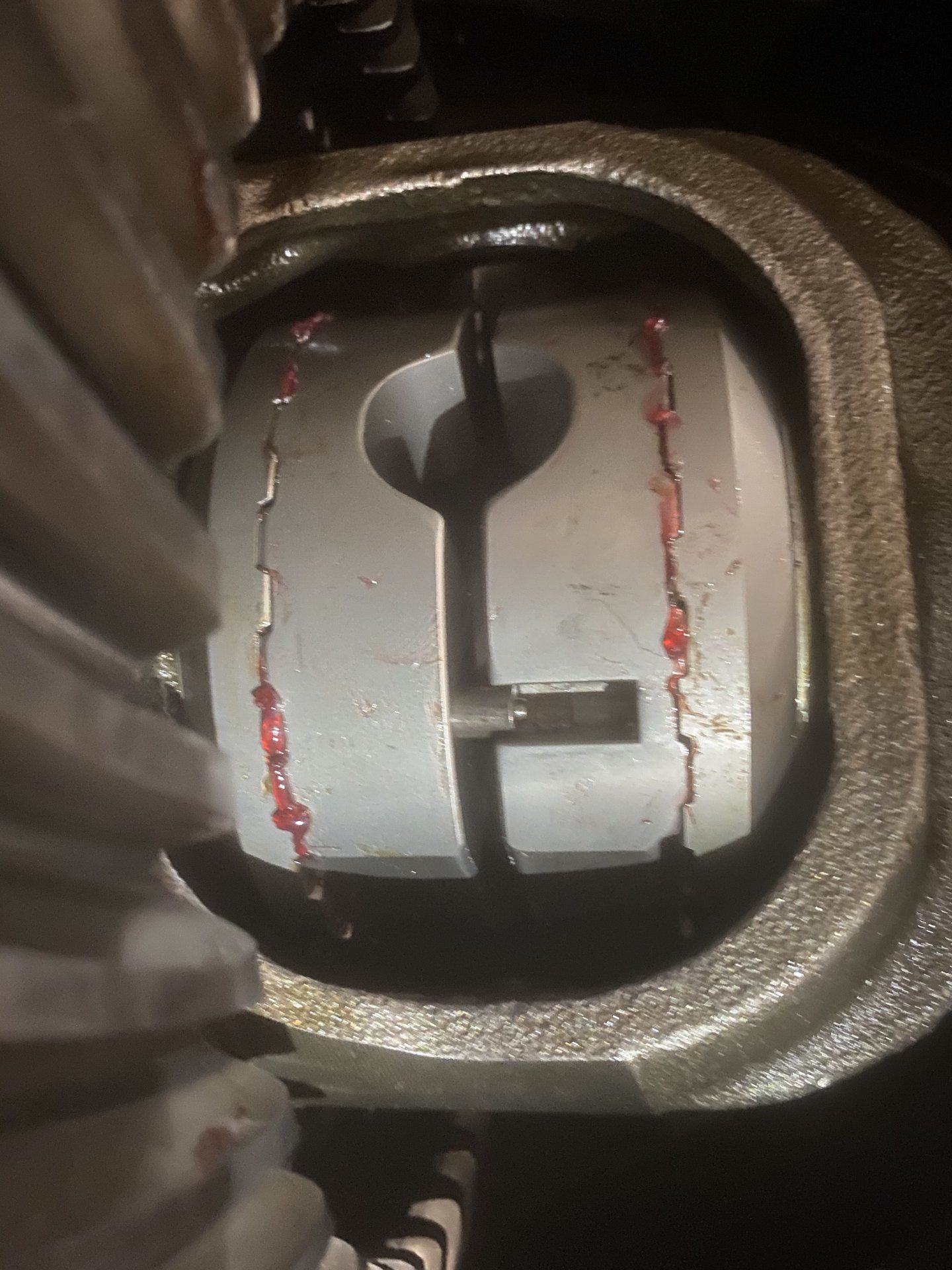

I ended up getting a belt sander and using some thicker 1.80 mm thrust washers from SOR. So I had to belt sand off very carefully .3 mm off both spacers. So basically I added thrust washers that were .3 mm wider so I had to trim the same width off the spacer. This brought my center line space into tolerance after I put it all back together again. I had to assemble and disassemble the Aussie locker 4 times so I got pretty good at it.
Here are some Aussie Locker tricks they don’t tell ya very well. First you install the left and right outer gears on the axle splines. The axle splines need to be out pretty far and not pushed into the casing much or you can’t get the Aussie gears and spacers in there.
Then put on the left C-clip and spacer and pull the left axle out tight. Use lots of thick grease on the gears so it sticks the parts together when you assemble things. Otherwise you need four hands.
Insert the left inner gear over the left spacer and squish it in tight to the left outer gear.

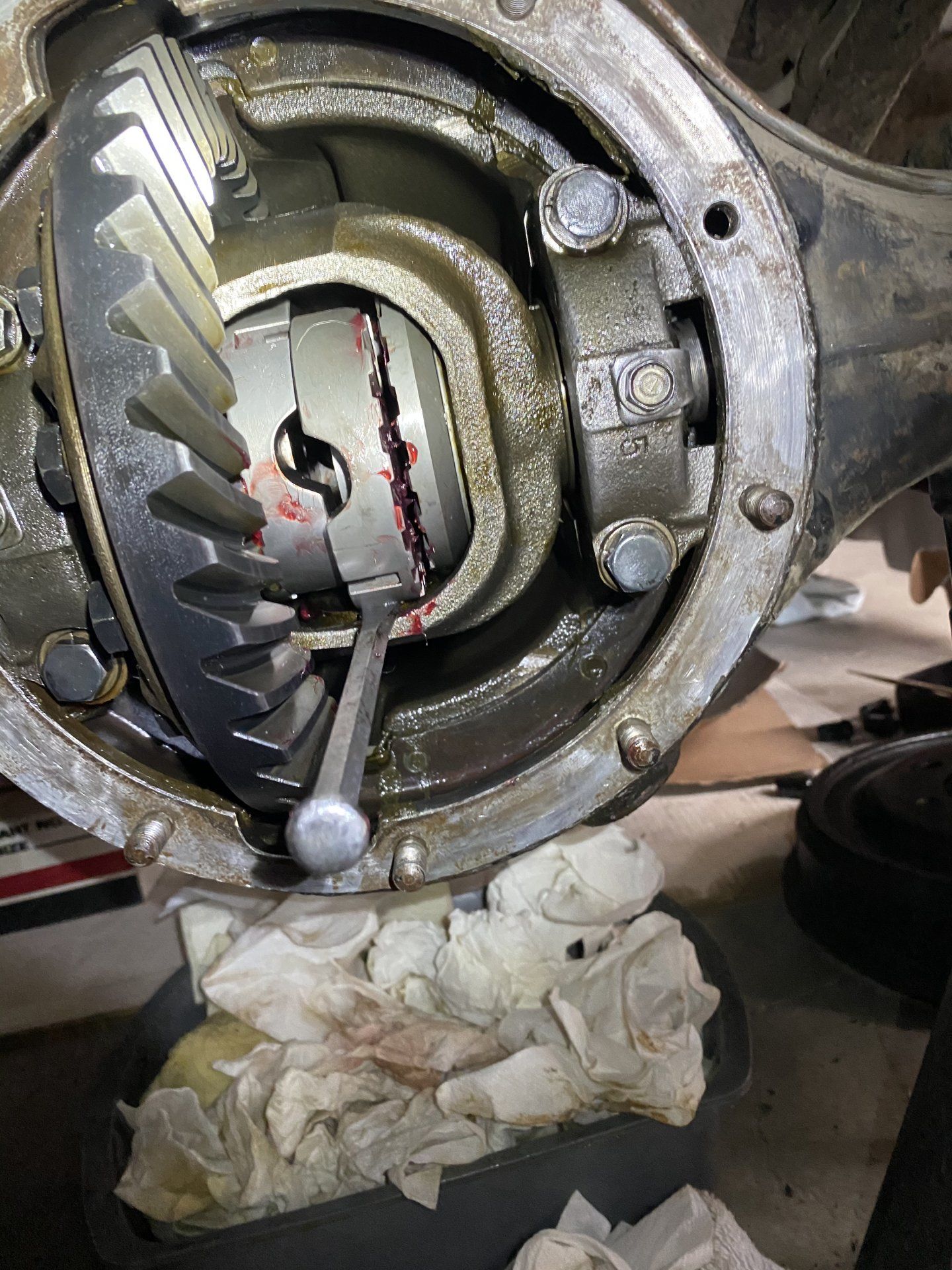

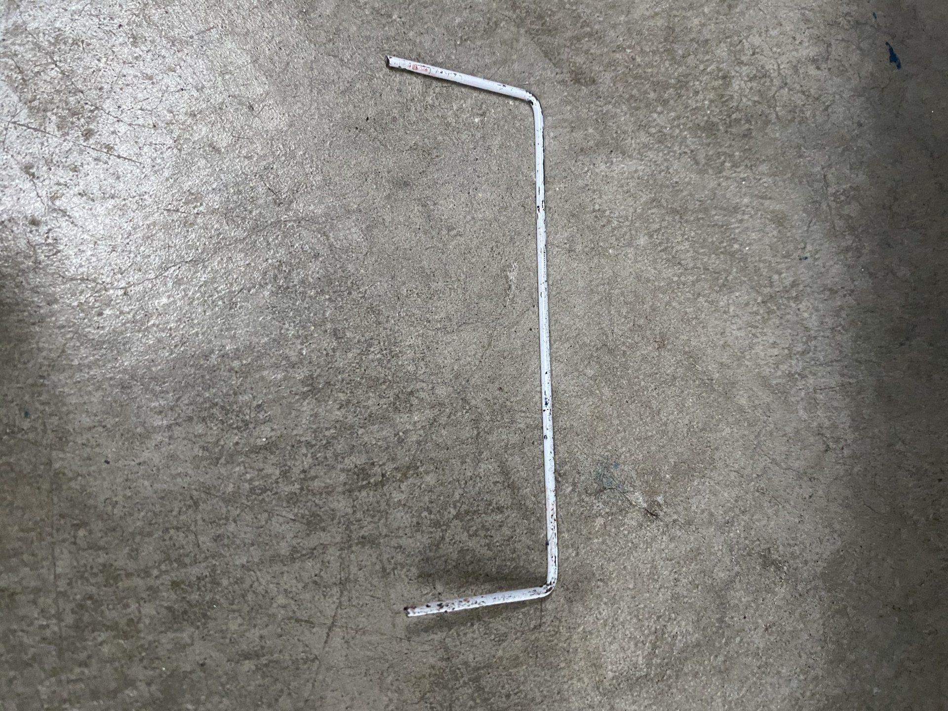

Ok so now the right inner gear with the spacer inside it gets pushed into place. It’s only wide enough to do them together. Then they tell you to make this handy tool out of a freaking coat hanger. For $350 bucks you’d think they could have made 10000 of these and provided it in the kit. So here is the tricky part. You have to hold the right inner gear up so it is against the left inner gear and you stick in your coat hanger tool to push the right spacer back into the hole in the left inner gear. If you accomplish this everything will hold in place on the left side if you have enough grease. If not you will need to insert a screwdriver at the top to hold everything apart.
Here’s the coat hanger tool. 6” long. 1” bends.

Ok, so now the next tricky part. The manual just says install the right c-clip. But seriously it’s 3mm wide. You can’t get your fingers in there or needle nose pliers. Also they don’t tell you that you can rotate the right inner gear 90 degrees and it will give you more space as there is a little indent in the gear. So rotate the whole assembly on the left 90 degrees.

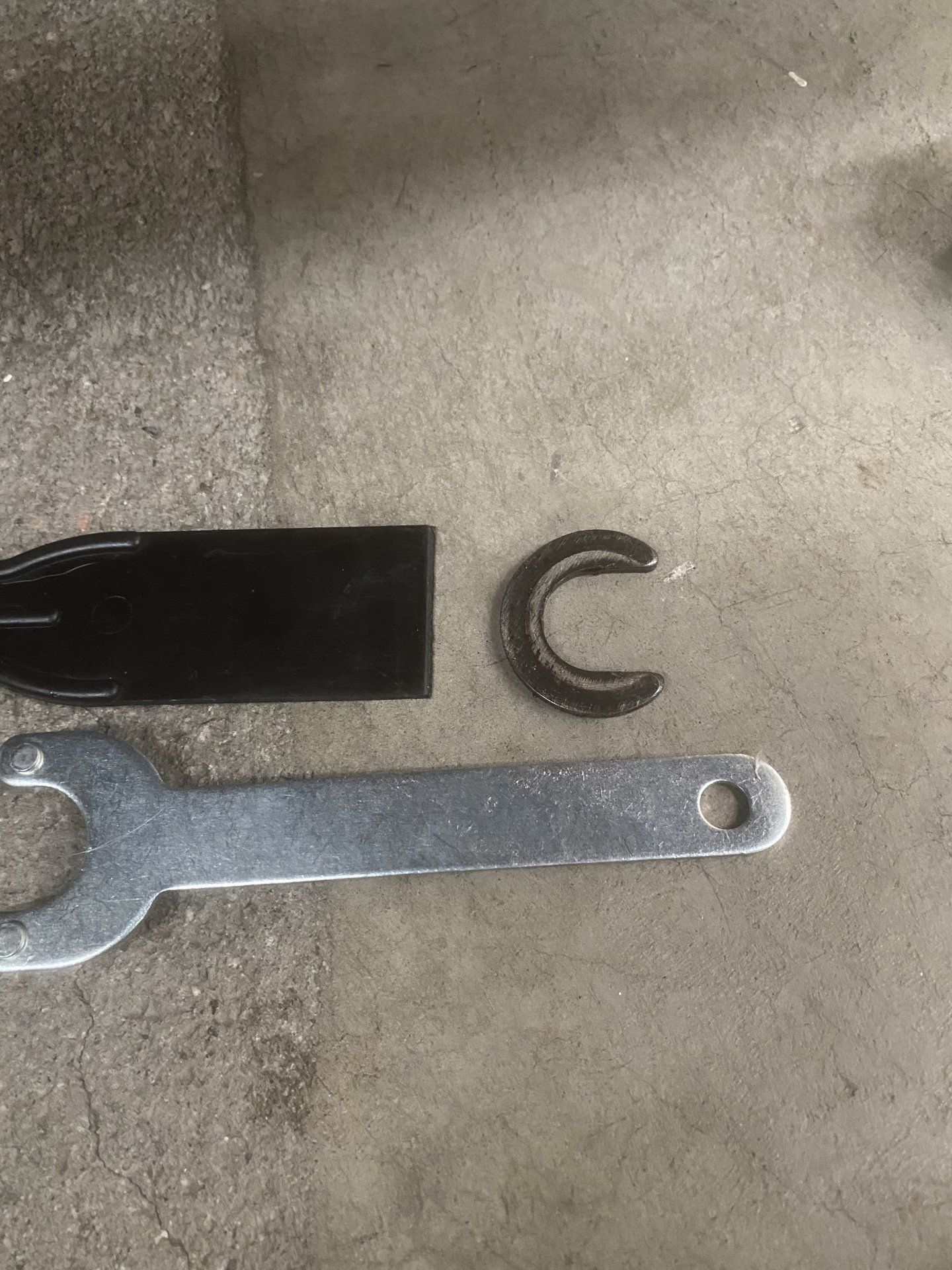

To get the C-clip in you have to use some ingenuity. Somehow you have to support the c-clip so it doesn’t fall down into the gear and you have to push it into place. I used the below tools I had on hand and after a few tries I got the c-clip in place.
Rotate the right wheel 90 degrees after you get the c-clip in so it doesn’t fall out on you while you move the right gear and spacer back over it. I had to support the right gear again at the bottom while I pushed everything over and had to use my hanger tool to push the spacer back over to the right. You have to remember to pull the right axle out to seat the clip and give yourself enough room to put in the center pin.
