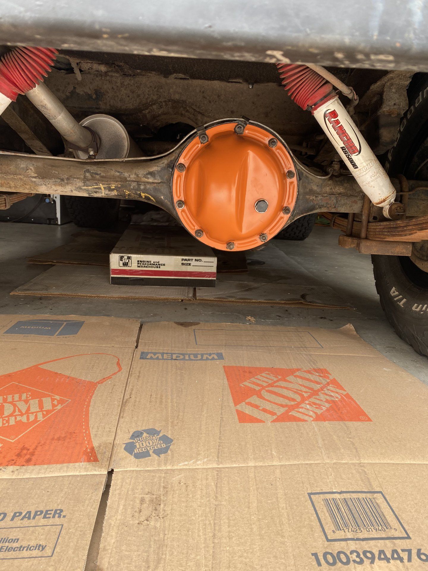

You can put your finger in the center pin hole to further separate the spacers and make sure they are firm over the c-clips. Installing the 4 pins and springs is easy but only lube with oil in case you have to take them apart. After all the songs are in you need to measure the center gap from several rotations to make sure you are within tolerance. The instructions say it should be between .145 and .170 inches or 3.683 to 4.55 mm. The first time I installed this I had some gaps over 5 mm. So I installed the next size up thrust washers which was 1.80 mm. I probably should have gone up to the 2.00 mm washers as my center gap was still only at 4.30 mm after all my efforts. As pointed out above by another user it appears the tighter the gap is the better the Aussie locker performs. But the owner of Aussie locker told me the max gap could go up to 4.83 mm. She was very helpful and responsive on technical support.
I spent a lot of time getting the old gasket off the cover and rear diff. Especially tricky around the bolts. I probably spent more time getting that all cleaned up than installing the Aussie locker. I used the gasket and some black sealant on both sides and let it dry 24 hours before adding gear oil. On the streets I did notice the ticking sounds on turns. Straight ahead I heard nothing. I squealed the tires on a few slow turns. I think as long as I coasted through turns it was pretty quiet. So I am still figuring out the best driving adjustment style but I am happy to have this locker installed and I can’t wait to test it out. Oh and don’t forget to paint your pumpkin after all that hard work!
Nice job. It won’t take long for you to figure out your driving style. I’ve had one in my cruiser probably over 20 years. I wore the first one out. And am on my second one. ,the teeth will loose there square corners and will start to slip when worn out my first one I set up just like you did. My second one I tired the 2mm shims couldn’t get center pin in. Had to order thinner shims. To get it all back together on the tighter side of the things and it has been flawless for years. I run them front and back behind a v8 and 37 inch tires. I had been using 38.5’s. You will love it off-road.
