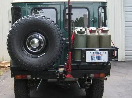

I am getting ready to build a rear bumper for my 1966 Toyota fj40. I have a few ideas in mind. I want it to hold a spare tire, a jack, and cooler/gas. I was wondering if anyone had any blueprints for their rear bumpers. I didnt want to just go for it without a plan. Am open to ideas of what I should do. I attached a picture of the idea I was going for.

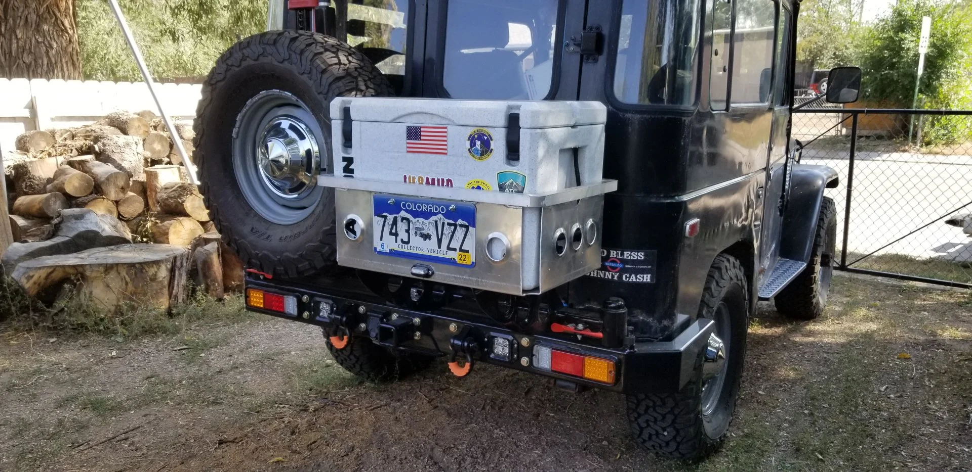

I am back into land cruisers after a 47 year hiatus. Since acquiring the ‘75 FJ40 I have now, I looked around hoping some of those old suppliers might still be around but not like it was in the 1970’s. However I had a tire carrier on the back of mine that was a swing away with the tire in the center and a 5 gallon jerry can on each side. Then I modded the rail on each side of the tire to to build a tubular frame to carry a 40qt cooler. It was a taller slender style so it did not stick out a lot with added overhang weight.
problem is for me, I started looking for a tire carrier that fit the entire back end and don’t see anything like it. When loaded, you had to lift it slightly to re-latch but not any issues with it
I agree and I thought the same thing. That is exactly what I was going for. But it's $2050 and I feel like I could build one for cheaper hence why I was asking if anyone had blueprints of their bumper.

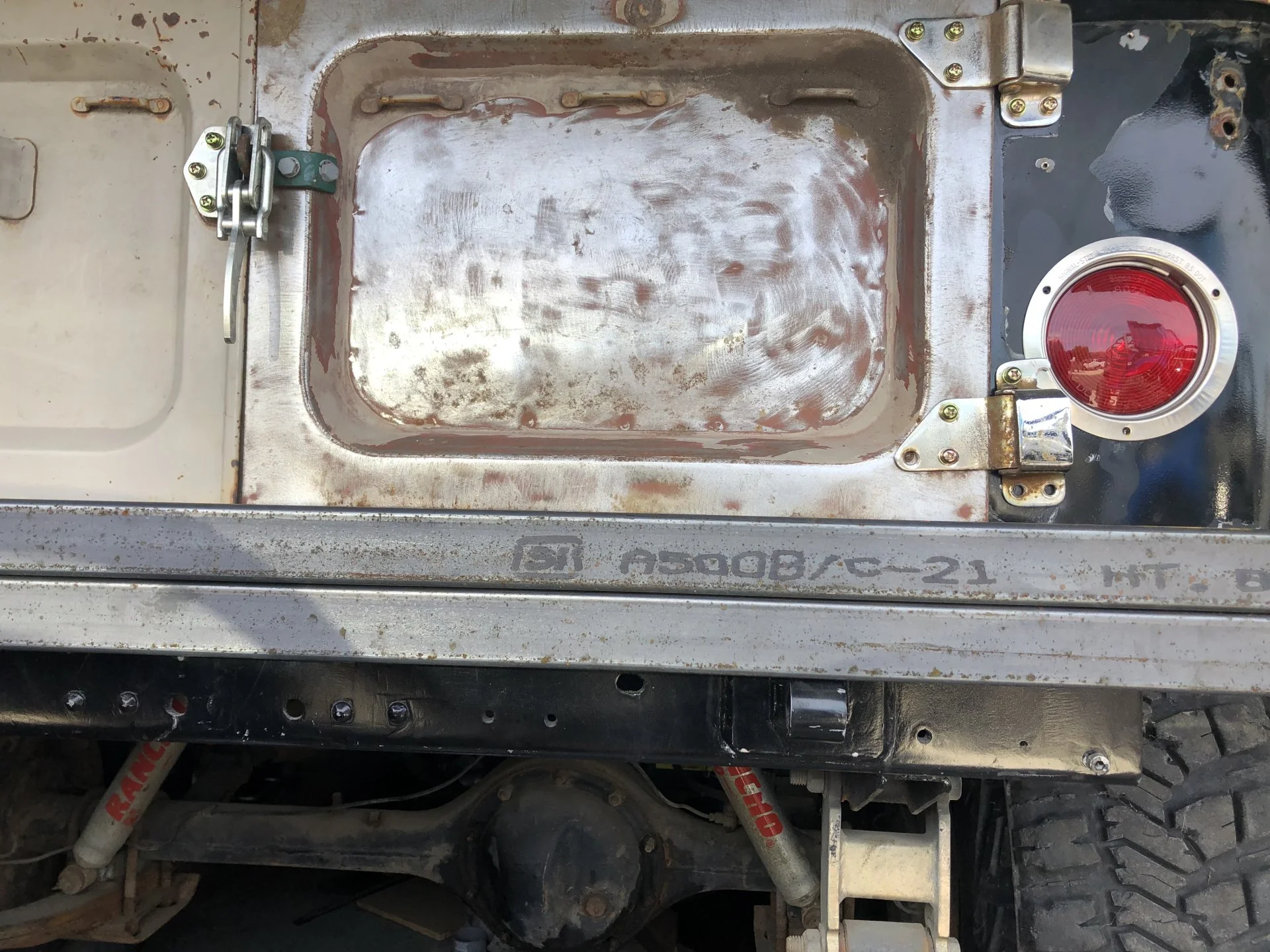

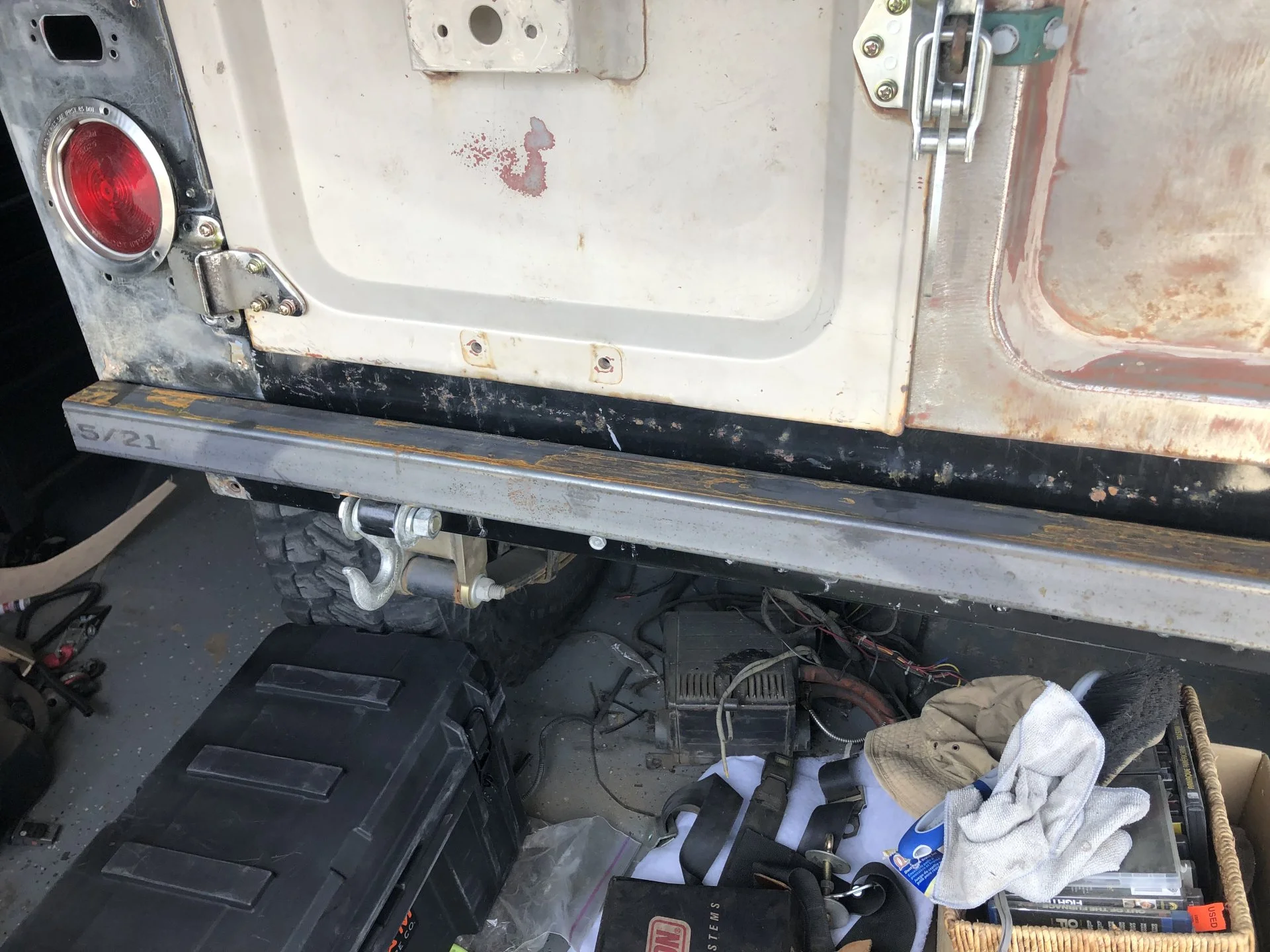

great way to put it. Also had a question of how yours in connected to frame/body?
Mine has 12, Class 10.9, 14mm bolts, through sleeved holes with the same strength nuts and split washers through the existing holes in the rear frame member.
