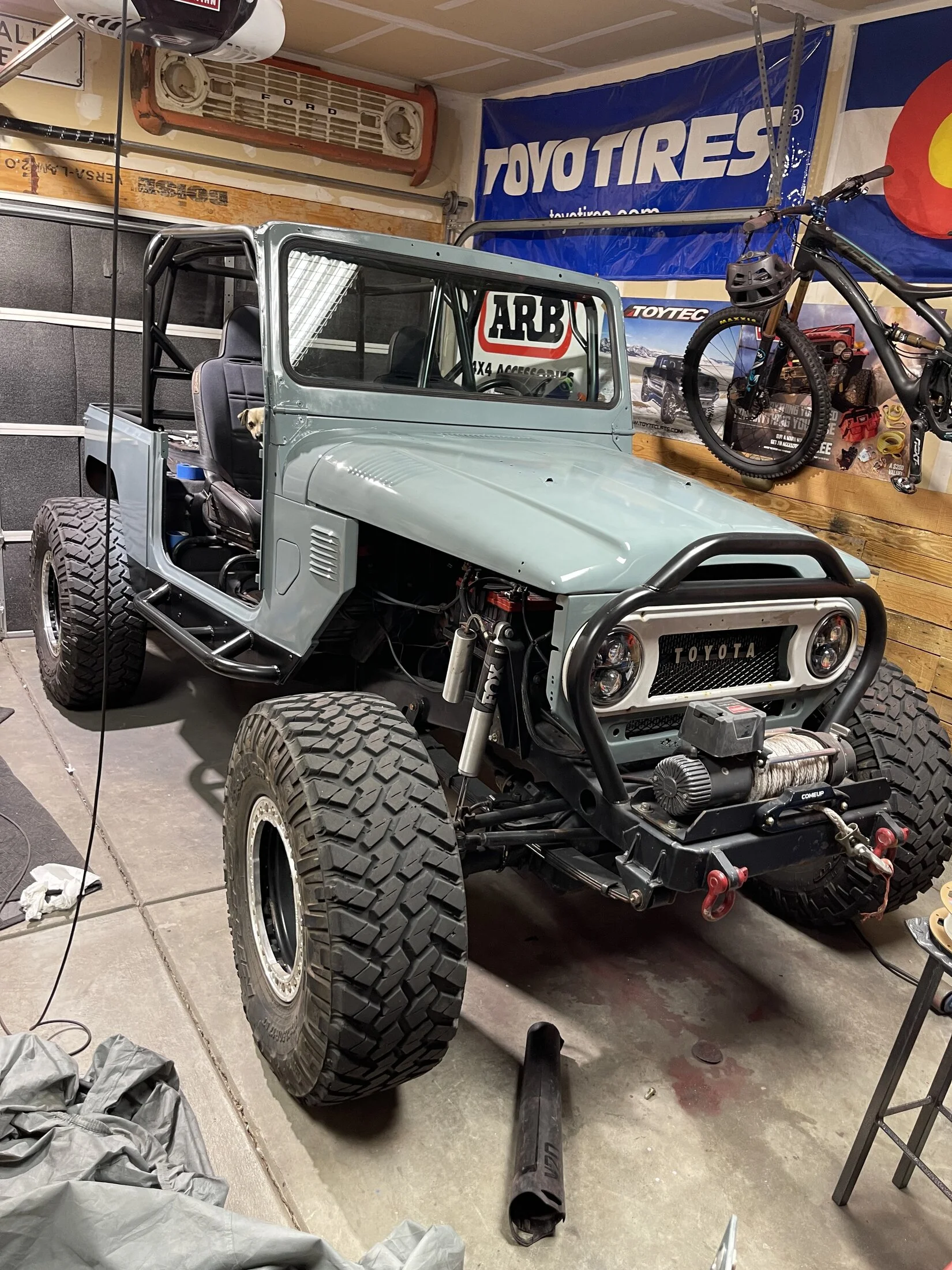

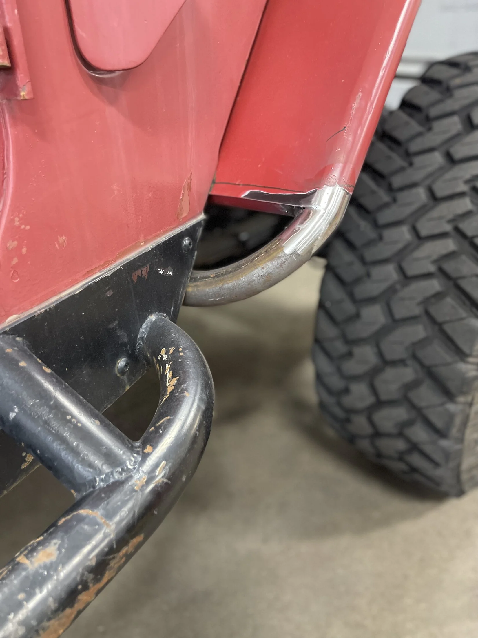

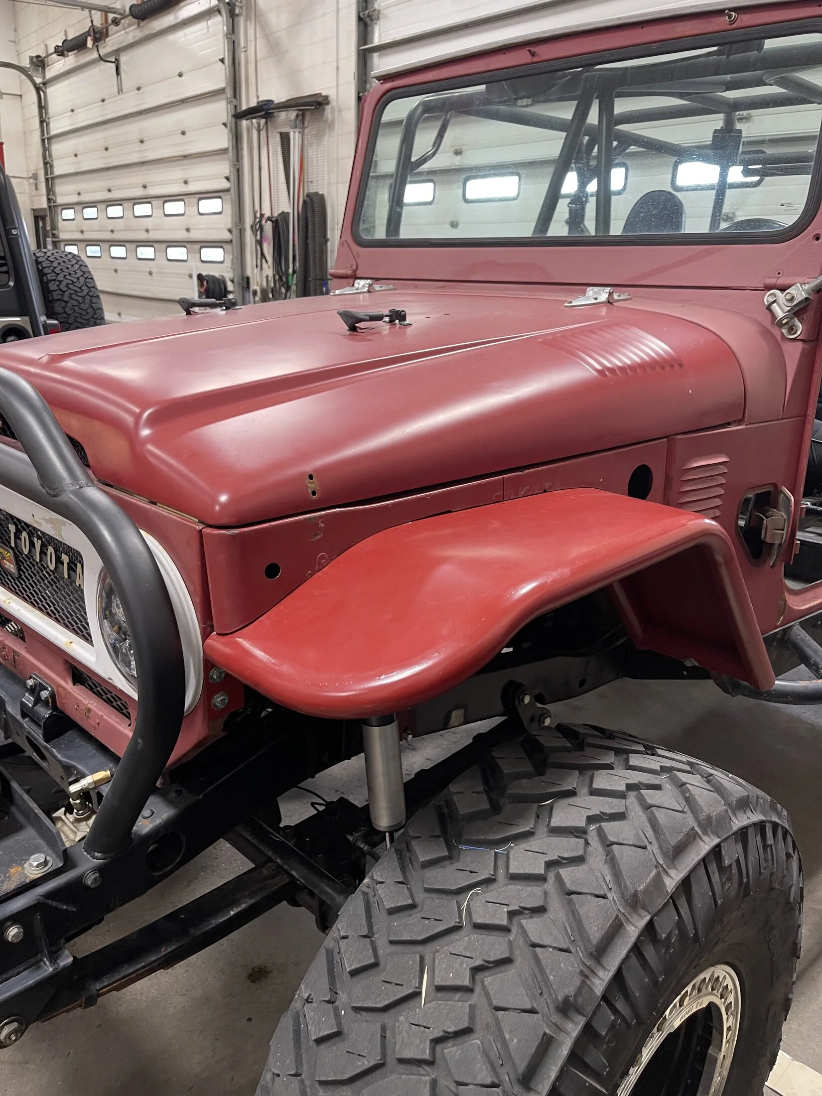

Didn’t love how my tube fenders ended so adding some tube, also I think I’ll finally cut the aprons.

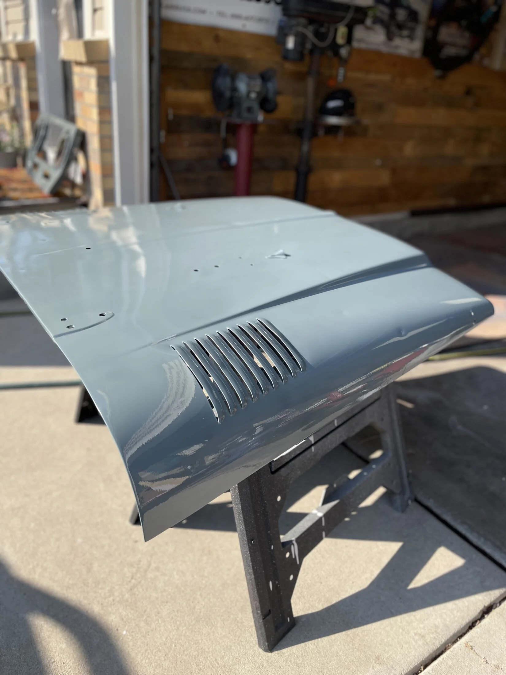

Looks great
Wow, I just talked to my paint guy at NAPA today and it turns out I can spend $870 on a gallon of paint that looks slightly better than that. Maybe.
Love that color.

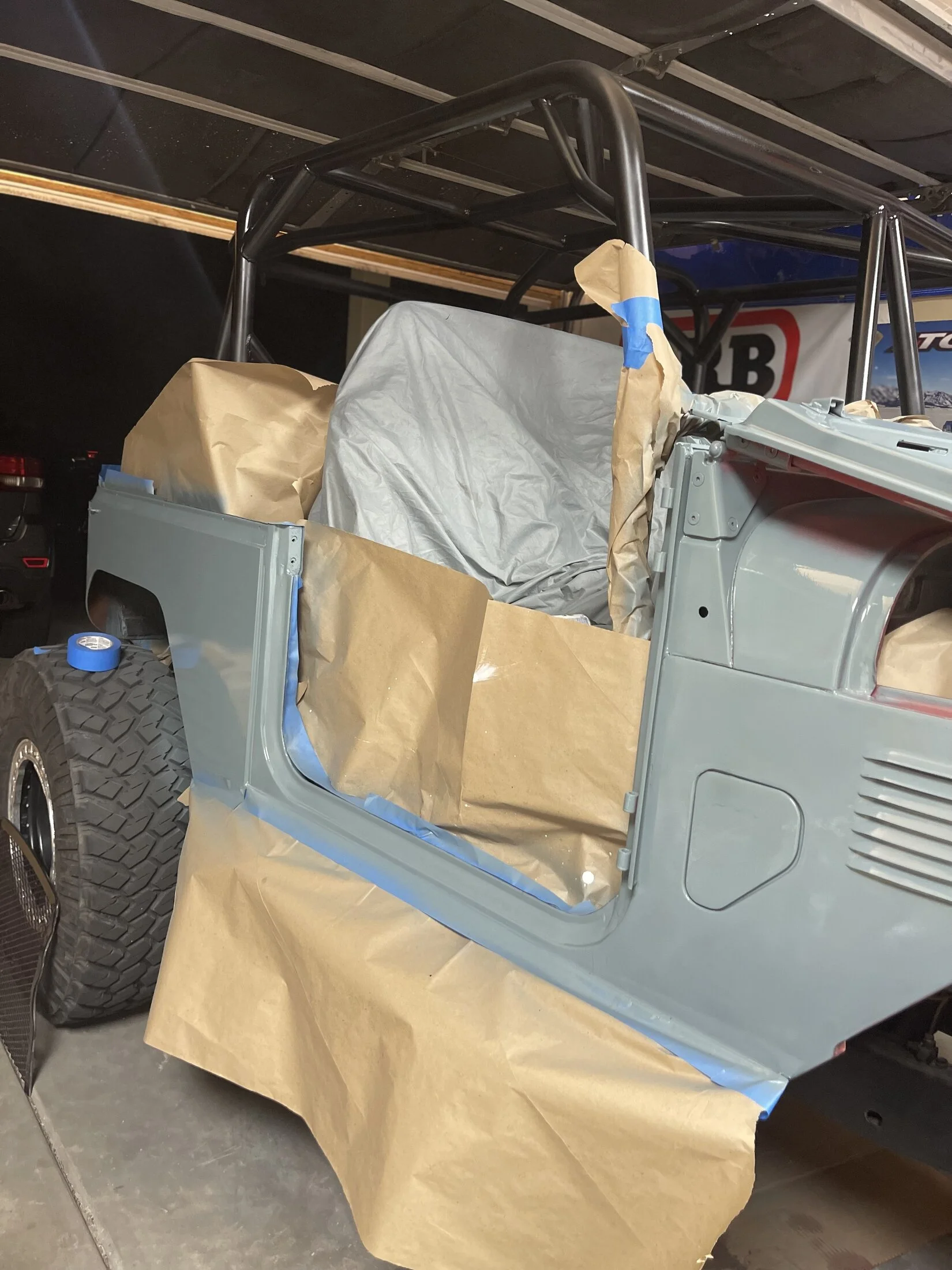

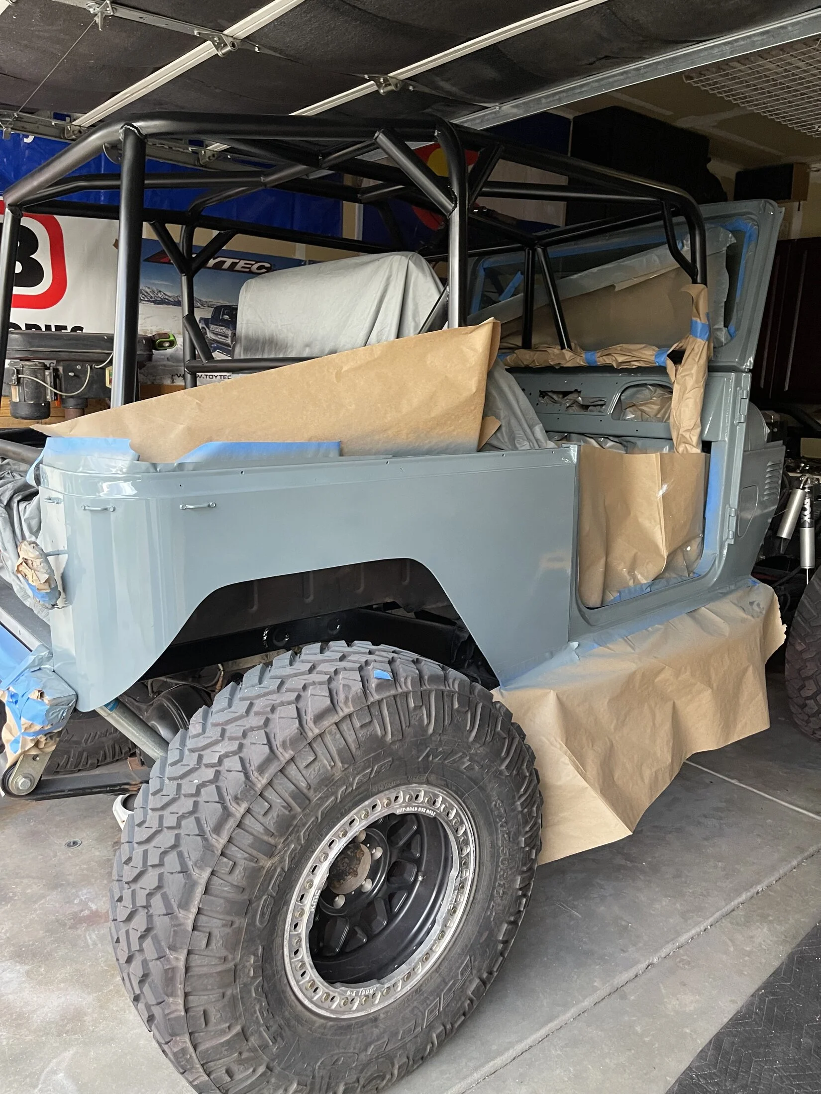

This definitely didn’t turn out perfect. I screwed up and didn’t let the paint fully cure before spraying clear and several places wrinkled up. I’ll have to fix them down the line. I keep trying to remind myself it’s a crawler and I’m probably going to screw it up anyways.
