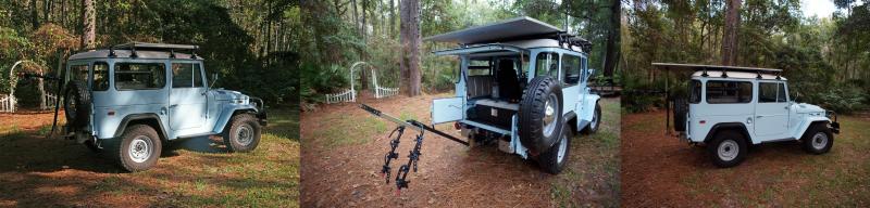

I liked the idea of the RTT but just couldn't bring myself to invest in something I wouldn't use very often. After giving it some thought, I figured I could use my Yakima racks, add a plywood platform and just attach my backpacking tent to that. Takes very little room inside the Cruiser to store the tent and my backpacking mattress and the platform folds in half and has little wind resistance. I figure the weight on top is no more than having two kayaks up there. Anyway, the cost was minimal and I was able to use my existing gear. Doesn't take much more time than pitching my tent to set up; maybe five minutes total. Anyway, it's something to consider. Here are the obligatory photos.

I have also gone the expedition trailer route to be able to use my 40 on longer trips and I absolutely love it. I have had it all over the Arizona strip and Utah/Nevada desert. I take my family with me in the 40, but the trailer carries all our gear so storage is not a problem. My trailer is a pop up so no RTT. I installed an aux. fuel tank to increase my range.
I have to say, your trailer is a work of art. I have admired it for a while. VERY tempted to build one for my 40. I actually found two tubs on CL a few weeks ago and almost bought them to make a trailer out of.
