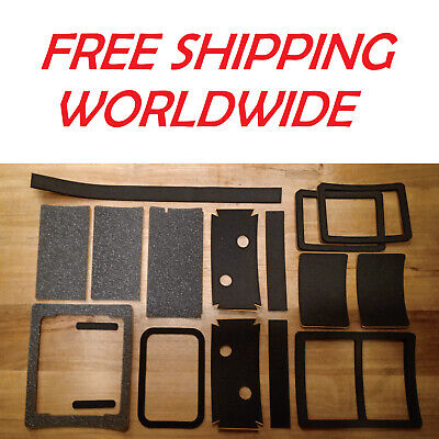

This is the blower off of my jan '72. It had some form of foam gasket. I can't seem to find these foam pieces or rubber gaskets on the microfiche set I got from a local Toyota dealer in the early eighties. The set shows a lot of body rubber and loads of other gaskets and such. Maybe one of the real old timers has access to additional info. I believe SOR carries some form of generic foam gasket refurbished kit for the blower and heater units.
That does look like a pricy complete kit..
OP if you can loosen the heater to make the gap bigger - it will be much easier to install a closed cell foam gasket, then slide the heater back over for that crush fit. I had an blue counterfeit Ensolite closed cell foam backpacking pad 1/2" thick that I made tons of spacer/dampers/vibration isolators for all kinds of stuff
