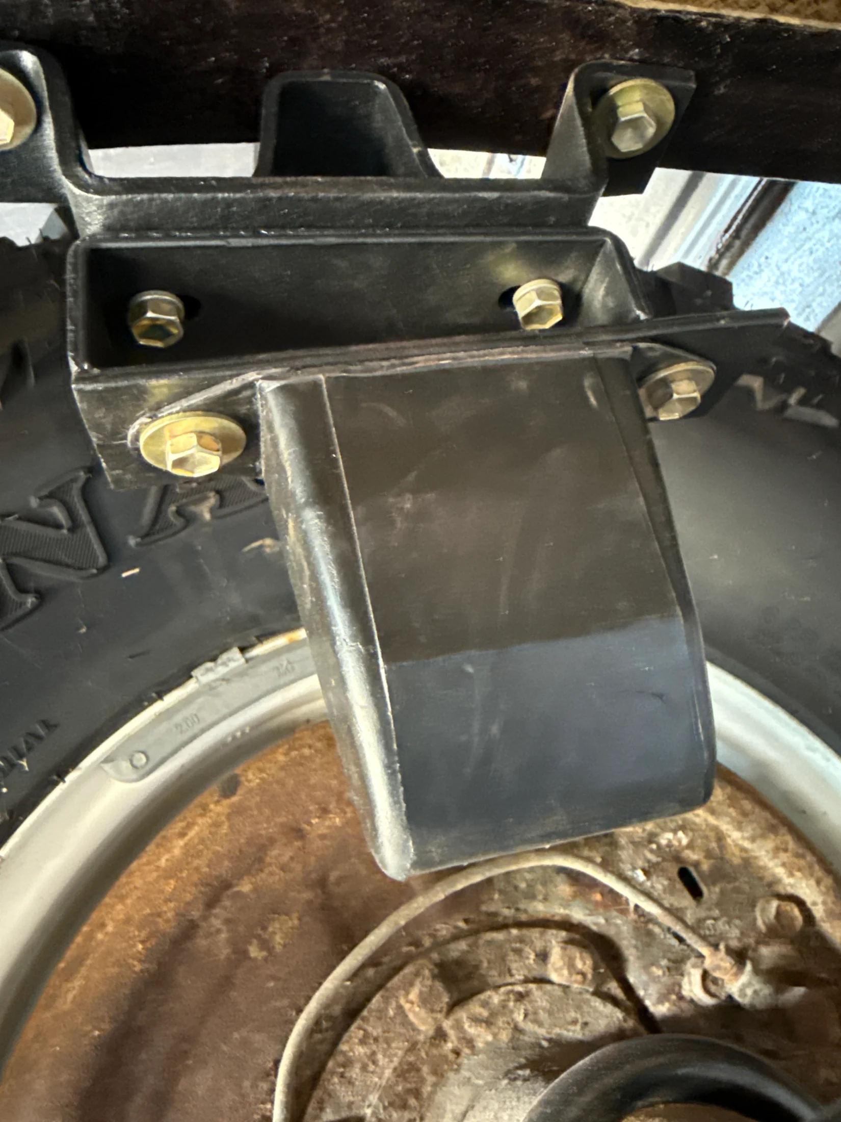

Not any more Todd. They have always been a slow-selling item, and I just can't deal with a 10yr ROI at this point in my life. It's too bad, bc I could use a few pairs myself. Fortunately I have some leftover end plates, so I will just build what I need.Putting on a 1.5 inch lift on the 40. Anyone make an extended set of bump stops?
Mark?? @65swb45
I believe your question has been covered in the 40 tech section. In a nutshell, you want the stop to hit the axle 1” before the tire hits the wheelwell, or the shock bottoms out, whichever comes first.This may be a question that's been answered before, but what's the distance from the axle to the bump stop on a STOCK FJ40?
Mine had some aftermarket springs on it when I bought it and have since been replaced with a 2.5" lift from Redline LC.
I'm good with building my own extensions, but I have no idea what dimensions to use for locating them from the axles.
I've searched and found lots of "bump stop" threads / comments, but not specifically the information I've been looking for.I believe your question has been covered in the 40 tech section. In a nutshell, you want the stop to hit the axle 1” before the tire hits the wheelwell, or the shock bottoms out, whichever comes first.
