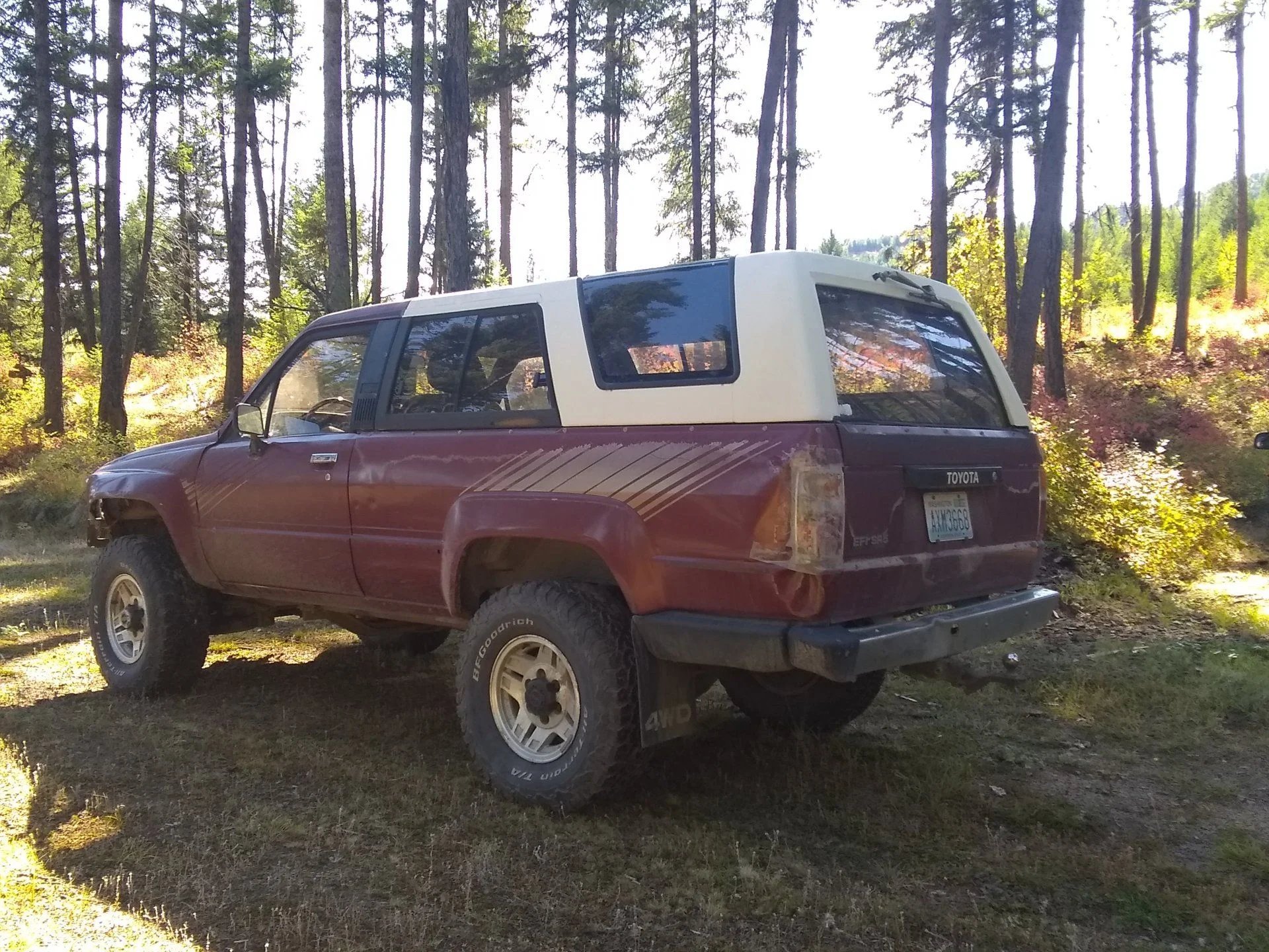

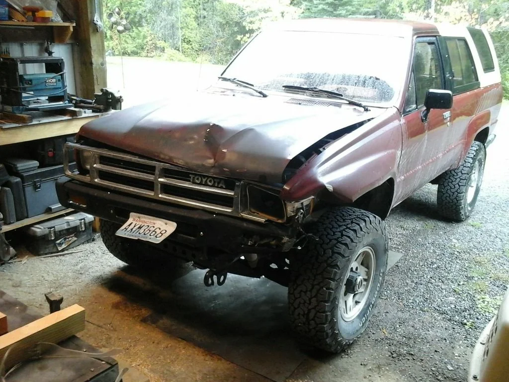

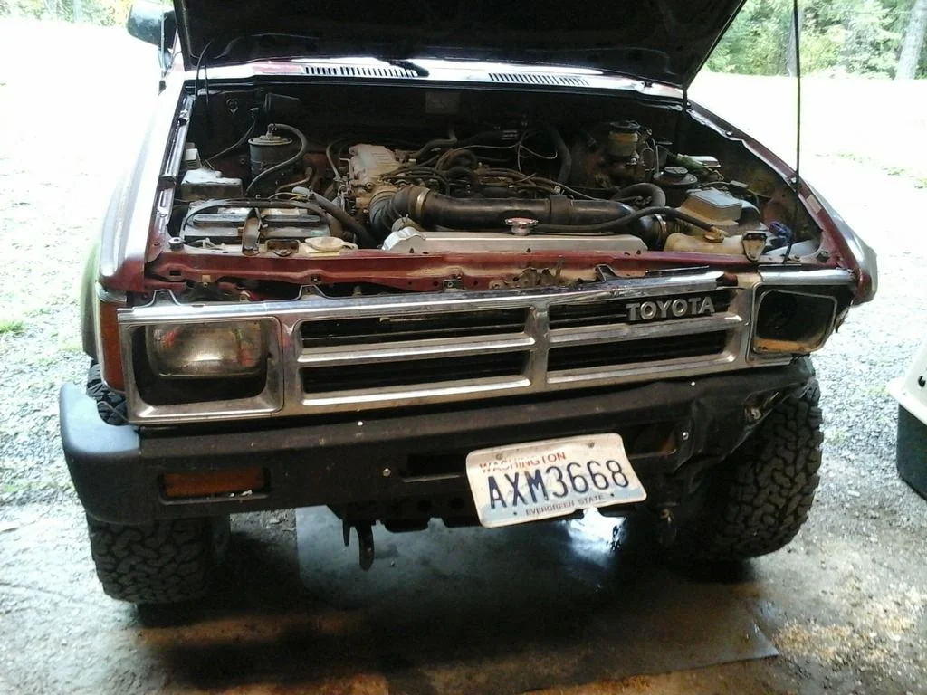

Here's some pics of the 87' 4runner. The first few are after I hit the deer, with the hood open you can see the drivers inner fender/wheel well is pushed up and crumpled, the core support was also pushed in and the new Koyo Aluminum radiator get twisted, but still holding up. I used a come-along to pull the the core support back out and a 3lb hammer to beat the hood out...dd it for a couple more years lol.

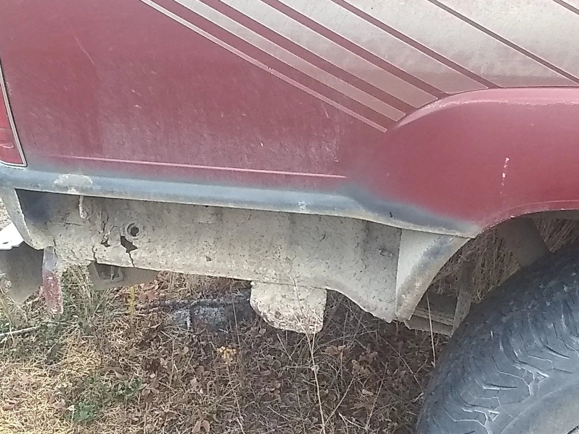

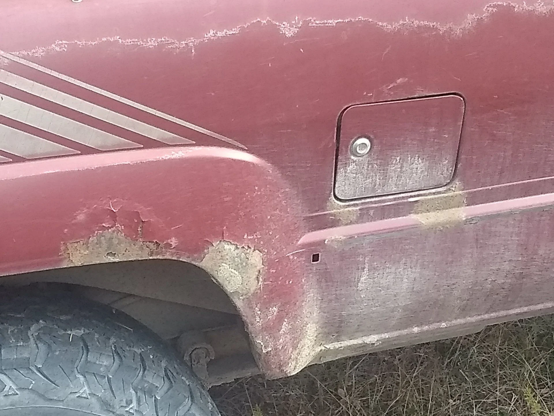

Passenger rear quarter has lots of rust, I cut some out behind the rear tire.

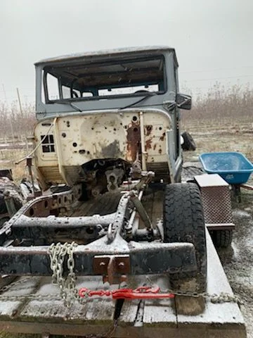

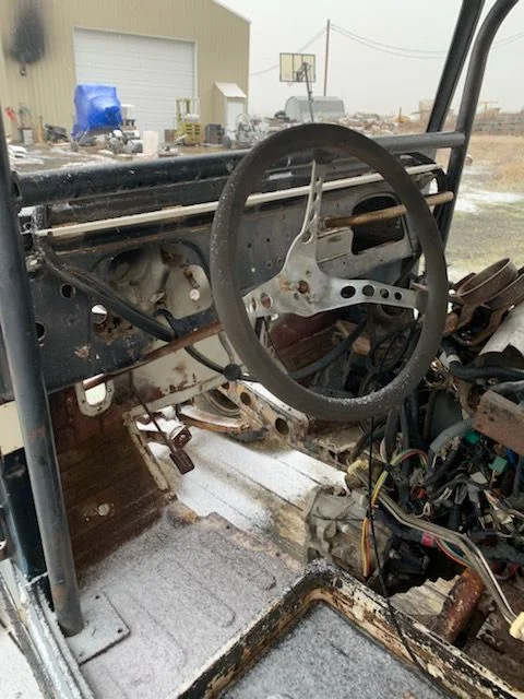

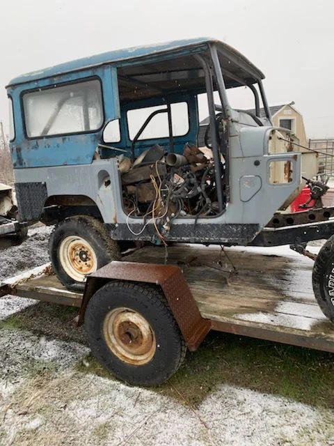

And here's my FJ40 parts rig. The top is pretty rusted out, the fiberglass cap is in good shape. I'd probably just go topless or bikini top for awhile until I gather the parts to do a full chopped down FJ45 hard top.
