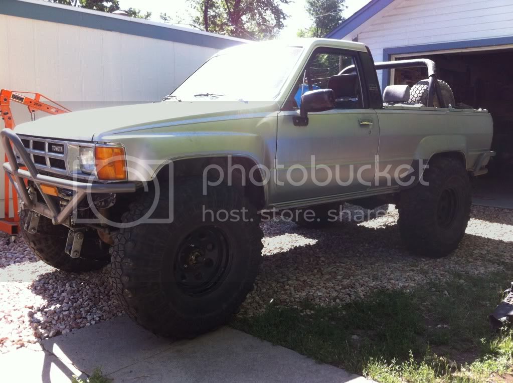

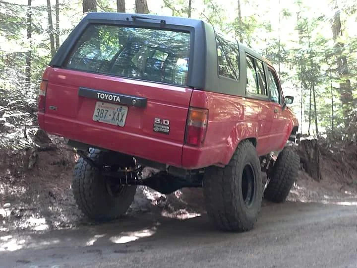

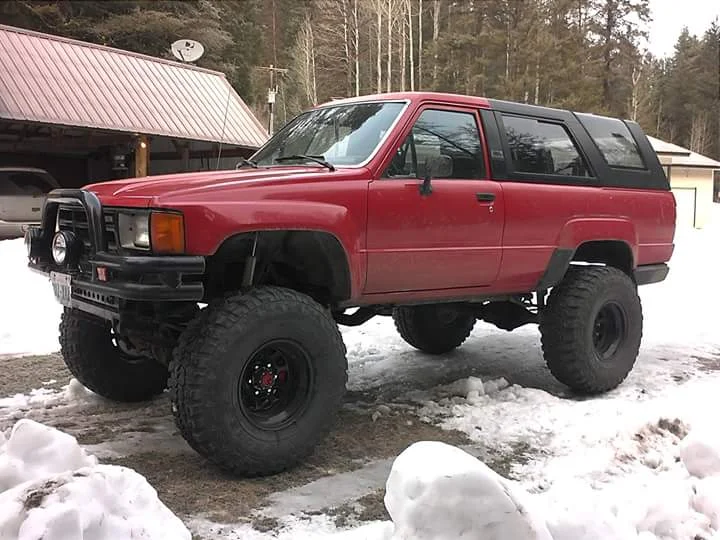

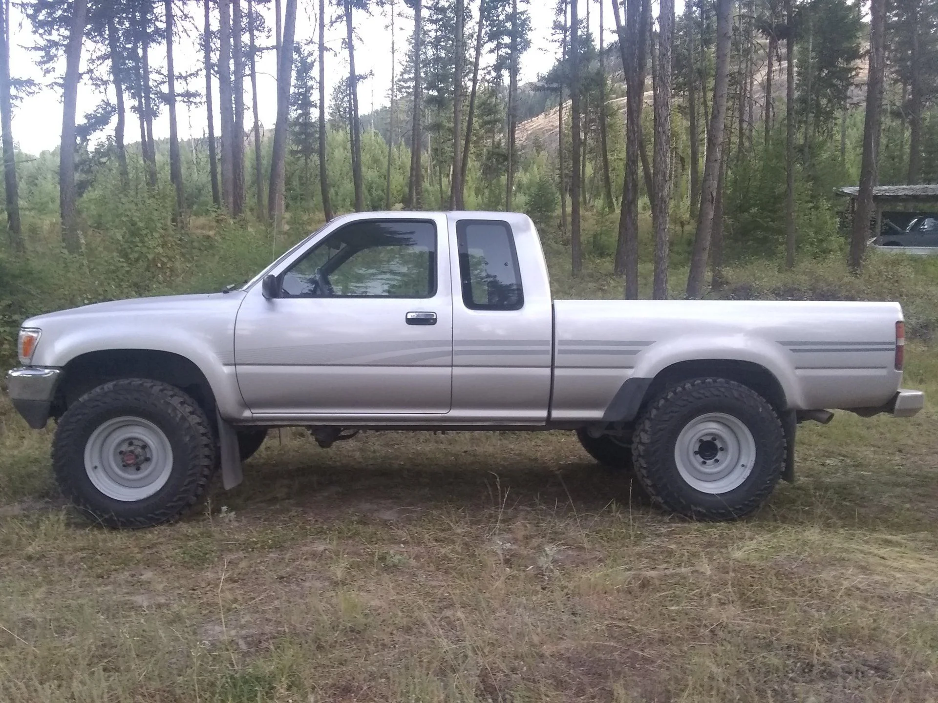

ntsqd, thanks for your incite, the front suspension is the part I'm trying to figure out. I sas'd my 86' 4runner and was happy with how it turned out, but it was high, and I don't want to go real high on this one. I like the tall skinny tire look, in fact I bought a set of 235/85R16 Yokahoma Geolander MT's for my 71'FJ40 project and have been running them temporarily on my 91' Toyota pickup (22RE/5spd) until I can get a new set of 31's for it. I love the looks but I knew that they would be a little tall for the stock 4:10 gearing especially when climbing steep grades like I do on the way to work...it's in 3rd gear alot and I never use 5th lol.
Here's a pic of my 91' with the tires mentioned above, and one of my old 86' runner with SAS and I did a Ford 302 V8 swap on it.

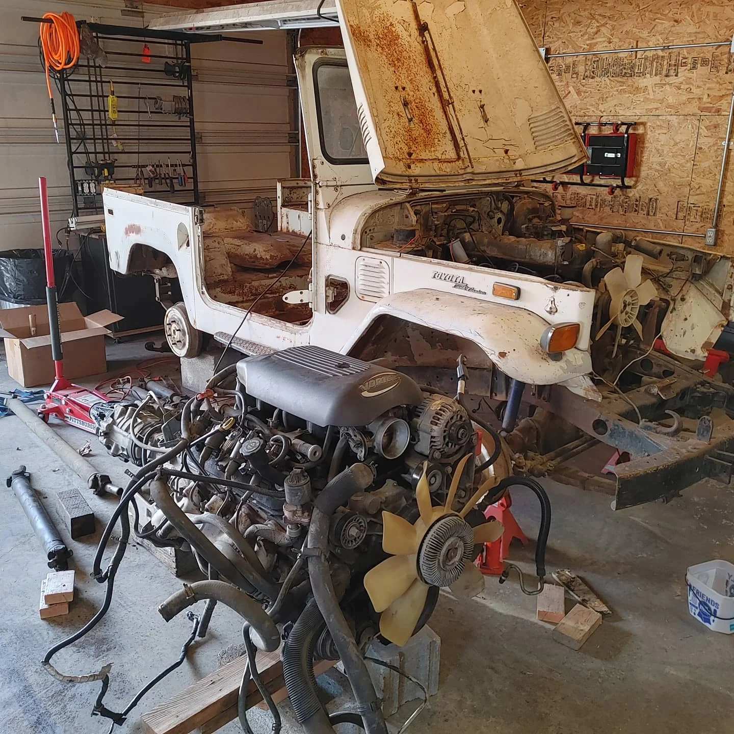

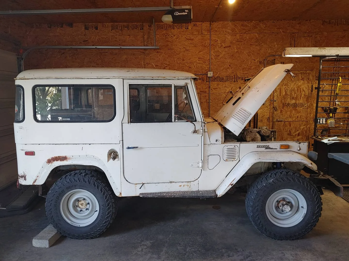

No real updates. My 91' toyota pickup that is pictured somewhere in this thread ended up blowing a head gasket and end up having a cracked head. I was low on funds and couldnt afford a head at the time, so ended up just pulling the 22re out of the 4runner and swapping it into my 91' pickup and then I sold what was left of the 4runner. I still have my 71' Fj40 and the parts rig. The 71' ended up having alot more rust than I originally thought. My plan now is to use my spare FJ40 frame to lengthen the other one and make a FJ45-ish pickup. I have a vortec 5.3 and 4L60E trans out of a 2002 silverado that I want to use ...I hope to start on it in the next month or so if life will quit getting in my way, lol!
