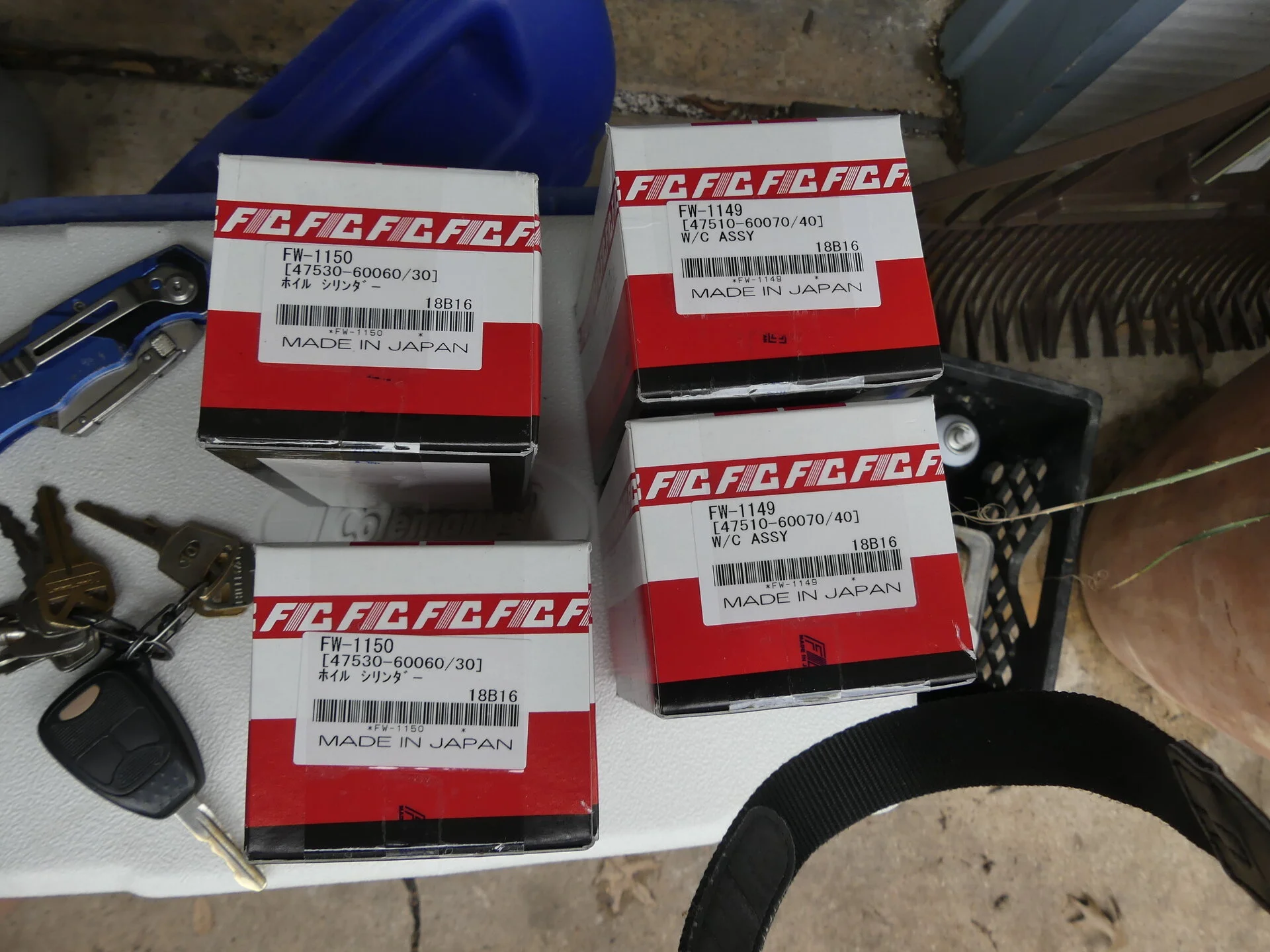

Yesterday I replaced my front drum cylinders on my ‘71 FJ40. I used FC cylinders. Photo included. I can’t get pedal pressure on my brakes! It’s kicking my ass. I adjusted the drums to the point where the wheels wouldn’t turn and then backed off 3 clicks. I put Teflon tape on all 8 bleeder valves. I have a reservoir for the rear brakes and a reservoir for the front brakes. I started at the back passenger side, then went to the rear driver’s side. Then I moved to the front passenger side and finished with the front driver’s side.

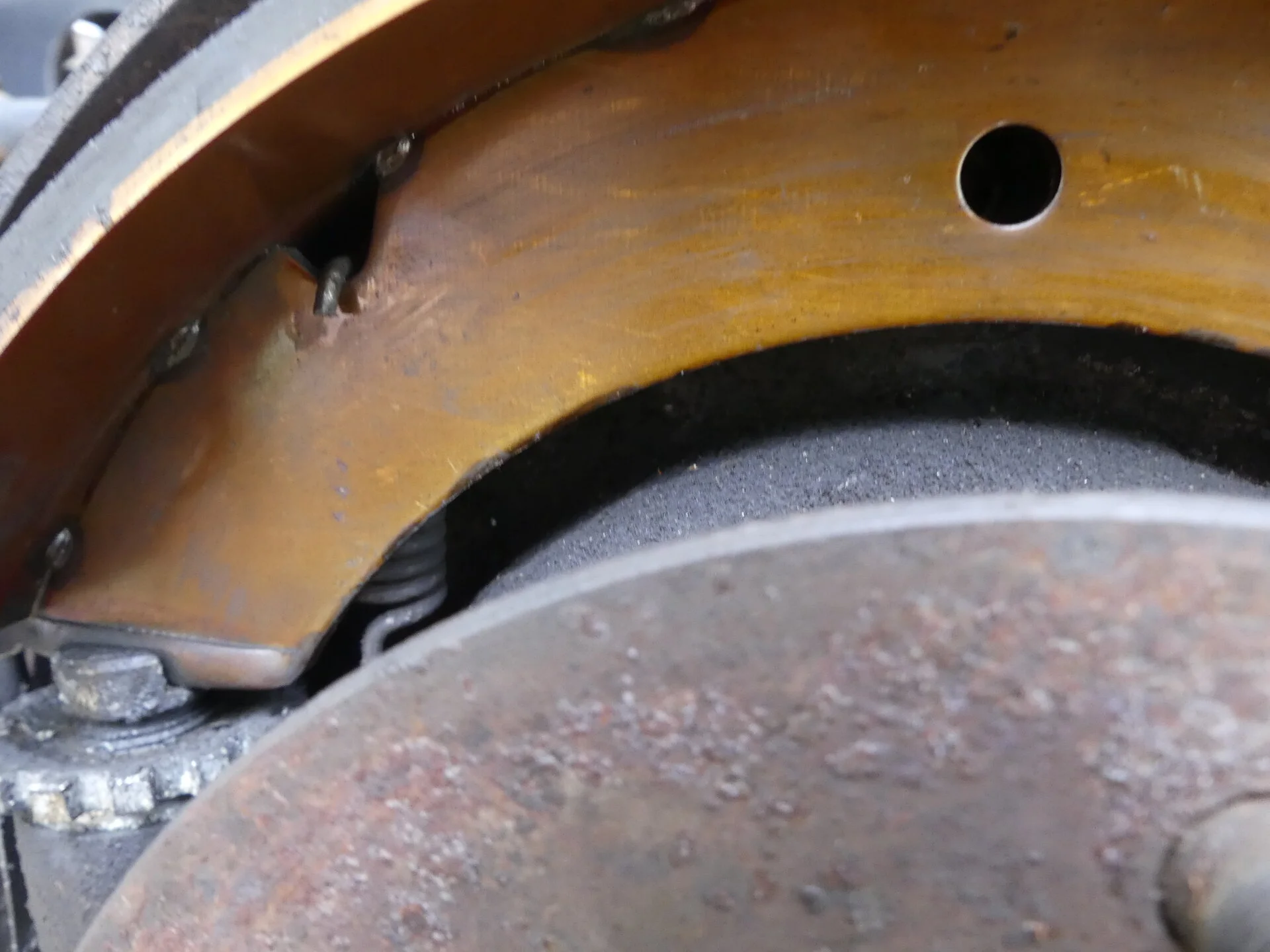

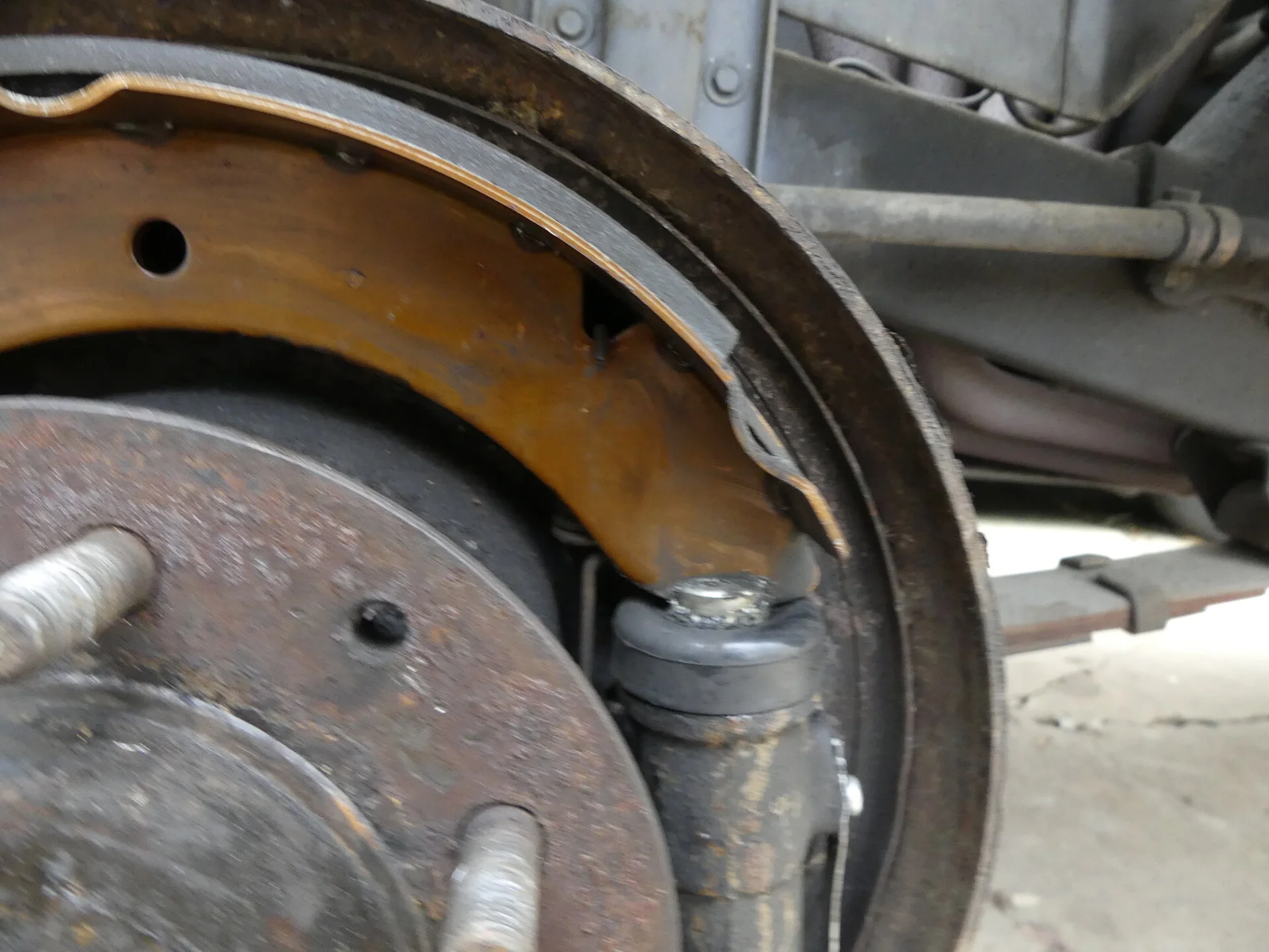

Also…… does anyone have a guess on what brand drum shoes these are just by looking? I haven’t seen a part number. Thanks y’all
