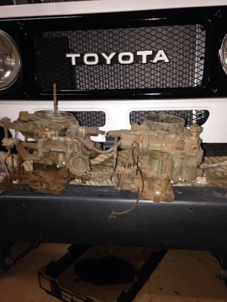

What year FJ40 is that. Being an Australian carb its going to be a bit different compared to the US models as I am finding out, mostly in things attached or not attached to the body. As one of the guys asked what are the production/date numbers on the face above the site gauge?
Is it a FJ40RP-KQ number on the restoration? What is the engine plate number? Some PN were 21100-61122 or 21100-61012 (40/45). Hard to say from the picture on if it is a stock carb for that engine.
I am with a carb from OZ that I am trying to identify for a kit and it looks identical to what you have in most parts. If you ID your carb and rebuild it would you post the kit number you used. Good luck.
My parts search shows the 60 series for 82 in OZ also had the same carb as the 45 for the same year. Some areas in Australia as in NSW were different in the 80s with the emission items for the FJs compared to Victoria. In the states in the 1980s they loaded them up with hoses and apparatuses to were you could not see the ground from the top. If it is a match it would be worth the time to rebuild that one. Can check the others for the dates also.
First priority is to get this car over the pits and registered so if I can do that without a carby rebuild in my immediate future, I will.
I do also have the original carby as well, not pictured, which is the same as the one on the motor. I might buy a big bag of baking soda and a rebuild kit and take my time with rebuilding it.
I'll post some numbers for you guys later.

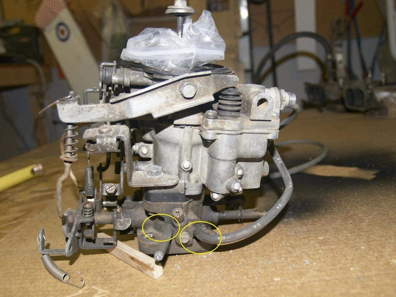

search for the date codes thread. Jim C cyphered the code for us bt I can't recal the key...
Yes, the 61123 is an 81-84 ROW carb. It is equipped with the factory AC idle up linkage, so probably from an FJ60 w/ OEM AC.
The cylinderhead is a 61010, which I though ended in 1980. I thought an 81-later engine would be a 61050/60 cylinder head? Not positive on ROW applications though.
Luv2fly, your pic is also a ROW 81-84 carb.
So my carb is a 61123 ROW? What does ROW mean and are rebuild kits easy enough to come by?
View attachment 944752 View attachment 944751 What year FJ40 is that. Being an Australian carb its going to be a bit different compared to the US models as I am finding out, mostly in things attached or not attached to the body. As one of the guys asked what are the production/date numbers on the face above the site gauge?
Based only on the vac lines at the base-I would hazard a guess this is from a 60 series truck--I had one very similar and it was from an 82 FJ60

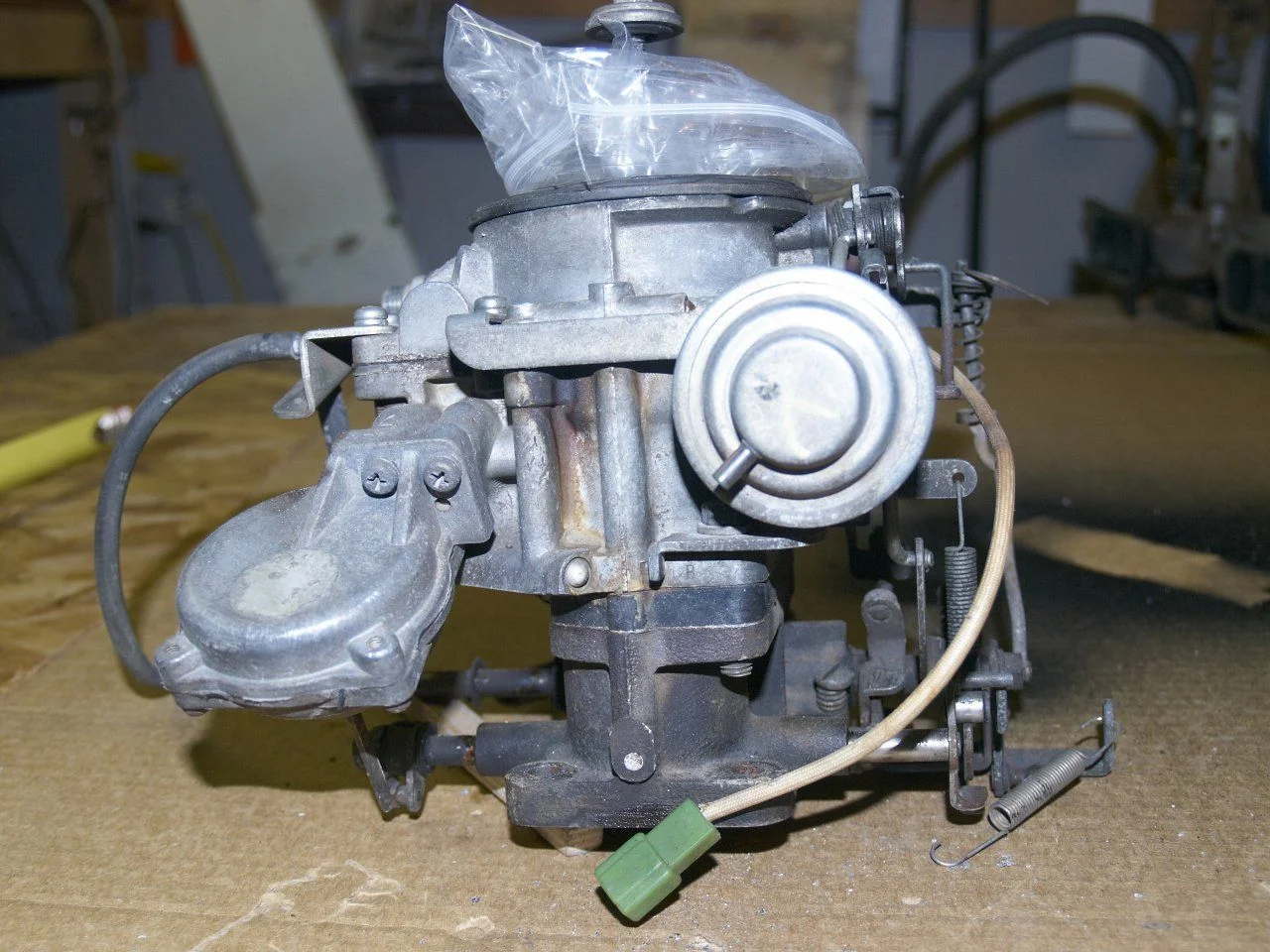

In this pic, the left carb is 75-77 ROW 2F. Right carb is 73-74 ROW F engine.

I thought the 75-77s had the AAP installed- was his only for Ca. trucks?
Thanks, didn't know that.
