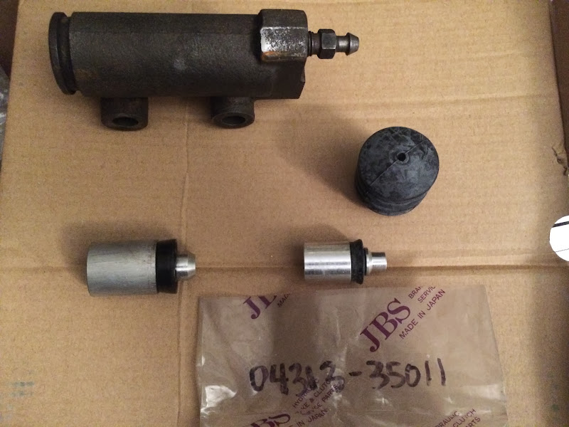

As it turns out, the previous owner "fixed" the slave cylinder with electrical tape which my lose it's sealing properties somewhere above -5°F.
I got the rebuild kit from Cruiser Outfitters and the piston is clearly for a different slave cylinder. I wonder if my slave cylinder is original or not since this rig is so old but otherwise unmodified. The bore of the cylinder is totally smooth with no pitting or scoring and the piston looks good, too. My boot was destroyed but I think that's all I need. I think the blow out may have been water in the hydraulic line that froze and expanded.
Can any of you experts out there tell me if this slave cylinder looks like a '65? Would a later model slave cylinder that is more readily available bolt in place?

Sorry to hear that isn't the right kit. I'm out of the office through Monday (Bryce and the boys are there) but I did confirm the 04313-35011 is the correct kit for E-66 model. So either the kit is mis-labeled or your slave is a different year? Can you measure the bore diameter of your cylinder? Should be easy for us to correct once we know what you have in there.
You're awesome, Kurt! The bore on my slave is 7/8" and the piston in the kit is 11/16". I'll give Bryce a call and see what we can figure out.
