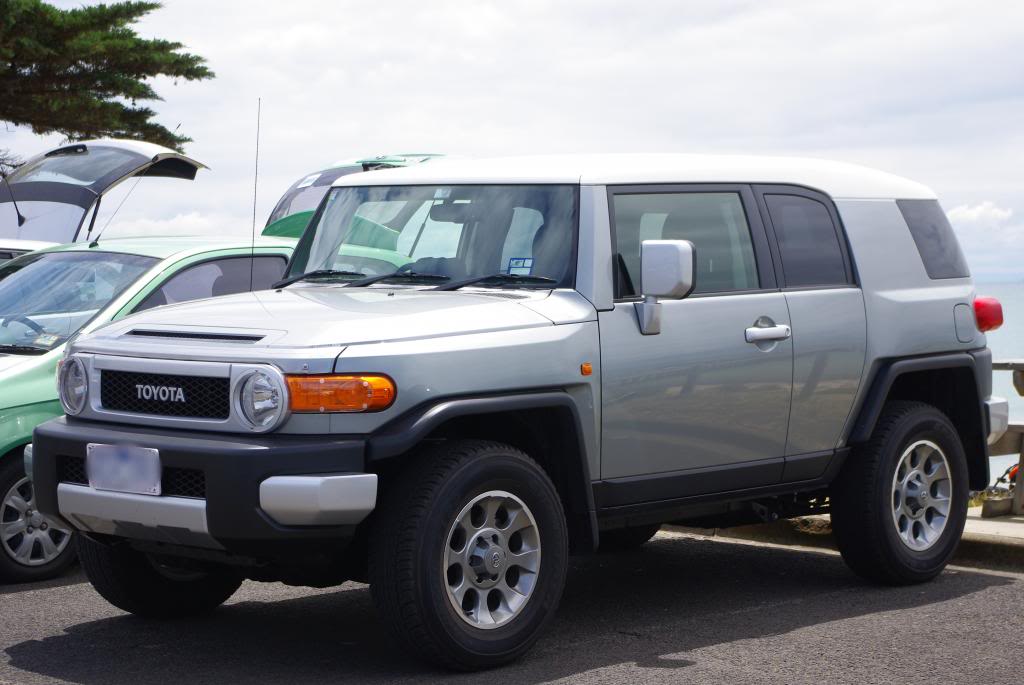

Hi All,
Been a couple of years since I sold my 40, I need a break from the addiction.
Today I ordered my FJ Cruiser, just awaiting a deliver date.
For the moment all stock, IT WILL STAY STOCK :steer:
Pics Soon.
Regards Matt
OH I almost forgot, what are the best suspension mods?
