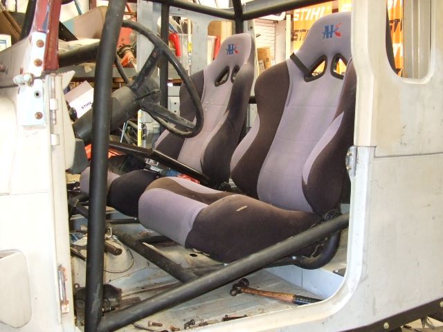

I also installed the seats.

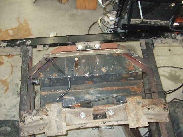

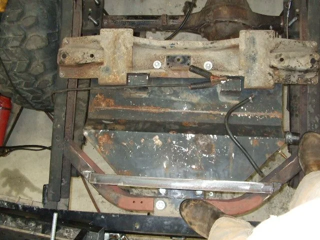

Con Fer FJ40 Long Range tank installed. Please remember that this is an FJ 60 frame.
It took three mudship connections to get it from Tahoe.
THANKS GUYS!
I flipped the spare tire carrier/frame brace over and notched it. I welded up a bracket to hold the rear of the tank down. I used the standard FJ40 Con Fer Long range tank straps.

The final version of the tank mount was the results of trial and error
but worked out great.
