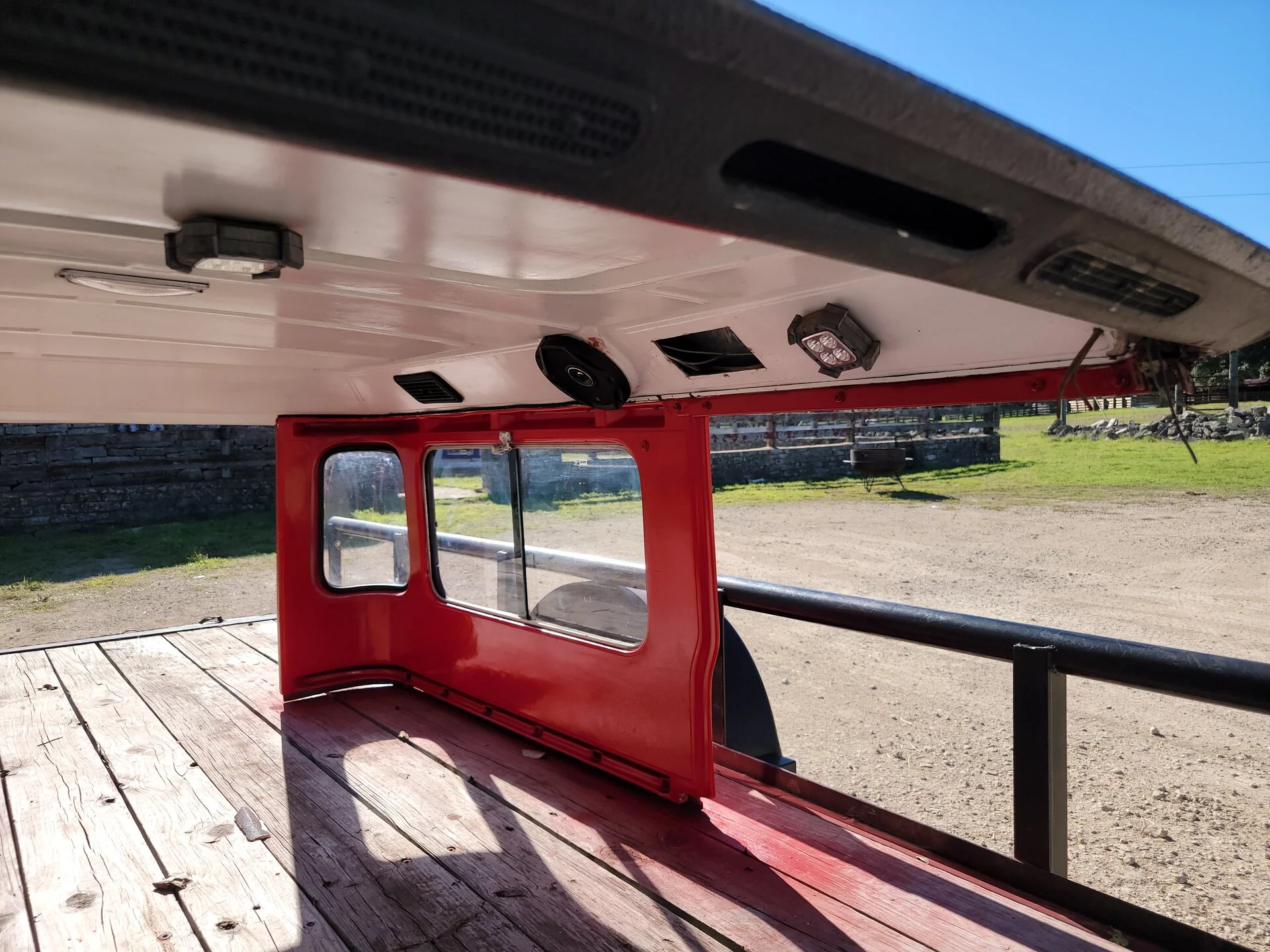

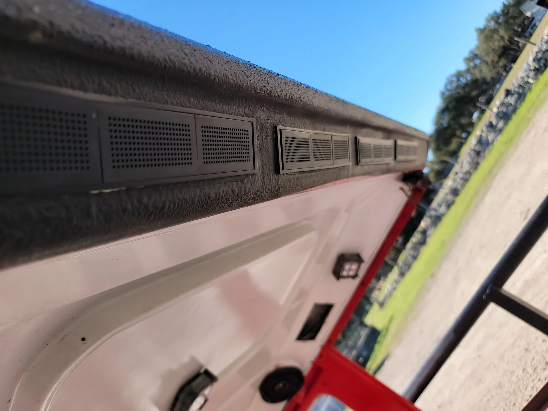

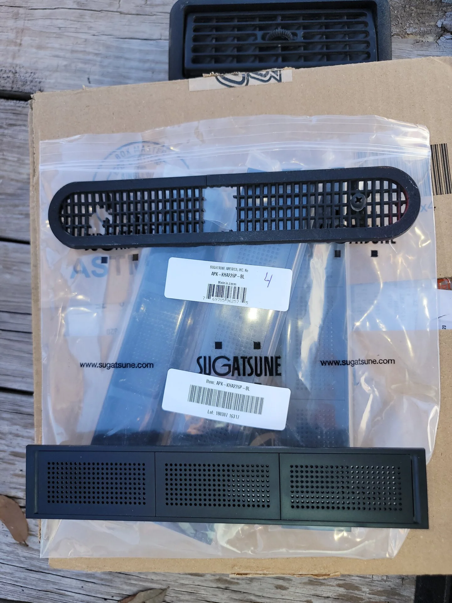

Storm Ranch Joined Apr 22, 2018 Threads 21 Messages 60 Location Austin, TX Nov 24, 2023 #1 Couldn't find replacement vents for top so with very minor cutting using multi tool, installed these. Only had to cut 1/8" off top and bottom of hole opening. Last edited: Nov 24, 2023
devo SILVER Star 10 Year 15 Year 20 Year OG Joined Nov 3, 2002 Threads 363 Messages 3,534 Location NoCo Nov 25, 2023 #2 Great work. I have always thought that eventually replacement vents will be needed. Any chance you looked into vents with open and close louvres?
Storm Ranch Joined Apr 22, 2018 Threads 21 Messages 60 Location Austin, TX Nov 27, 2023 Thread starter #3 devo said: Great work. I have always thought that eventually replacement vents will be needed. Any chance you looked into vents with open and close louvres? Click to expand... Couldn't find any that would suffice.
