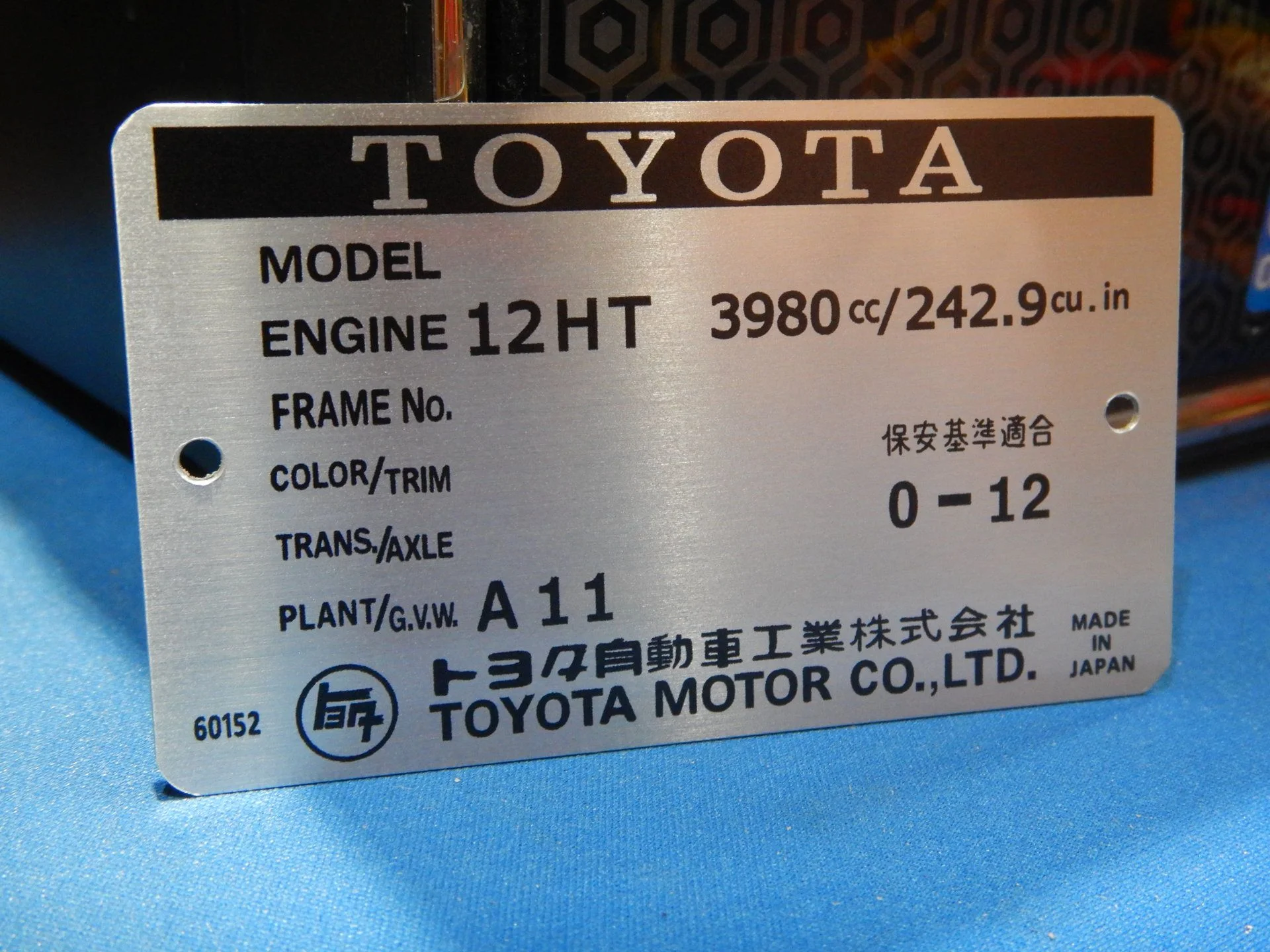

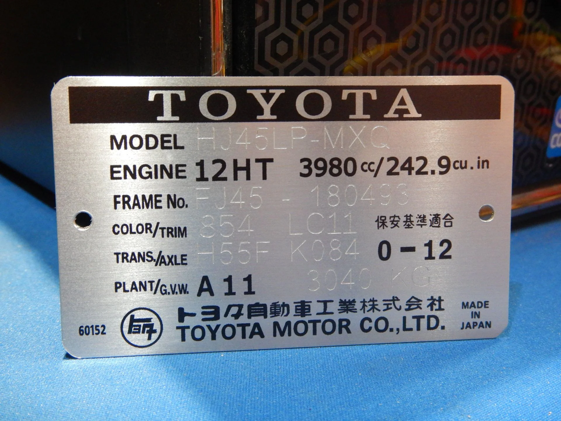

First you will need one of these ..........

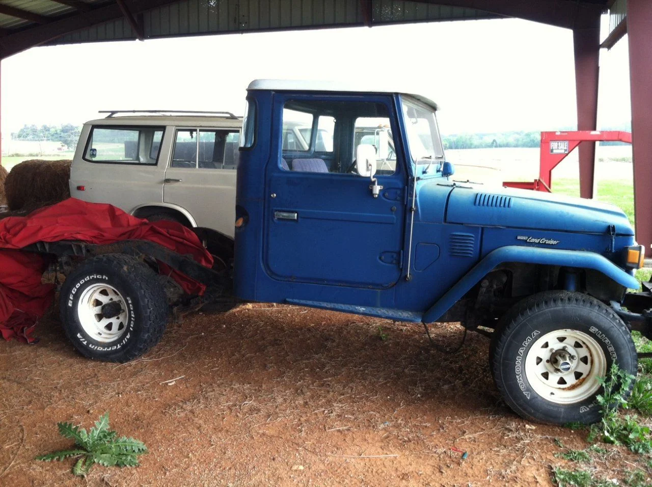

Check out my build thread in the 45 clubhouse. I installed a 12HT into my 45.
How do I find it? What is the clubhouse? Thanks/sorry.
This is the one. Absolutely top build
