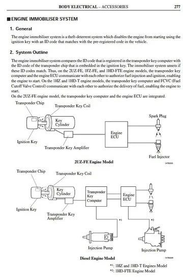

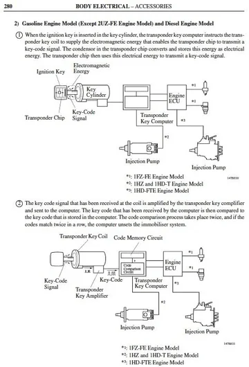

According to this handy attached info sheet "100 series Transponder Key Diagram", on the V8 gas engine the transponder is part of the engine ECU, so it sounds like unfortunately we can't take the immobilizer offline here in the U.S. These diagrams are useful. If someone has a workaround for the petrol engine, please share!
Screen shot 2014-12-23 at 7.36.36 PM.webp Screen shot 2014-12-23 at 7.36.50 PM.webp Screen shot 2014-12-23 at 7.37.01 PM.webp Screen shot 2014-12-23 at 7.37.11 PM.webp Screen shot 2014-12-23 at 7.37.31 PM.webp
