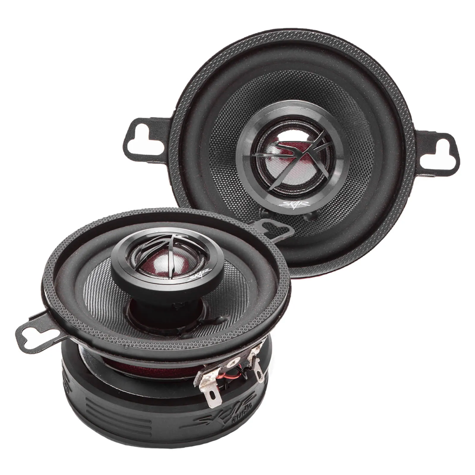

Has anyone replaced the “absolutely precious and cute” little useless speakers in the rear headliner? Any advice?
This is the only source I found that even lists anything:
These supposedly fit, but I am highly suspicious
I’m currently researching/working on these 2 speakers right. Did you try these out?
