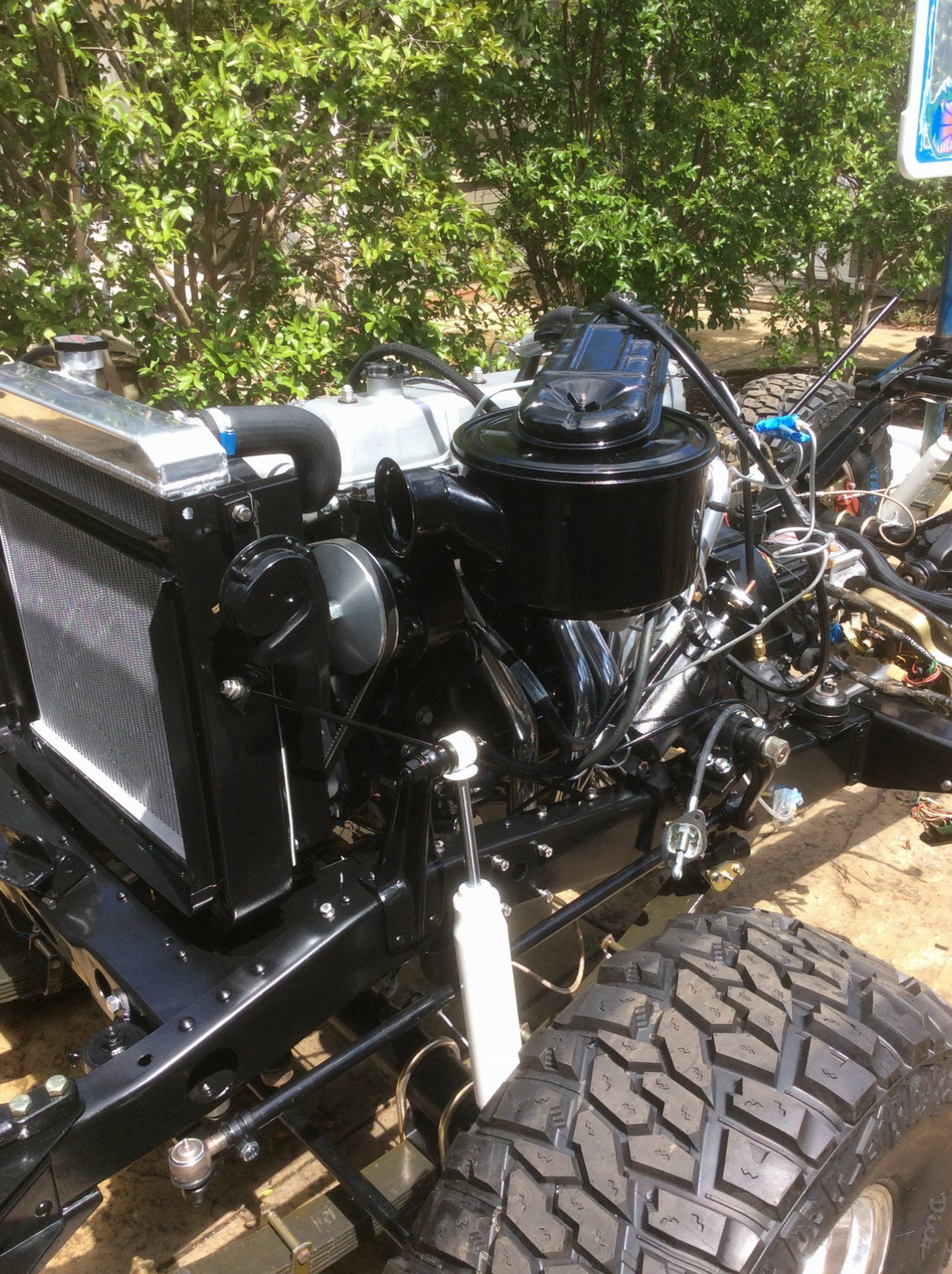

I have a 1/73 fj40 F engine that has been desmogged and rebuilt also has a New Troll hole carb. I am planning on starting up rebuilt engine this weekend. The engine is mounted on chassis without any of the wiring harness.
1. Do I have to hook up idle solinoid for start ? If so how do I do that without wiring harness?
2. What is the oil pressure range I should be looking for with breaking oil SAE 30?
3. Should I put a bit of oil in each cylinder befor start up!
4. What rpm should I run for break in and how long?
If anyone has any more input on this please advise

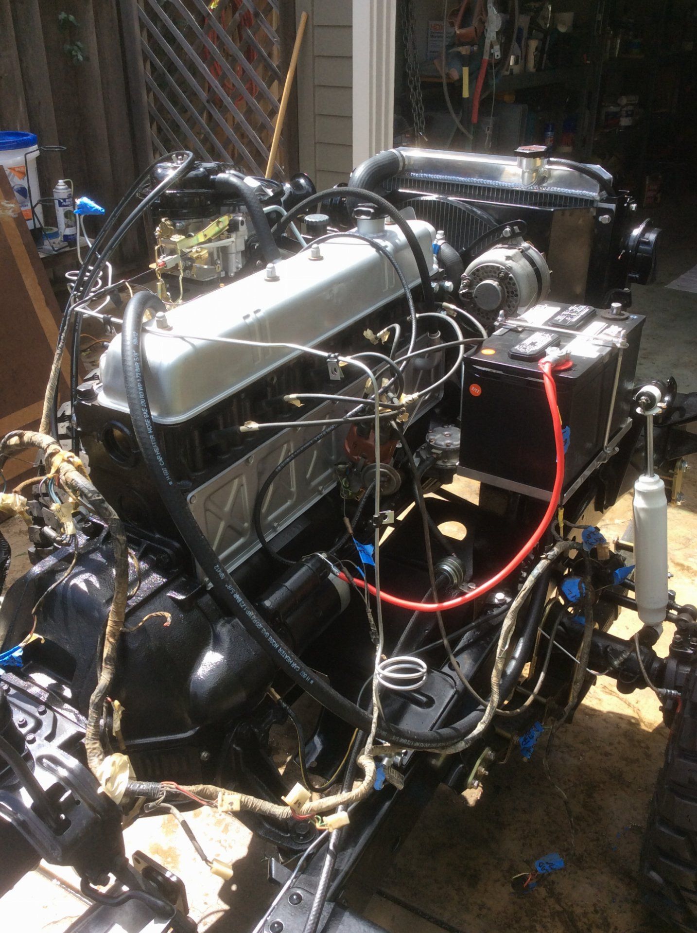

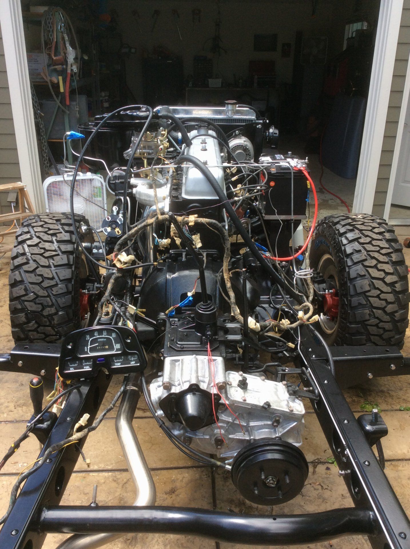

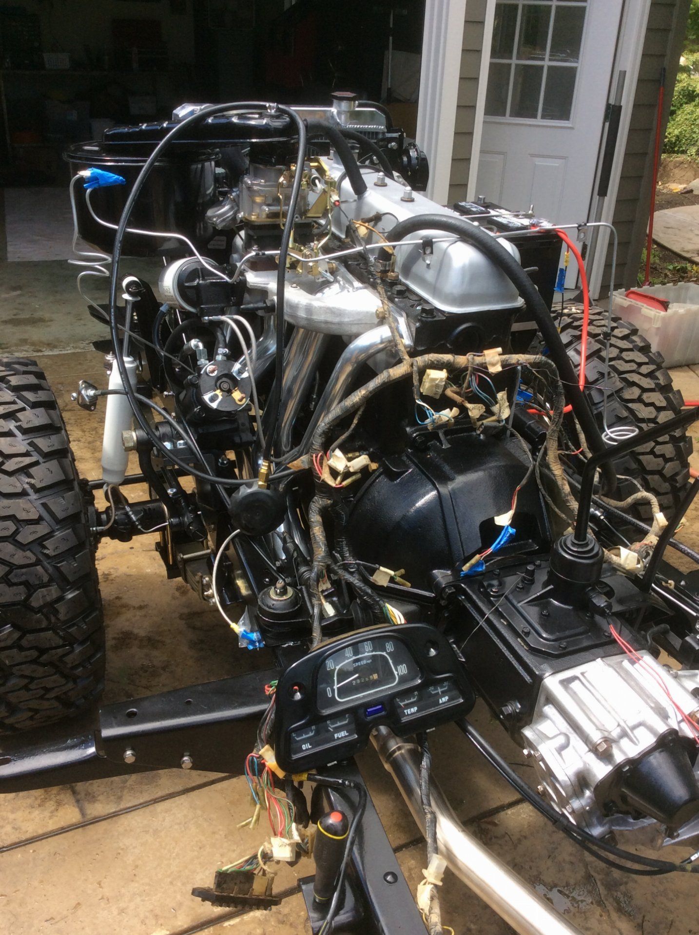

Thanks for everyone's help on guiding me in the right direction with my first start up on my rebuild. I kind of Jerry rigged my harness so I could use the ignition switch. It worked out perfect. Just had to make sure I didn't short anything out. primed oil pump and then set dizzy in place with flywheel bb lined up on pointer making sure dizzy was completely down . I then primed carb with a little gas and she fired right up!! I was stoked. Oil pressure came up to 40 psi at idle. I adjusted idle up to about 2000rpm after about 10 min of warm up and no problems. Engine sounded great! Ran a 2000 rpm for another 10min and then started to mess with my mini truck power steering. POW went the low pressure hose and power steering fluid every where!!! My dumb ass installed the hose without cutting off the cap on the low pressure pump port. Stupid stupid stupid!!!!!!!! After two hours of cleaning all is good after a few choice words.
