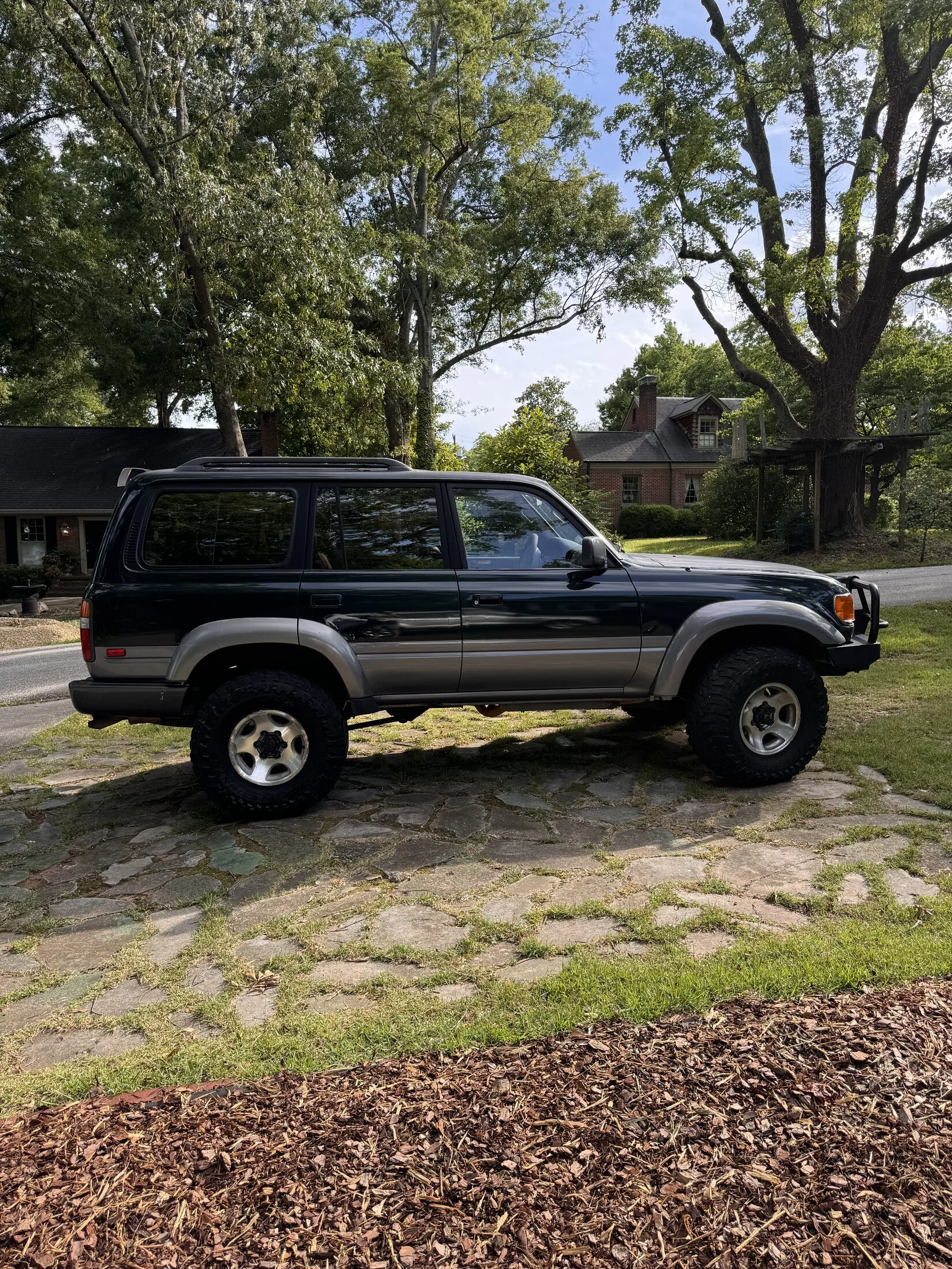

Here is a picture of mine with 850J (front) 863 (rear) and 30mm spacers at all four corners.
Here is another shot of it both pictures it is sitting on uneven ground.
