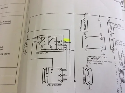

I have just refitted the old Toyota voltage reg .
The voltage is stable at 13.2 volt and the fuse able link is warm . Not hot.
On the after market reg it appears the common arm on the heaver duty relay has been getting hot.
I will have to re read Rudi notes on gauges and clusters .
I will now check my earths
A photo of the hot common arm.
Another mystery is we're does this blue wire go. It is joined to the White and red trace wire.
My wire diagram does not have a white and red trace yet the OEM reg has a white and red trace wire.

I think you mean Voltage Regulator External in this thread: -► https://forum.ih8mud.com/threads/voltage-regulator-ext-how-it-works.747718/
The coil of the regulating part can become pretty warm, almost too hot to touch but that's normal.
More interesting is how many amps is flowing from the alternator to the battery.
Do you have a DC (not AC) Amp clamp meter like this one?
Makes life so easy. No wires to disconnect , just clamp around the wire and read.
That blue wire is for a capacitor aka condenser. This capacitor was used to filter out the noise from the switching contacts of the VR when listening to AM radio. Forget it for now or add a capacitor later if you need one.
You see the capacitor on the left side of the VR.
Rudi
