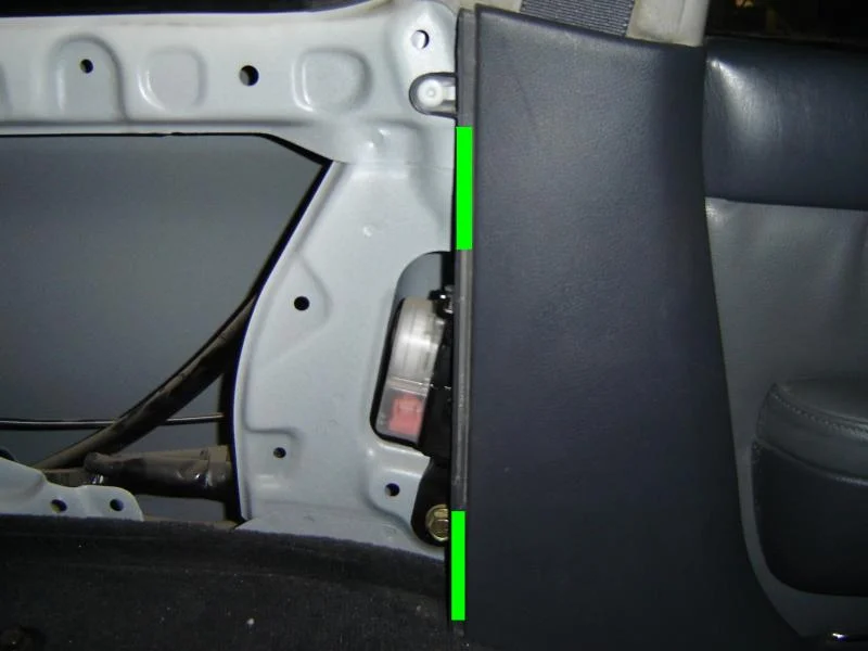

Here are few pictures of where I'm talking about, Ali.
The FE is going to mount near the driver side rear seat belt. There's plenty of metal and spots to mount to, and it's right behind the front seat (with the handle mounted forward) so all you have to do is open up the rear door and its right there. Since it's mounted up on the wheel well, it shouldnt get in the way of the seat or passengers.
The lower bolt that holds the seat belt housing has at least 1/2" of threads left after the nut, so there's plenty of bolt there to add the bracket to. The front body molding tucks under the rear piece, so i'll notch the plastic (where the green lines are in the pic) so the bracket comes out where the two pieces join. I drilled holes in the interior panel of the Rover and it looked like crap when I moved it, so this way you dont have holes all over if you do move it later.
Hope that makes sense... I think im going to mount it friday when im off.
Excellent location. That should work. In my case, I have a barrier that may get in the way but will check that area out.

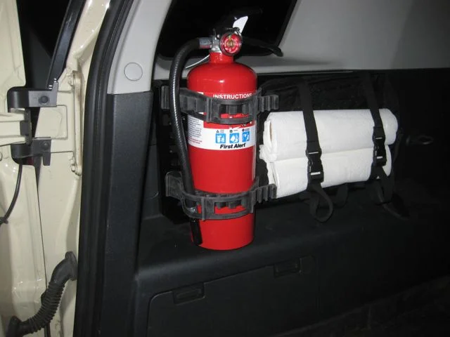

Bought a bracket from a local shop, and i think it was well worth the money. Made the install much easier since the bracket that came with it was just made to hang on a wall.

Now, I like THAT bracket. Let me have some info and I'll see if I can duplicate your install. You did a nice job - elegant and not overkill. Are you confident in the abilities of those two rubber things to hold on to the FE during a collision?

I trust the rubber straps. They're feel solid, and only stretch a little bit to allow you to secure them in the mounts. I think it would be a huge amount of force to stretch those straps to breaking point. The FE isn't mounted facing straight forward in the vehicle, so I dont think all the energy would be exerted on the straps alone. Here are a few links to the brackets, and it says they're made for automotive use (and are used in emergency vehicles.)
I mounted it really close to the body, so that made it a bit tricky getting the trim panels back in with the plastic pop rivet gizmos, but I was still able to do so.
here are the links...
Extinguisher Brackets
Amerex Fire Extinguisher Accessories- Fire Extinguisher Brackets
I bought mine localy, so you might be able to find a shop near you that stocks them.
