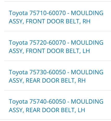

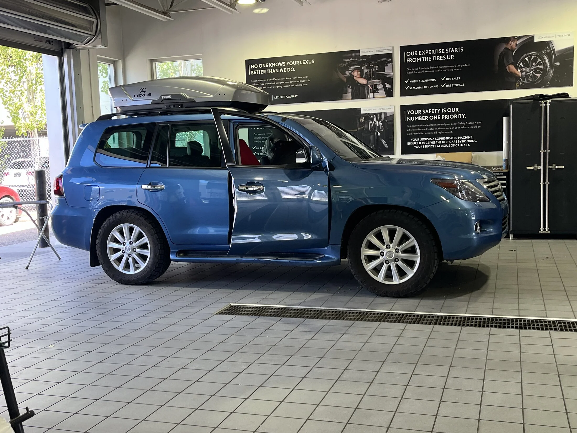

After that I headed down to visit a family friend at Lexus Calgary where this truck was sold originally in 2008. My family friend actually remembers it showing up and getting sold within a couple of days. They have their own glass guy who is going to work on the aluminum moulding trim and clips that have come apart over the years, I also had to order a touch up paint pen that isn’t available in North America currently. While there, I spotted another old Lexus.

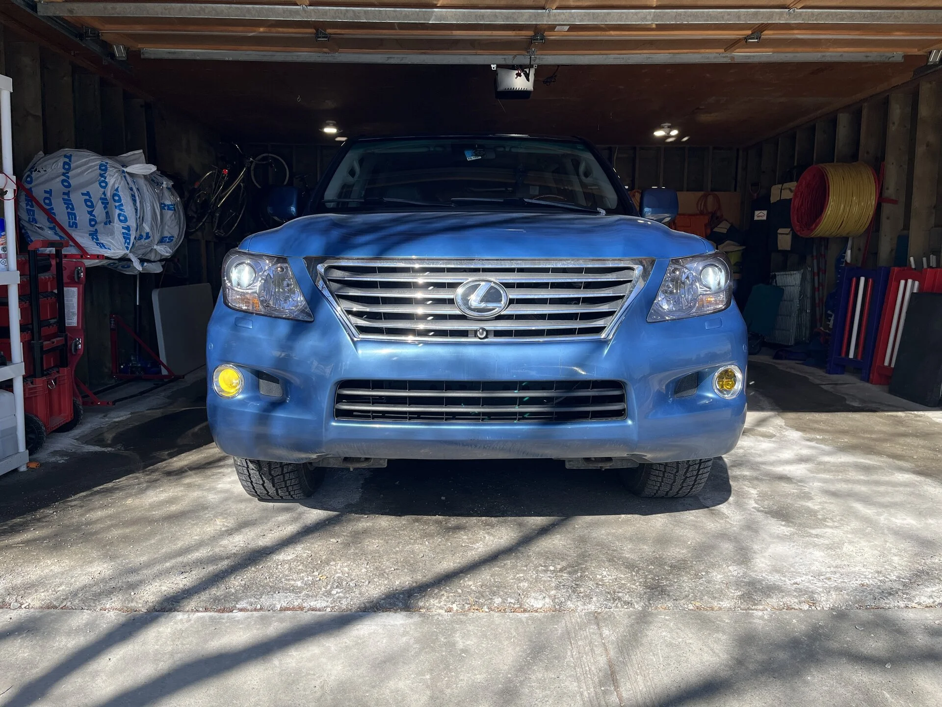

Loss - fog lights, ugh. There were diode dynamics previously but the seals must have dried out as both housings were suffering from moisture and the bulbs were quite corroded. Drivers side went fine, passenger side where there is a vent that allows moister to splash back, not so much. I will have to drop the bumper to finish the job as 2 of the screws were on the verge of stripping and no one needs rounded off screws in their life. I will deal with that when I get back from vacation and rock the two colours for now. Anyone have a part number for fog light mount screws?

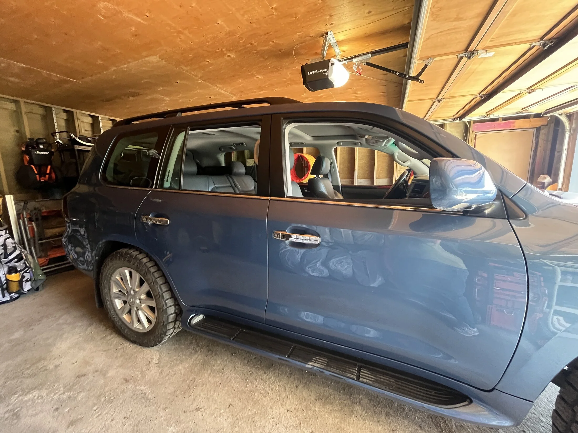

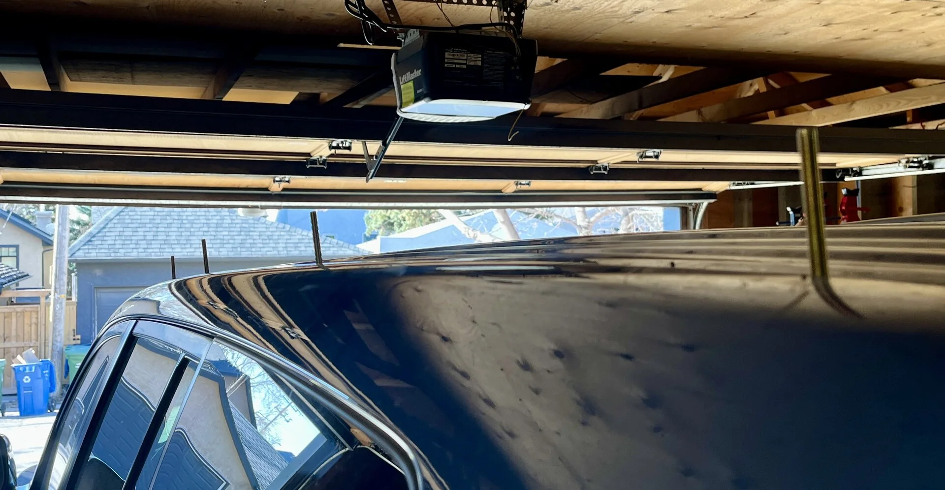

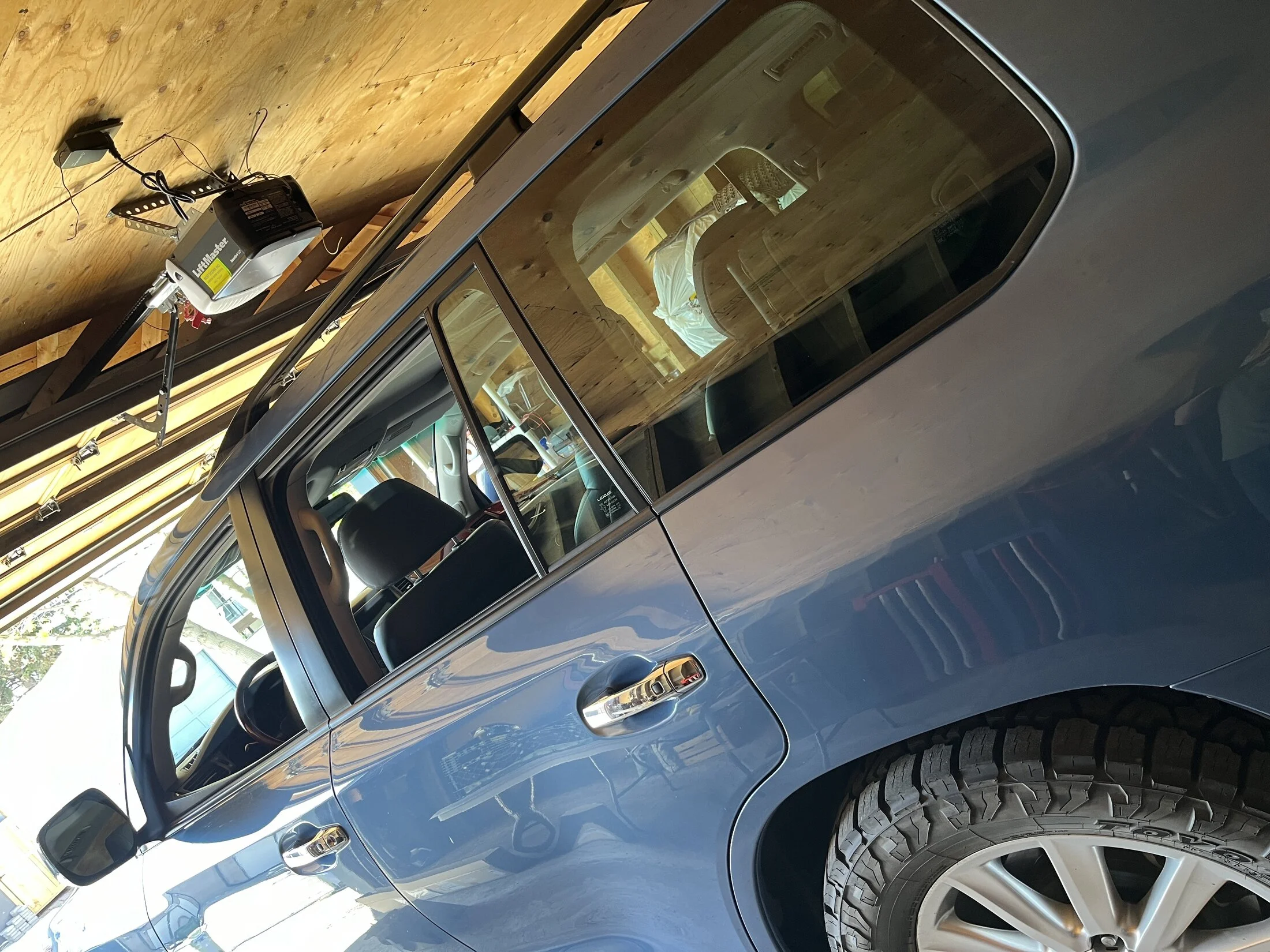

More mods, more fails. This weekend I worked more on some mods for the upcoming boys golf trip, which means loading 4 guys and golf gear through the winding roads of panorama. Lexus, for reasons unknown equipped the LX 570 with really short roof rails, and the Land Cruiser with longer rails (just under a foot). After tracking a Land Cruiser set down stateside (thanks to ih8mud), I was able to swap out the silver for black, and now have less overhang for the roof rack.
Before:
Going for that punk look. These studs ensure none of the bolt anchors fell into the headliner while I swapped rails (another ih8mud idea)
Finished up and ready to load up with golf clubs as Lexus intended

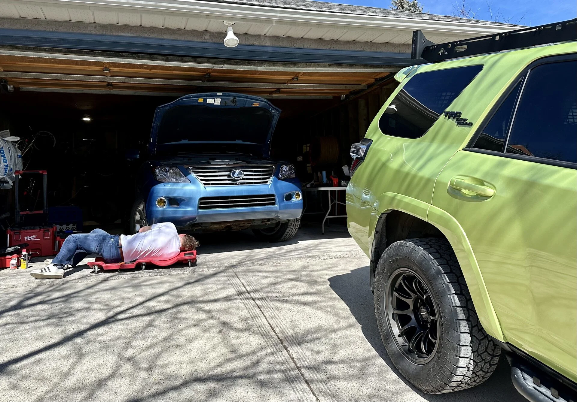

Mod 2 unfortunately stopped in motion again. If you’ll recall from my previous post, there were some diode dynamics LED bulbs in the factory housings. The seals had long since given up, there was some moisture in the housings so I opted to upgrade to the Diode Dynamics SS3 Pro fog kit which is plug and play (or so I thought). After the last attempt where the passenger side defeated me due to seized screws, I was rocking one OEM fog light that worked, and one SS3 which wouldn’t illuminate. Upon getting the screws out, I thought it was going to be smooth sailing. Sadly now BOTH SS3’s won’t illuminate, but the dash shows fog lights as on (switch works), fuse is good, we tried with high beams on, low beams on, e-brake engaged and not engaged, in park and in drive, noooothing. If just one headlight was not working I would think it easy to track down as a bad light, but both….wtf? This mod is kicking my ass, I have an email into diode dynamics but if anyone has suggestions I am all ears.
Here is a shot of me frustratingly working on it with a friends 4Runner in the driveway

Are the bulbs reversable? Many LEDs are polarity sentitive and won't function if installed in reverse polarity.
Update, one bulb was reversed, the passenger connector seems to have a corrosion issue, it will light up when partially engaged but turns very weak when fully connected. I might have to de-pin and clean the connector unless someone has a better solution.

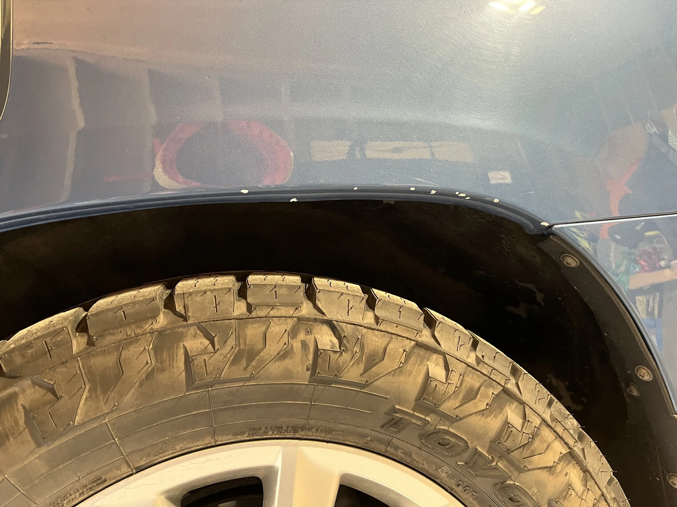

Previously this truck had some zero offset Te37’ s with 1.5” spacers, looked cool but definitely left some rock chips. In order to avoid future rust issues, I spent the rest of the day cleaning out, priming, then touching up each wheel well.
Primer:
Finished:
Finally I went to check on that front fog light, seems the contact cleaner and dielectric grease did it’s job, both are currently working.

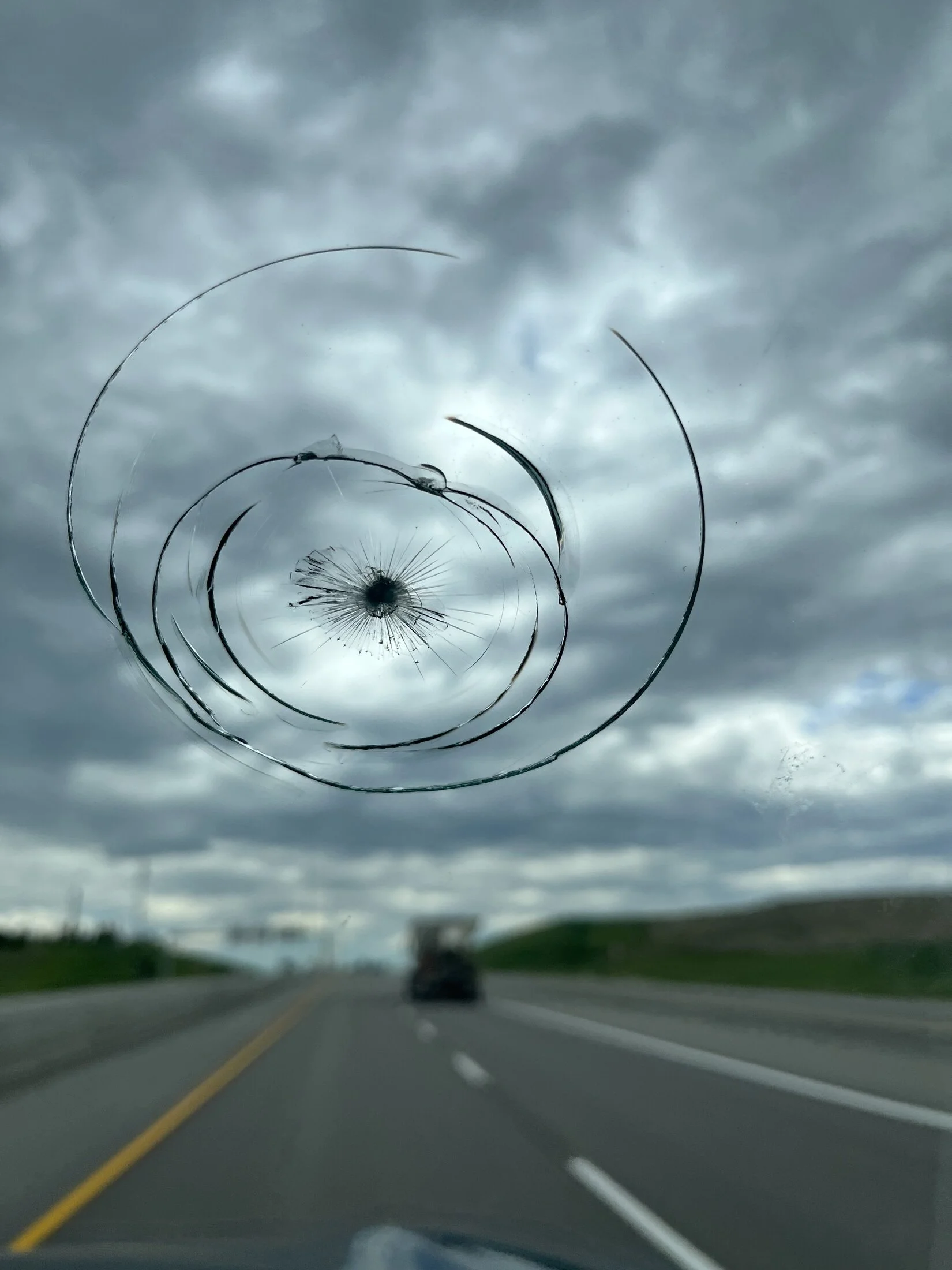

Thanks to a driver of a gravel truck that didn’t cover his “empty” bed, this beauty showed up. I called the owner, and despite his buddy having a shop that could totally do this for a deal, I told him I only trusted one guy in town to replace it. He was hesitant but then other cars that were showered in rocks started calling insurance. Unfortunately Lexus of Calgary couldn’t source aftermarket glass, so brand new OEM goes in.

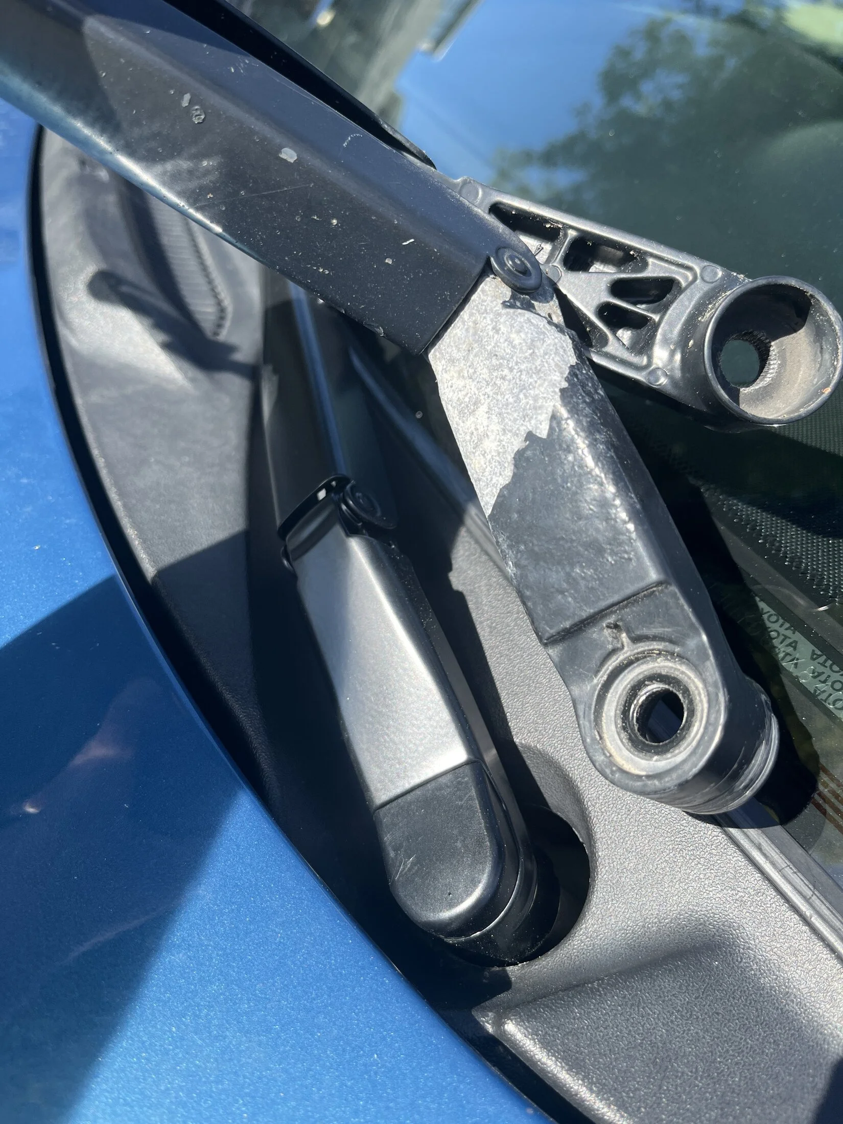

And while I was there, replaced the old and crusty wiper arms with some new OEM units

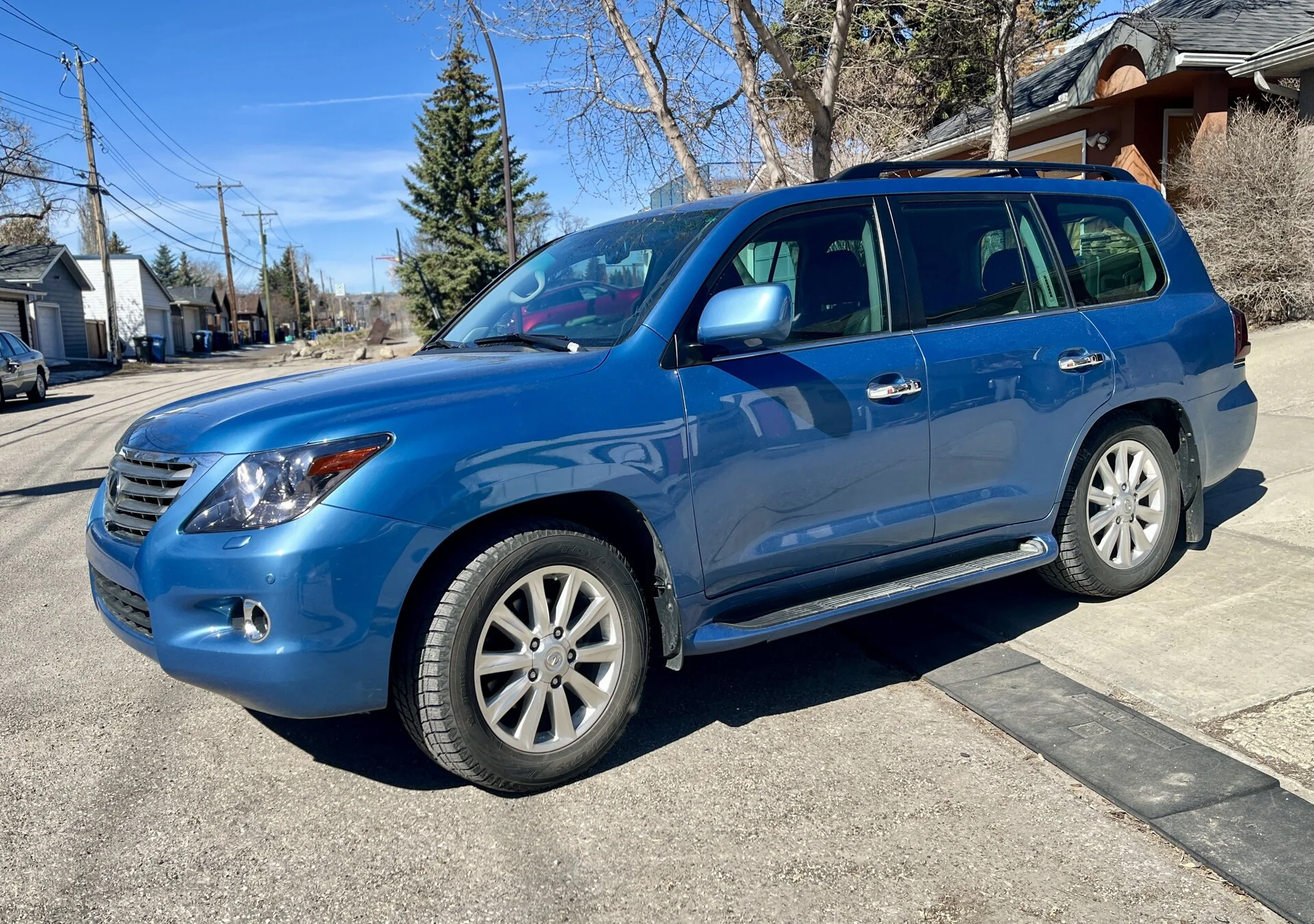

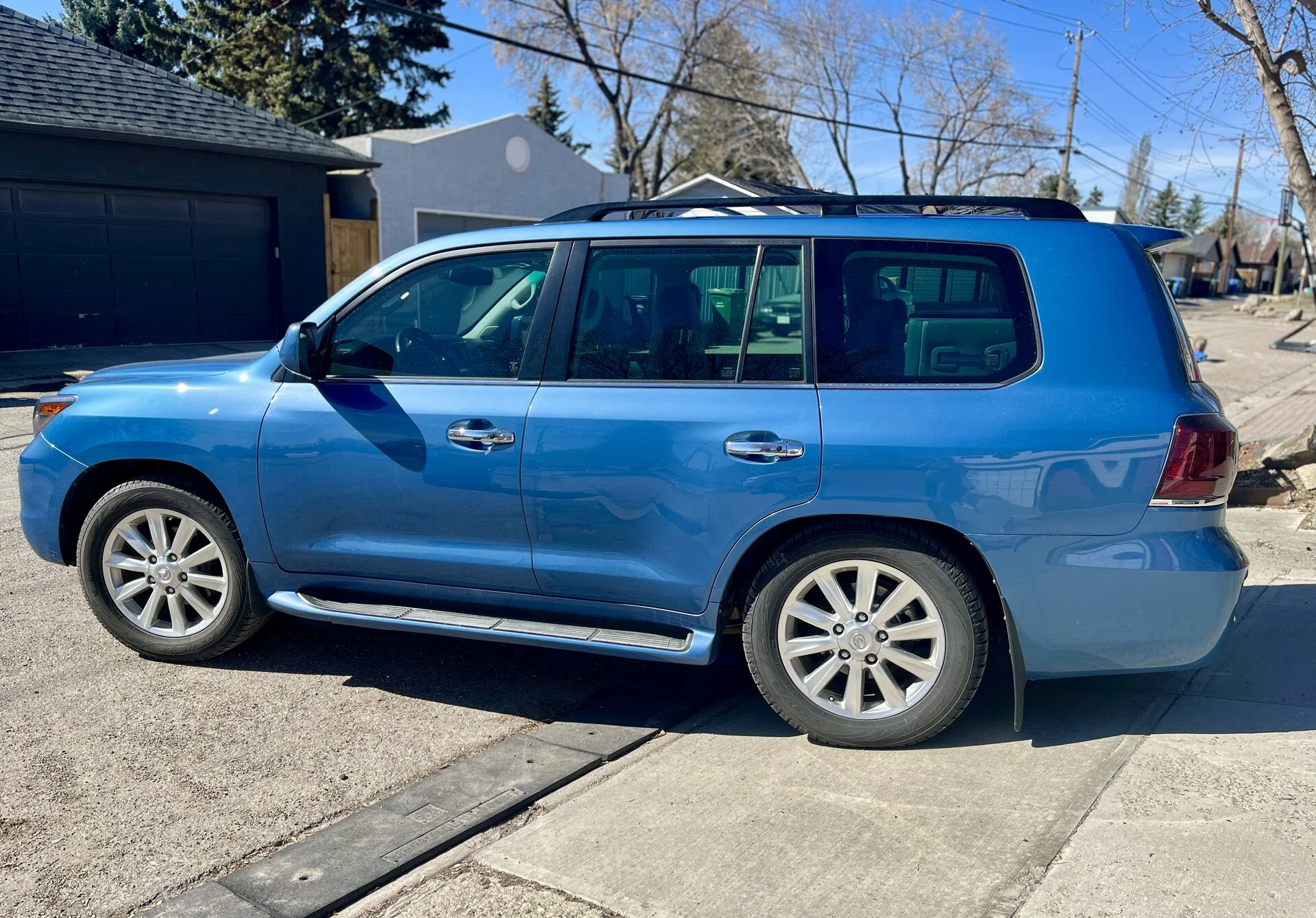

It’s Costa azul mica and was only available between 2008 and 2010 in Canada and 2009-2010 to the us. Mine is one of 9 that came to Canada, I believe 134 were delivered to the us.
Avery has a wrap colour that is close, but I don’t know the name of it, I just compared swatches against the paint.

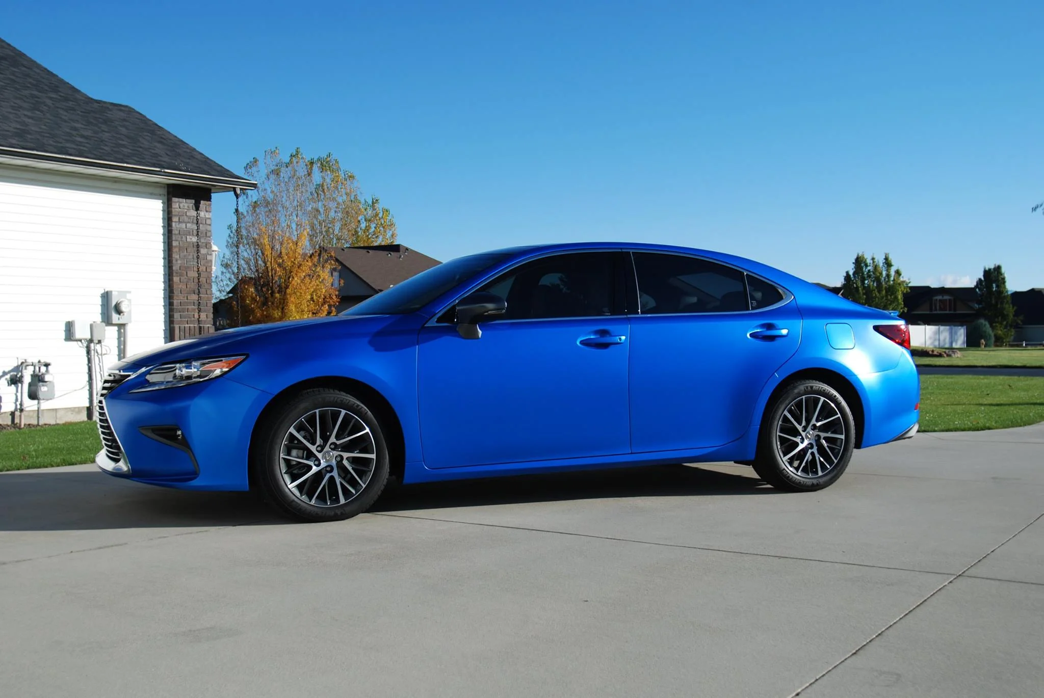

It's not too far off from the color I wrapped my old ES a while ago. 3M Perfect Blue Satin. (I believe it is discontinued now)
