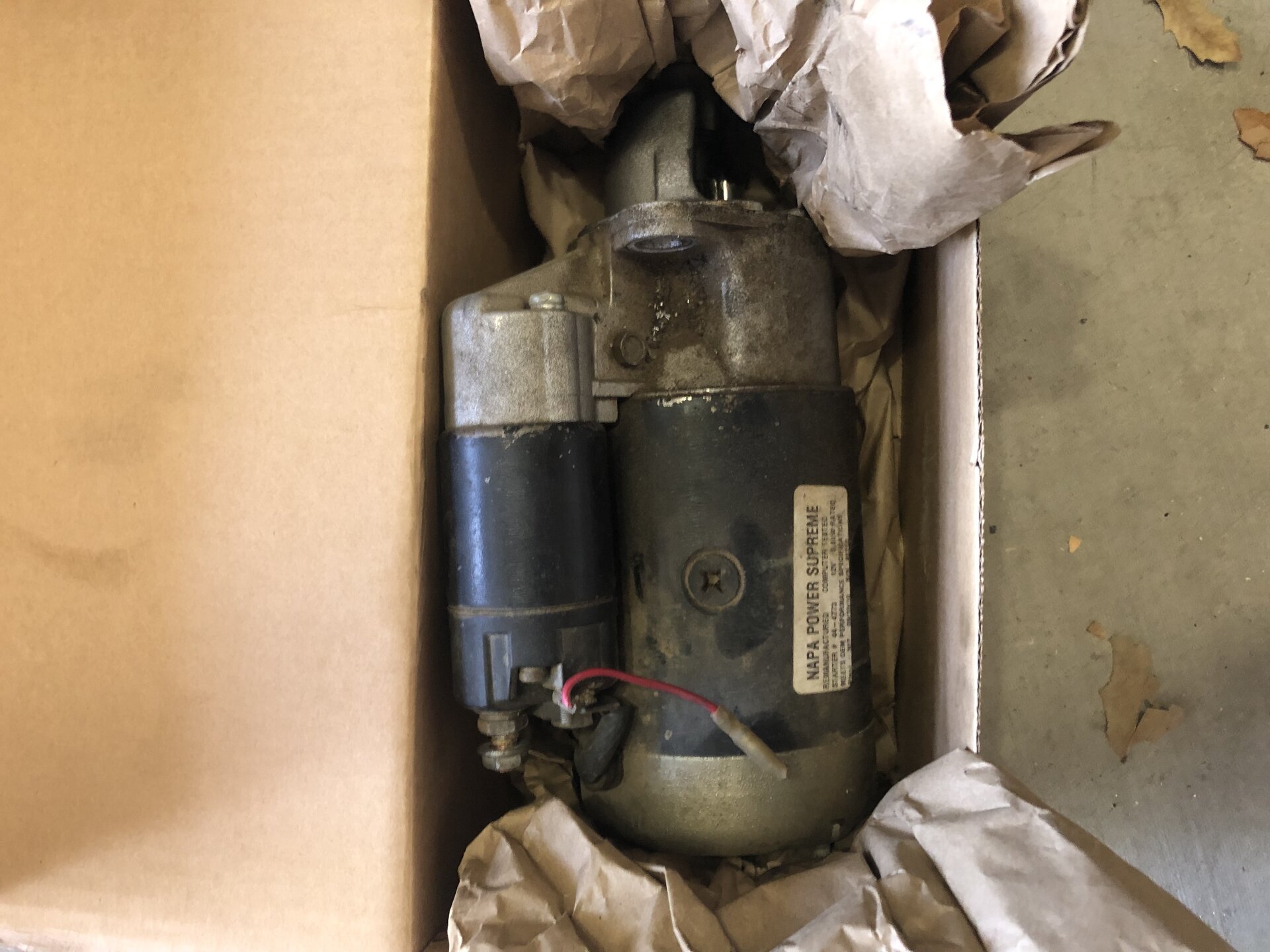

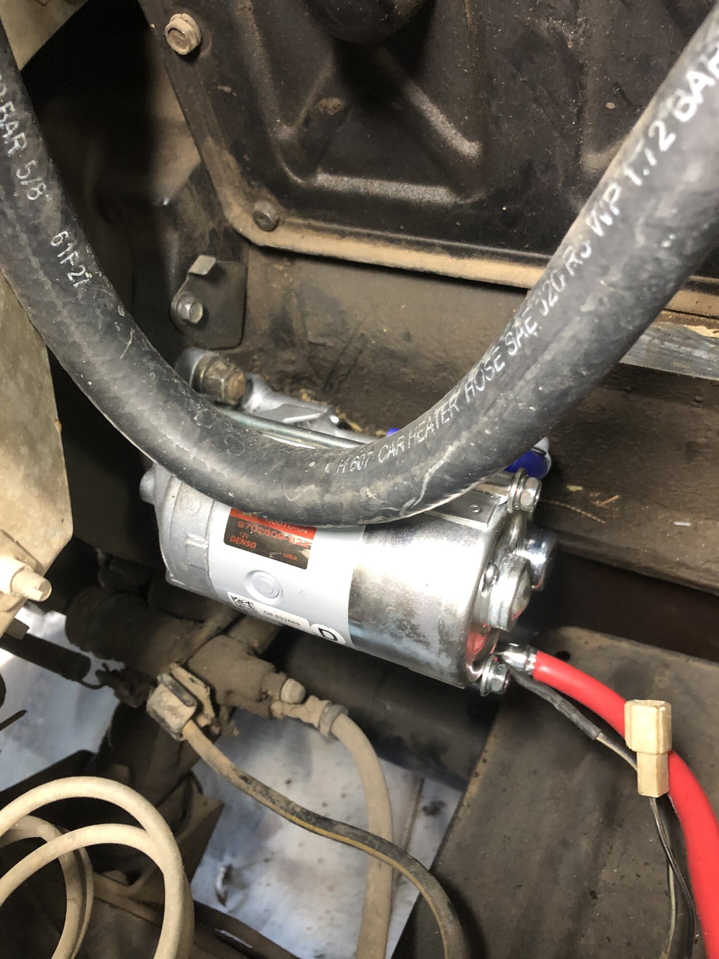

New toys from Toyota. I’ve just installed my gear reduction starter. I ordered it off of a 86 Land Cruiser. It goes in no problem! But I have an extra connector..? The previous one (a Napa power supreme) worked pretty good without it and ok when I found where it went. So I’m not terribly worried. Just curious. I also have a new radiator from Toyota. My old one is slowly deconstructing itself. That’s the next task.
Found it! That spare wire comes from the ignition coil. Us only. The 86 fj60 I got the new starter under doesn’t have that connection. It ended by 83

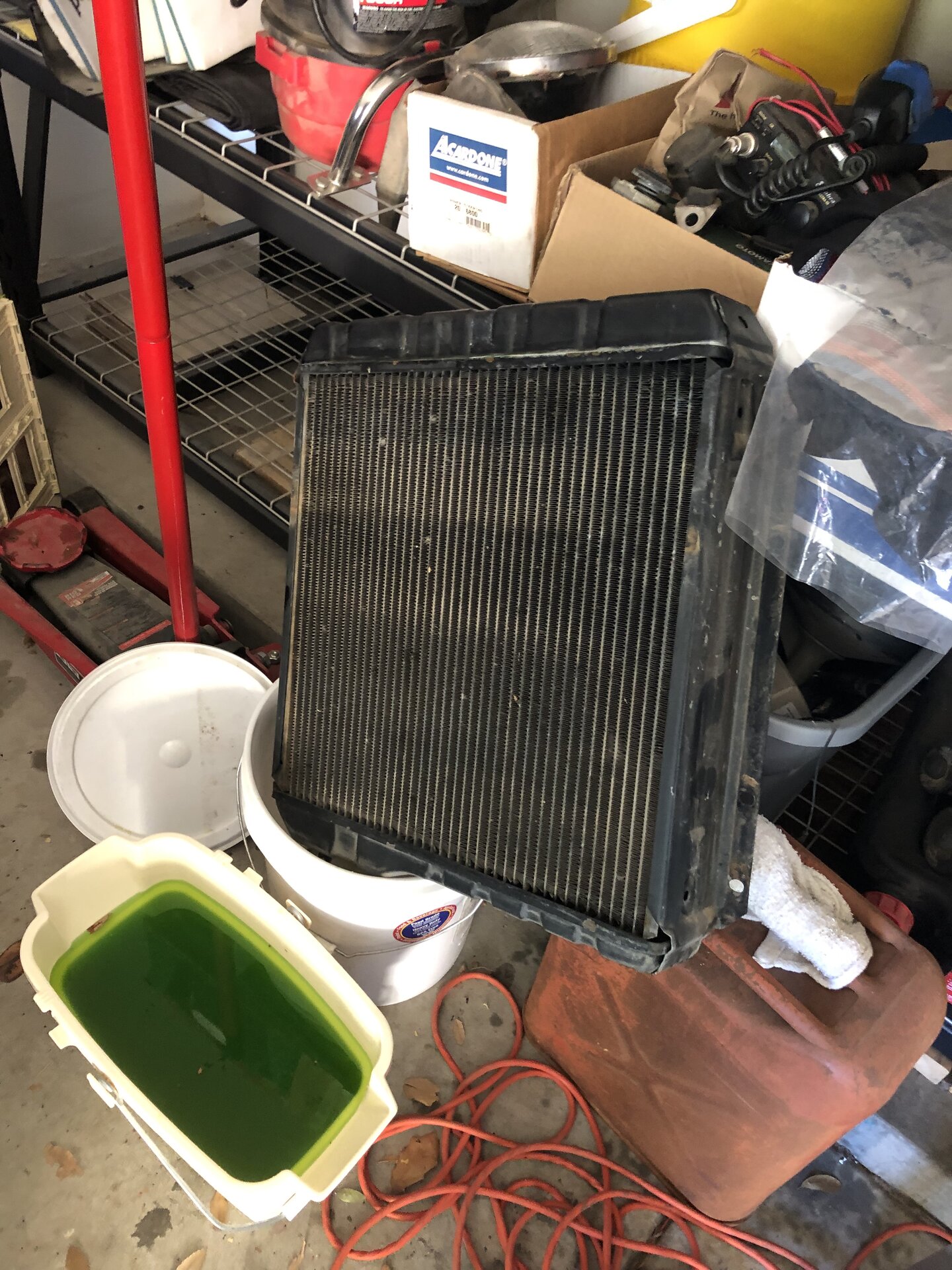

Replaced the radiator! I bled the old one with its butterfly style relief valve. Then took it out. It was pretty heavy compared to the new one. While it was out I painted up the radiator support. Then I put the relief valve that Toyota gave me in the new one and installed it. Looks great.

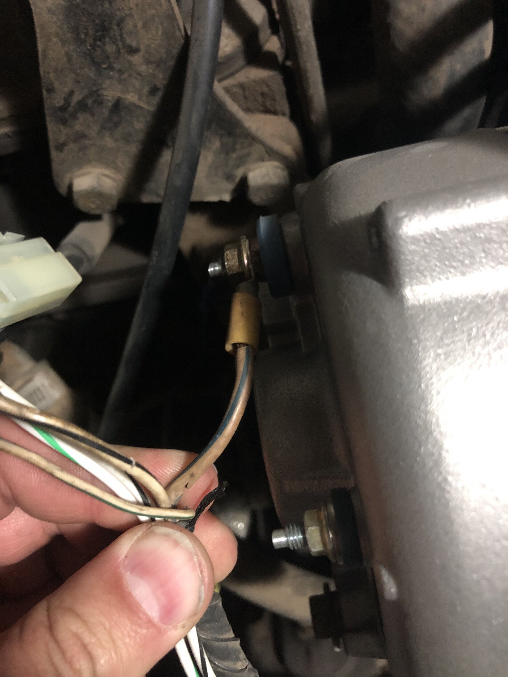

The parasitic draw is back. It is acting exactly like it was before. It seems to be localized to the charging system (after much volt checking. Removing the white/blue wire off the alternator changes the draw from .276 to .032. And disconnecting the fusible link drops it to .003. But as @Coolerman pointed out to me further testing of this like is needed as there are a few branches to this line.
hi Seth ,
carefully examine this tech photo you posted above ,
you will notice the exposed copper strand wire exposed in the non-sealed low quality crimp-style B+ ring terminal , the inside starts out as a full cylinder NOT a pair of 2 open barrel folding terminals , 4 in all , all together ....so poor conductivity and High resistance is present i can clearly see at play there
next , note the chips and nicks in both the White w/ blue tracer stripe big gauge primary wire and also right next to it , white wire w/ black tracer stripe NEG- Ground circuit to your FEN female socket alternator in-put plug socket
Low Voltage DC Current and Electricity Always takes and uses the path of least Resistance Value's / OHM's
i see all these factors i outline above at play in your photo clearly ...
start here before you start chasing Any other places down , this is a
Red Flag ⛳
begin here , then stop and re-test for these same exact
.276 to .032. diagnostic results from earlier ...... then report back if any changes or not ?
- Confirm
- Verify
= Diagnosis
this is the way ....

I just started catching up on this, and noticed your post on the gear reduction starter. Here's how I handled that:
In my case, I already had it, but the PO had re-jiggered my dizzy/coil and that extra cable was deleted. I added it back in to make starting the truck easier. It's basically a way of giving the full 12v of juice to the coil while the truck is cranking (bypassing the resistor), as the starter motor takes up some of that juice.
