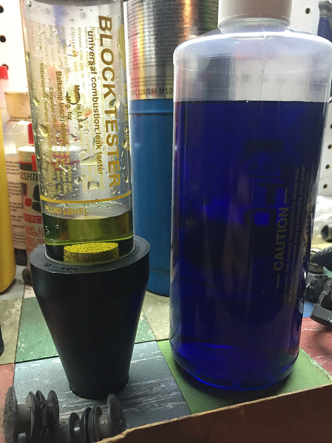

Well tonight I got confirmation... not sure if all of you have seen my RTH thread about what I thought was a massive air bubble, but well it wasn't.
Basically over the weekend I tried putting some new coolant in the system only to have her take a whole gallon of fluid and then puke it out on my driveway and in the local Petsmart parking lot. Lots and LOTS of bubbling, banging and other noises coming from the radiator that I was trying to figure out.
Today after work I ran to NAPA and grabbed myself their Exhaust Gas Test Kit (#700-1006) and tested at home.. She warmed up pretty quick and then I started the test.. final result is that there is carbon dioxide in the coolant which means the head gasket is gone.
Video
Pic...
Untitled by Greg Fisicaro, on Flickr
That really sucks. I didn't chime in on your RTH thread since other people were speaking my thoughts but I knew that it had to be a head gasket.
I've put new coolant in a bone dry block 2 times in the past couple months and the air seemed to self purge after a few short trips. That's what made me skeptical about the massive air bubble diagnosis.
On the bright side you have the issue resolved and can spend the money where it counts to get your rig back on the road! Plus a fresh head to boot!
