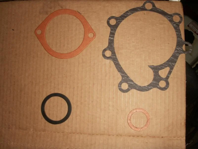

like puzzles? then you should be able to figure out which of these gaskets i have left over after its buttoned up I know the water pump gasket but the other 3 im not sure about :whoops:
I think one is for the dizzy (cork/paper) and the round rubber one im not sure about. Probably just the crank seal :bang: Sure would be nice if gasket sets came labeled.
attachment.php
Top left- thermostat housing gasket. Between the two halves.
Top right- gasket that goes between the metal plate on the back of the water pump and the cast aluminum housing. Don't even mess with replacing that gasket.
Bottom left Seal that goes on top of the thermostat. Don't leave it out. If you do the thremostat won't seal correctly.
Bottom right no clue.
