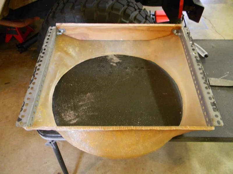

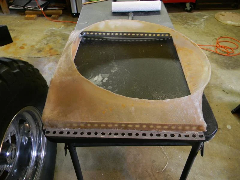

I finally got a complete layer of glass laid down over the weekend so I have something stable to work with for trimming and additional fiberglass. I got the fan disc cut out and the excess material on the sides trimmed up. It's starting to look like a fan shroud!

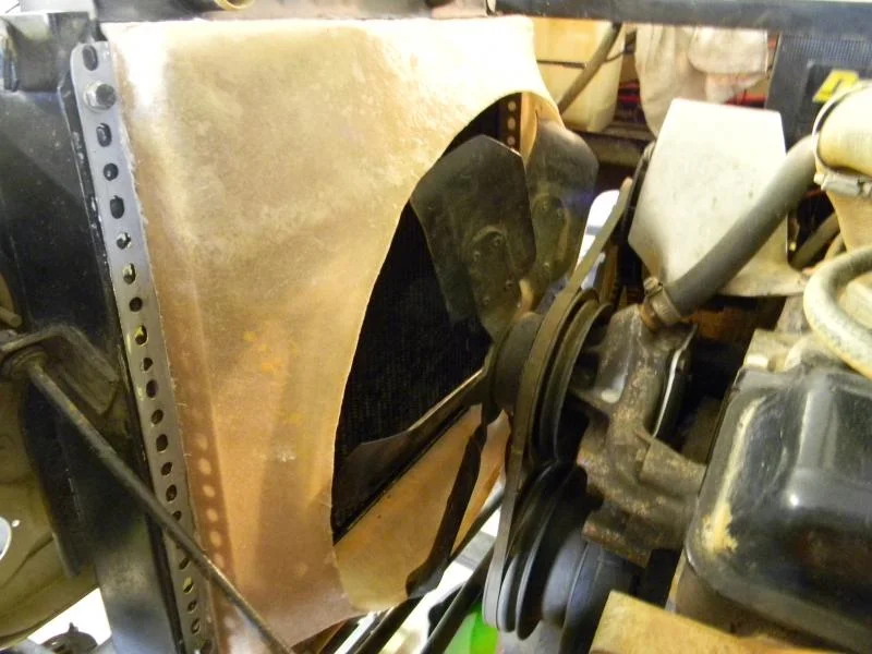

The initial fit check is good. I have a section of the fan arc to trim for additional clearance, but I'm very happy with the blade depth, plane, and fitment in general. The upper left half of the arc clears by about 3/8", while the lower right has almost an inch. I may have mis-marked it for the mold or maybe the plywood disc shifted while stretching the speaker cloth. Either way, once I get it evened up I'm sure it won't affect the cooling enough to worry about.

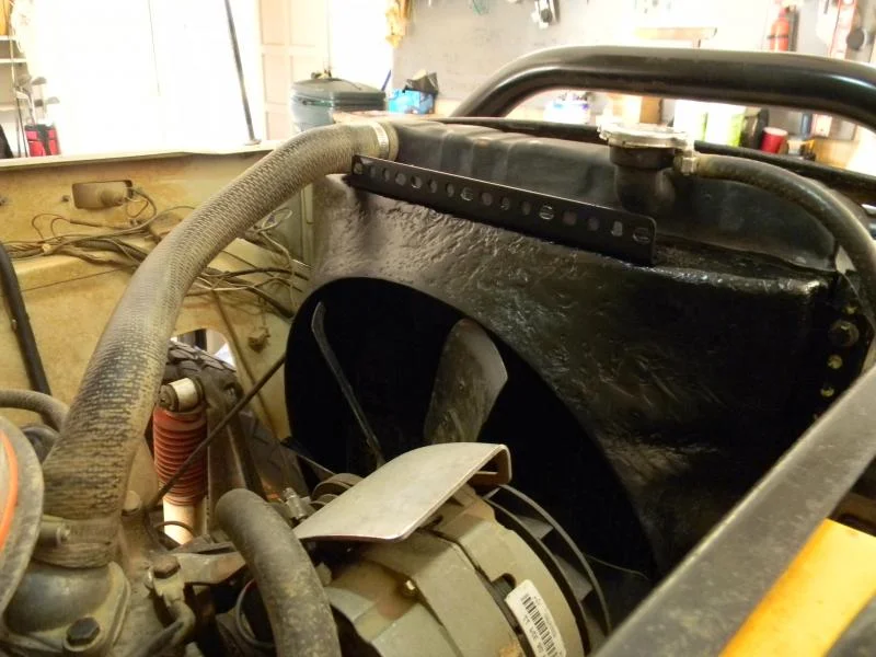

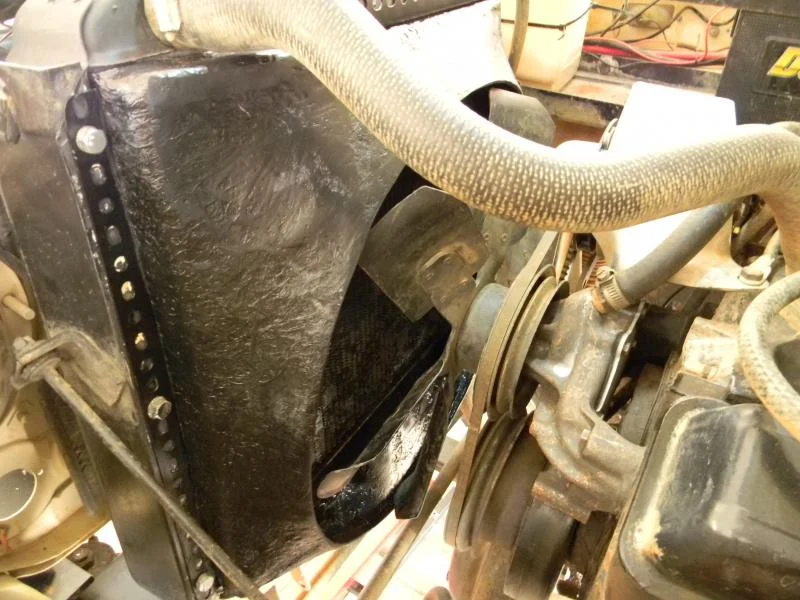

I finally finished the fan shroud and could not be happier! I ended up putting only two layers of polyester mat down - one on the inside and one on the outside of the spandex substrate. It is incredibly strong, like I think I could stand on it. Spray painted it black, installed, and tested it. I ran at 2500 rpm for 10 min in the garage with a max temp of 192F. Then I idled for 10 min and it went down to 180F. Ambient temp is about 70F. WOOHOO!!!!

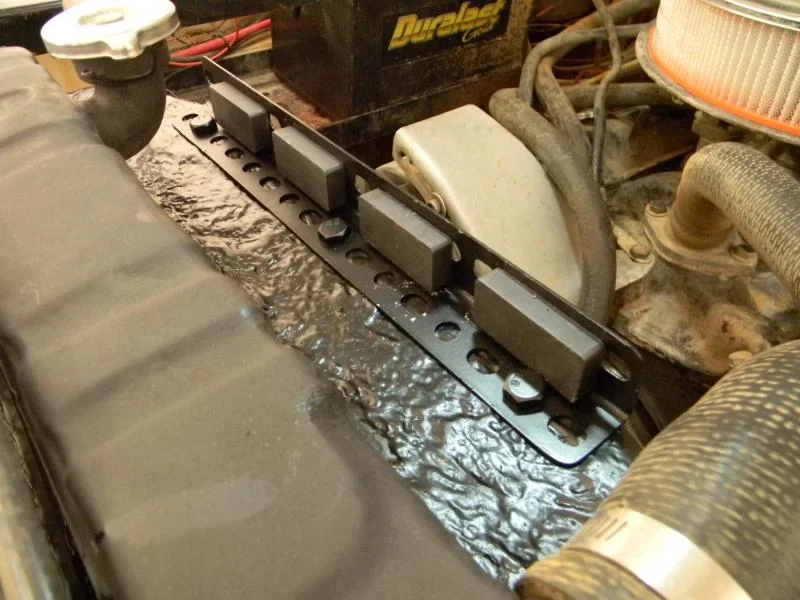

I also built myself a little magnetized shelf for tools. It's not pretty, but it will catch an errant socket or screw before it gets shot out by the fan.
