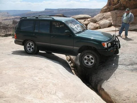

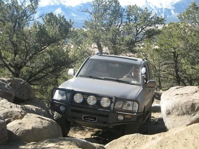

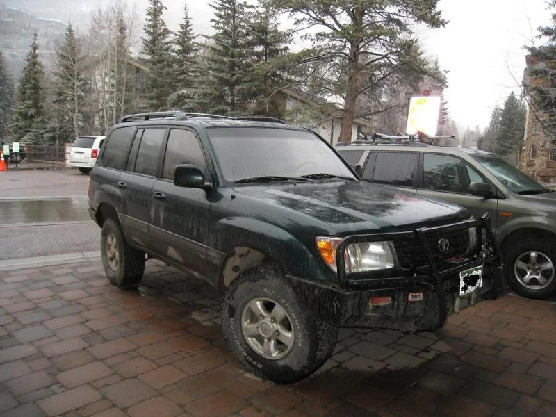

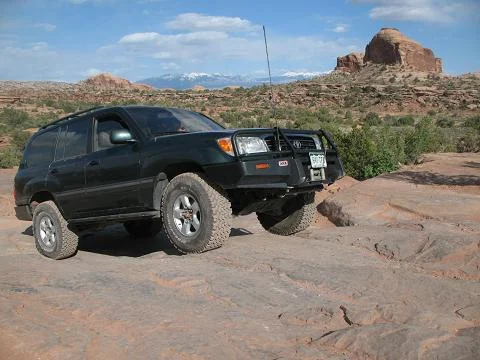

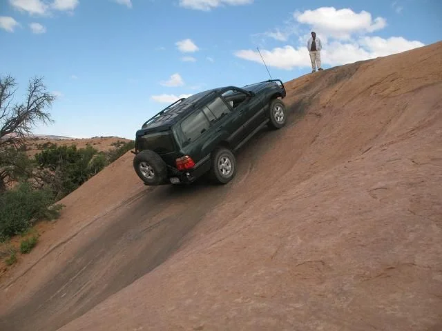

In 2004 my first child was born. I had recently purchased a 2003 Tacoma x-cab. Sure you can fit a child seat in the back of the Tacoma. Total PITA. And with my wife pregnant 4 months after the birth of our son, it had to go. So I searched for about 4 months for a low mileage 80 locked and green. I have a thing for green trucks. 1978 FJ40 was green, tacoma was green, Sequoia was green. Searched with no luck, Then I found a broker in Crested Butte with a '98 UZJ100 green, rear locker. I did some research but not that many people in the US were taking theirs off-road(I prefer the term off-pavement, I Stay The Trail) I had been on a few trail runs with Rising Sun Toyota 4x4 Club * Denver, CO At the time built 80's were still not that common. No one had any real advice other that,"it'll certainly be better than a Land Rover" We traded the Tacoma and $1,000 for the 1998. V8 power, automatic, power everything heated leather seats. You name it, it had it. My wife liked it, enough said. I sold the FJ40 for enough money to add 295.75r16 nitto TG, Slee lift w/866+diff drop, ARB Deluxe bar, Slee step sliders. I don't recall driving it stock for long, few months maybe.

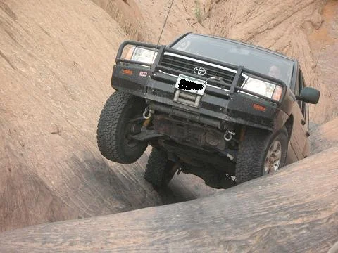

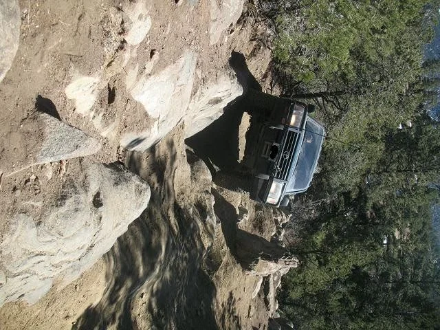

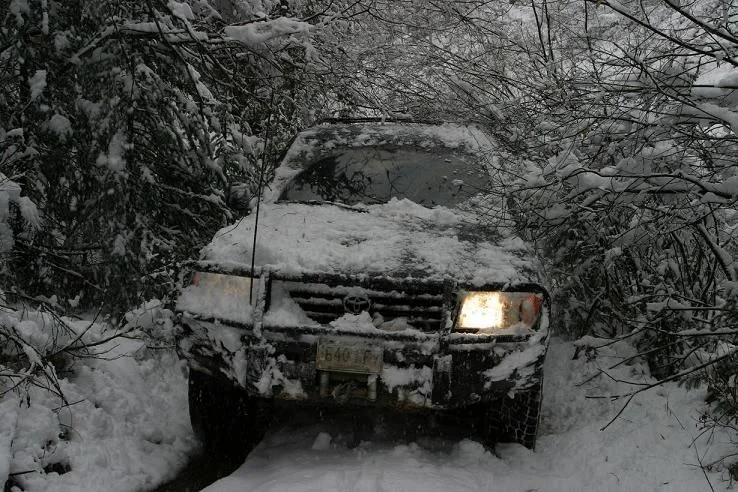

I took it on Old Tin Cup pass, and hit a rocker about a week before adding sliders. It hit at the front mud flap and couldn't be seen. Dent #1, I'd owned it maybe a month. Armored it up with the money from the 40 and joined the Club to run Chinaman's gulch. This was the 1st real challenge the 100 had seen. TrailDamage.com - Chinaman Gulch It was non stop sharp pointed rocks everywhere. I slid backward into one. Smashed DS tail light and rear quarter panel. I had removed the factory rear bumper, so the rear end was naked. I think it probable saved me some money. I ordered a new tail light and did my best to hammer the dent out. It's still fubared to this day. I put the factory rear bumper on, apologized to my wife that I was now 2 for 2 son smashing the truck each time I went out. But I did buy it the wheel safely with the family and it was working out well. The annual Father's day run at Spring Creek rolled around TrailDamage.com - Spring Creek I had done it the year before in the 40. I struggled in the rock garden, about the same amount. But my son didn't have to breath fumes all day. I did however bend a lower control arm. I took it off and hit it with a BFH when I got home, reinstalled it slight bend side down in hope of hitting it again and having it end up perfectly straight.

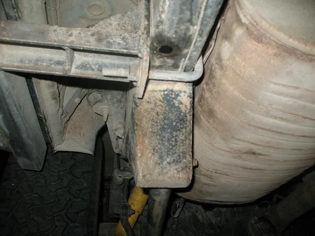

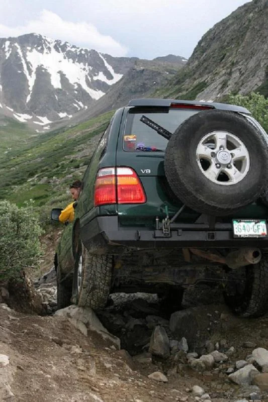

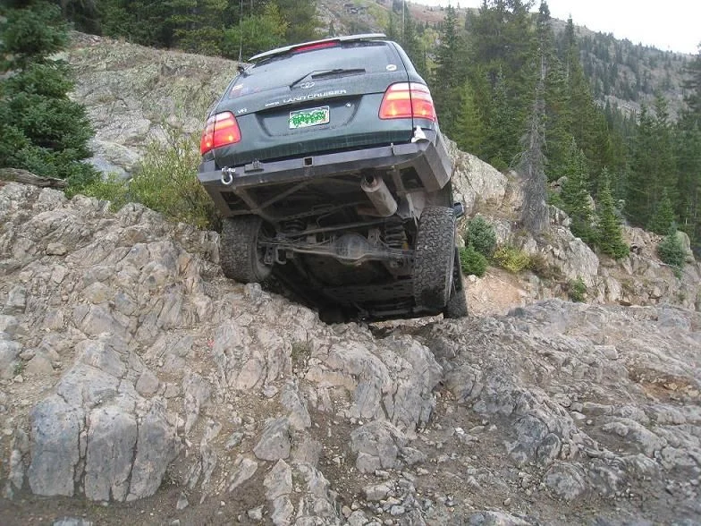

Ok techie stuff. I had Irbis Offroad build me a rear bumper. He had done some nice work for the guys in the club. I felt I had spent enough money with Slee getting the lift and sliders. (little did I knowI had just scratched the surface with them) I had read an article in a magazine about cutting the rear frame off a Lexus 470 to gain more clearance. This apealed to me. So I had them chop the rear and build me a custom swing out and repair my now broken lower control arm mounts. (Zane did a great write up on how) as well as fix my bent LCA's.

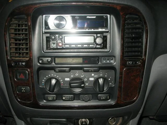

When I first started running with Rising Sun. I kept wondering why we were stopped. The I got a CB radio and I could communicate with everyone. Uniden someting, It's currently in the 100 mounted to the plastic center console in front of the passanger seat. Then about a year and a half ago. On the anual Ghost Town Run. Again there was no communication. Turns out just about everyone in the club ahd switched to 2 meter radio. The club put on a class and hosted an exam. I got my HAM license. I'd been using XM radio pluged into the tape deck and into the cigarette lighter. One on the stipulations my wife put on the install was there needed to be less wires on the dash than before. My CD player had stoped working on a number of accations due to my children feeding quarters and other coins into the slot. I did some searching and decided to get a XM ready pioneer single din radio. And put a Yaseau 1802 in the now empty spot. I get rid of all the wires and was much happier. I'm still not great on the 2m. In the words of Martin,"my geek speak is not yet worthy"

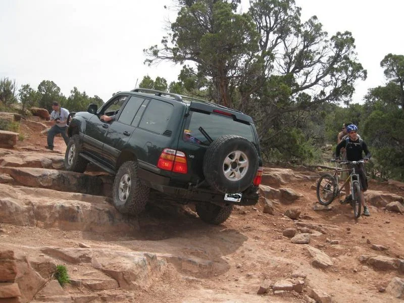

Gr8 post, Gr8 photos and a Gr8 read Farnham! Is the first photo in your #9 post above on the Pearl Pass trail by chance?

Thanks. Pic 1 on post #9 is FrenchCreek on Holy Cross City trail.Holy Cross 2009 - Rising Sun Member Forums

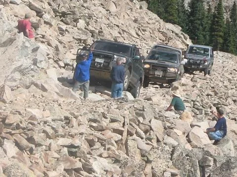

I've been over Peal pass a couple times. It's a nice trail. Tomichi Pass in the 1st pic below was the most scared I've ever been in my truck. 2nd pic Pearl, 3rd Pearl Pass

Yep that's the spot. I thought the 2nd pic was you stuck, but it's some where else on the trail.

A question on the rear bumper. A buddy of mine were talking about the effects of cutting the rear crossmember off. And that will cause the frame to twist more. I told him I have no clue but he told me it was correct.
Any observations on how much the rear moves at articulation VS a frame mounted bumper? if my question makes any sense lol
