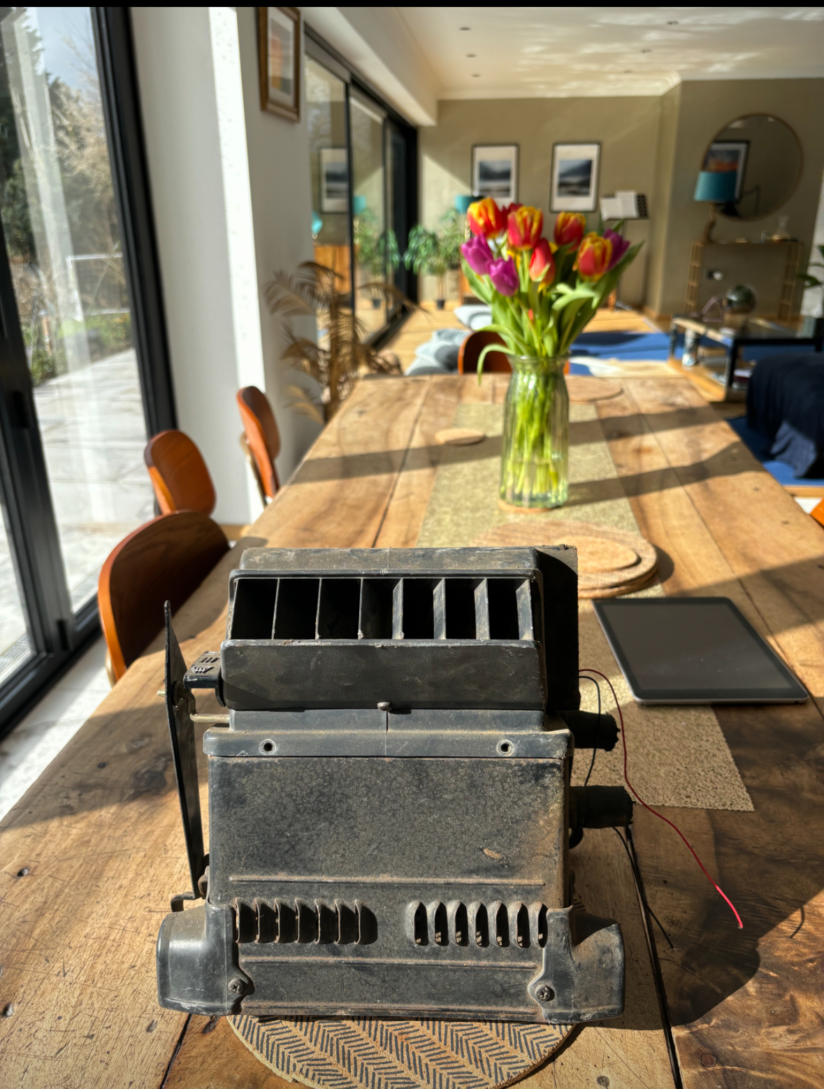

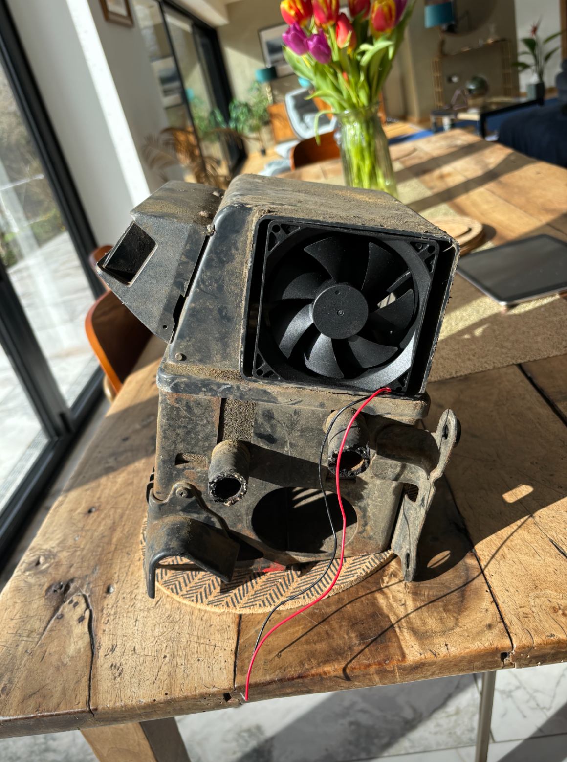

Just wondering if anyone has tried putting a fan in a heater box. I have RHD BJ40 with no heater but I do have a LHD heater box and fan. I was thinking of putting the heater box in but with its own in built fan, would it work or am I being stupid?
View attachment 3570623Just wondering if anyone has tried putting a fan in a heater box. I have RHD BJ40 with no heater but I do have a LHD heater box and fan. I was thinking of putting the heater box in but with its own in built fan, would it work or am I being stupid?
I tried it and it worked. My original wiring was a mess from the PO with no power to the blower. After I did a complete wire harness replacement I went back to the stock set up. That is the good part of the mod is it is easily returned to stock configuration.
That looks good, it will probably not have the CFM of the squirrel cage fan in the engine compartment, but it will certainly draw in air.

Thanks, my wiring is mess as well, it’s on the list. I think if it works enough to stop her misting up in Welsh rain it will be good enough for me.

The brushless fans are only about $10 so if it’s not strong enough I guess I could put another in the bottom. It’s in tight without any fixings so I can always pull it out if it doesn’t work out
With low air flow the air will be more likely to short circuit. Air being discharged with head right back to the fan. If you have a high humidity problem will also have no way to bring in outside air. Once Toyota started building FJ40s with a heater designed just for the vehicle outside air. Canada 40s went a step further and required a vent relief in the back. This is to help with windows fogging up.
