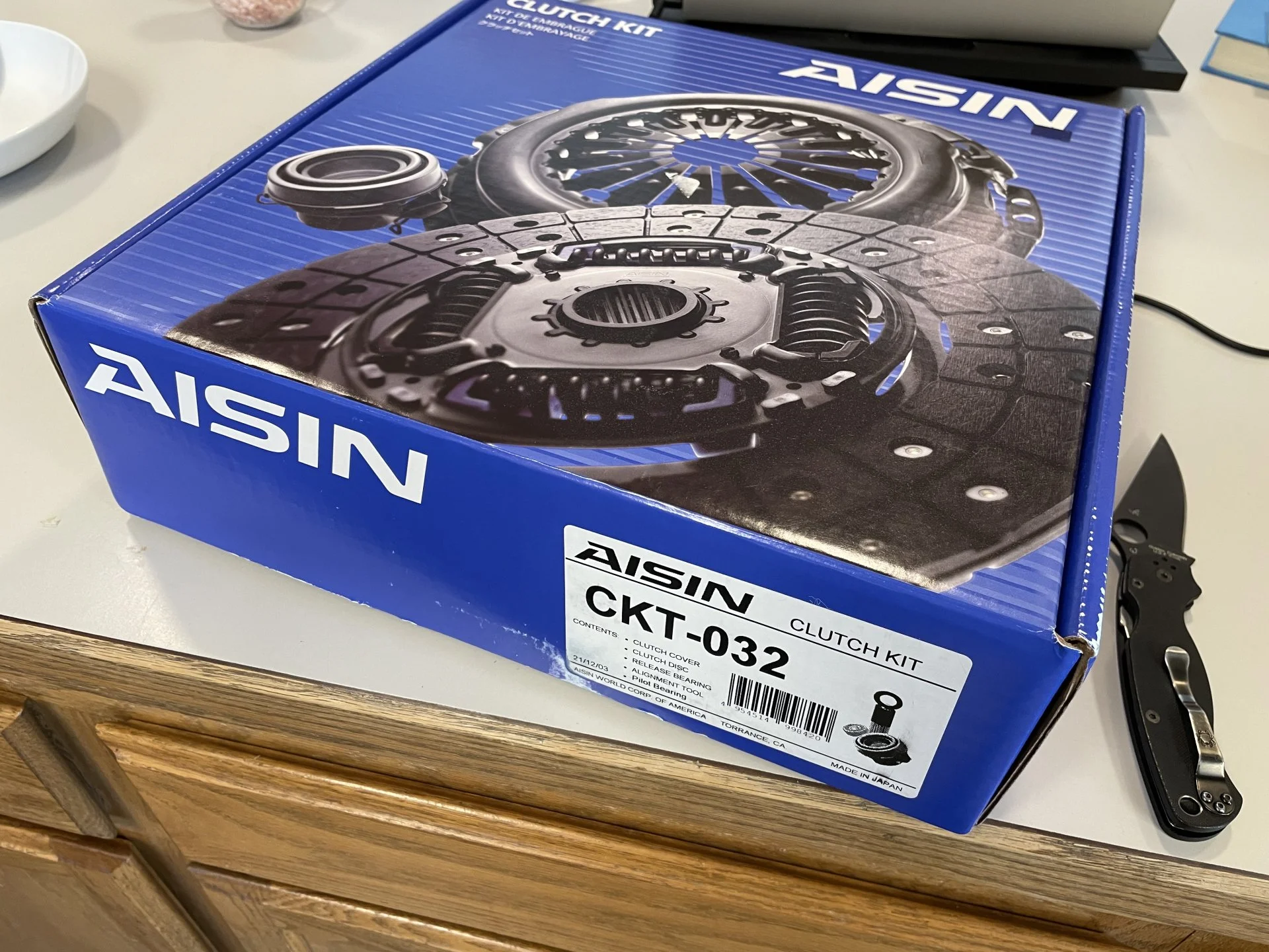

Guess I’m doing this….
That's a good first piece of the large parts pile that will be acquired to do the job! I'm hoping to do this same upgrade this year in between trips and projects.
BTW: nice Para 2. I have one with copper scales and it's great.
