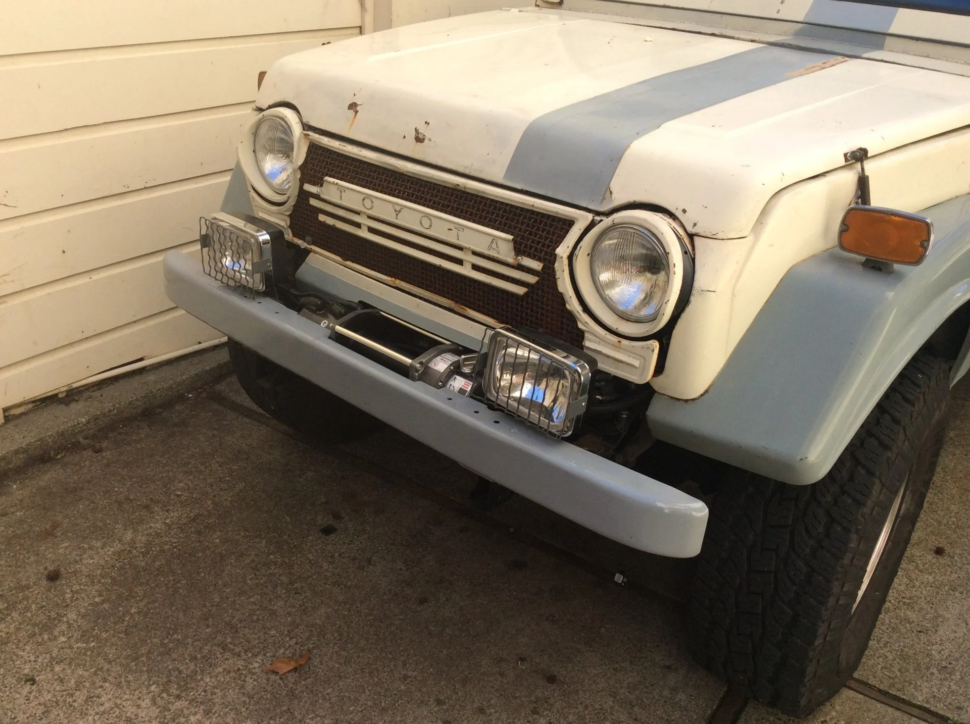

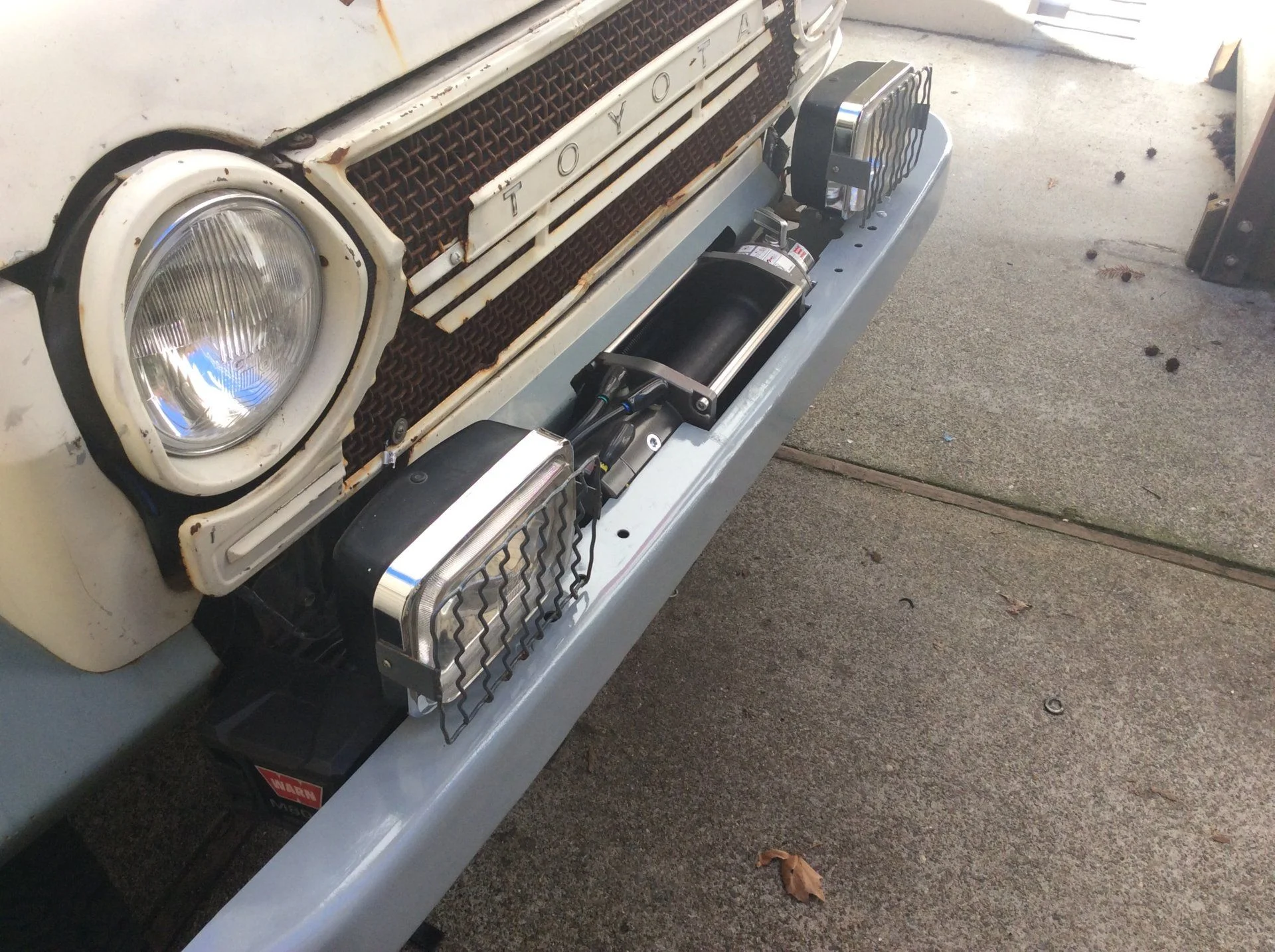

im looking for something a little ‘old school’ simple looking.....vs the more modernist Factor55 styling To fit in with my Oem 55bumper/warn winch. I think I may try to hide it on the inside of the bumper with a basic hole clearanced enough for the fairlead. Any ideas on Fairleads that are wider than 8-10” opening and might fit the bill?

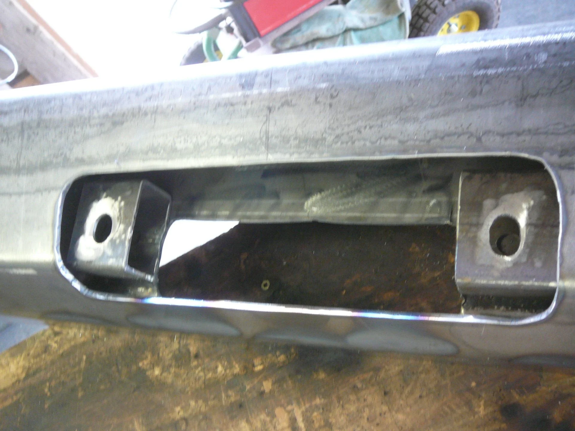

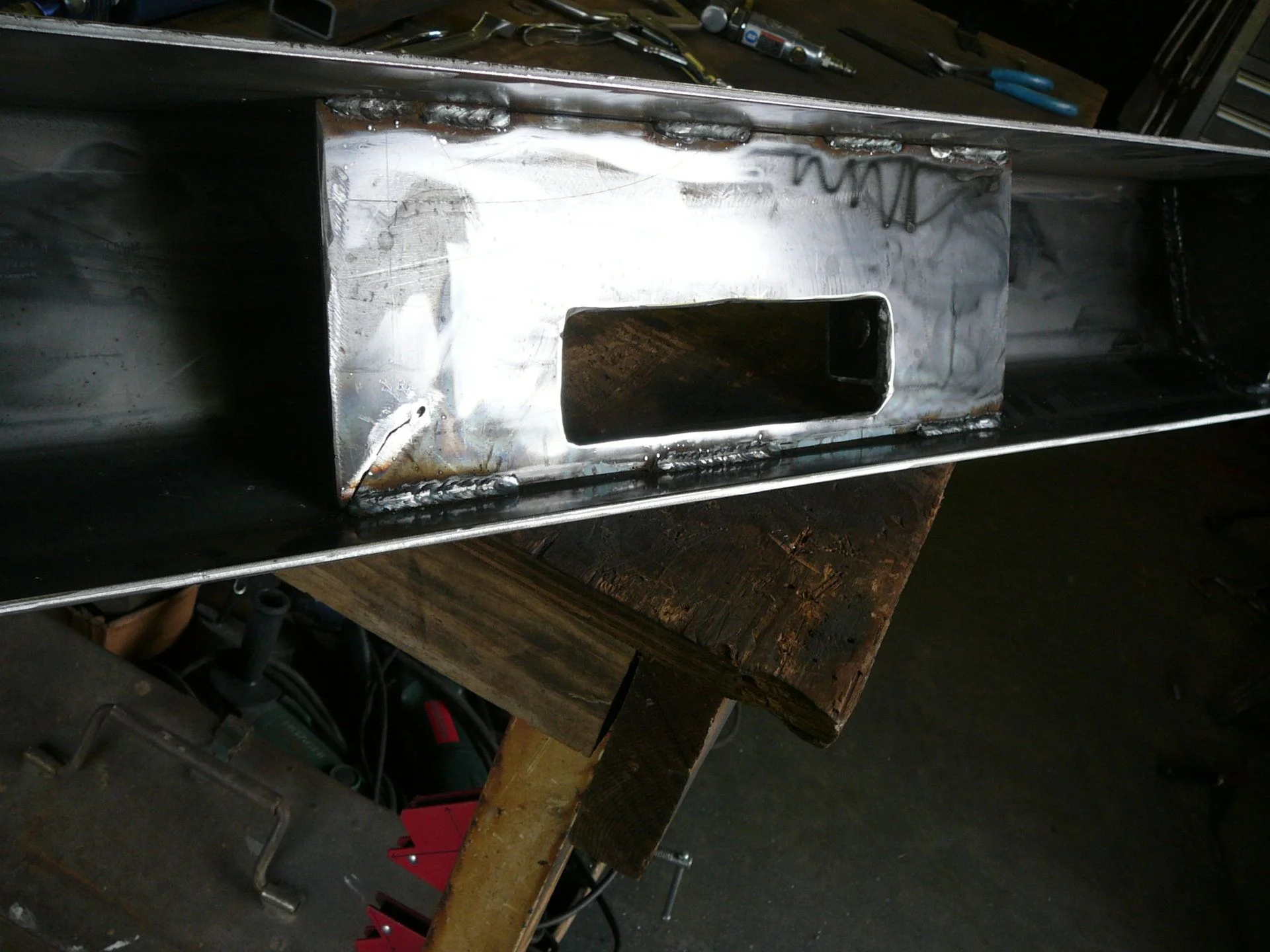

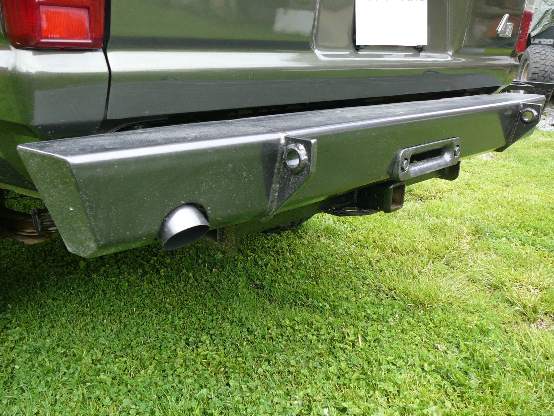

the way to go. Nice truck, I like your idea of simple and subtle. I inset the hawse on the rear bumper I made,
and I just tuck the rope back under the bumper on a small shackle.

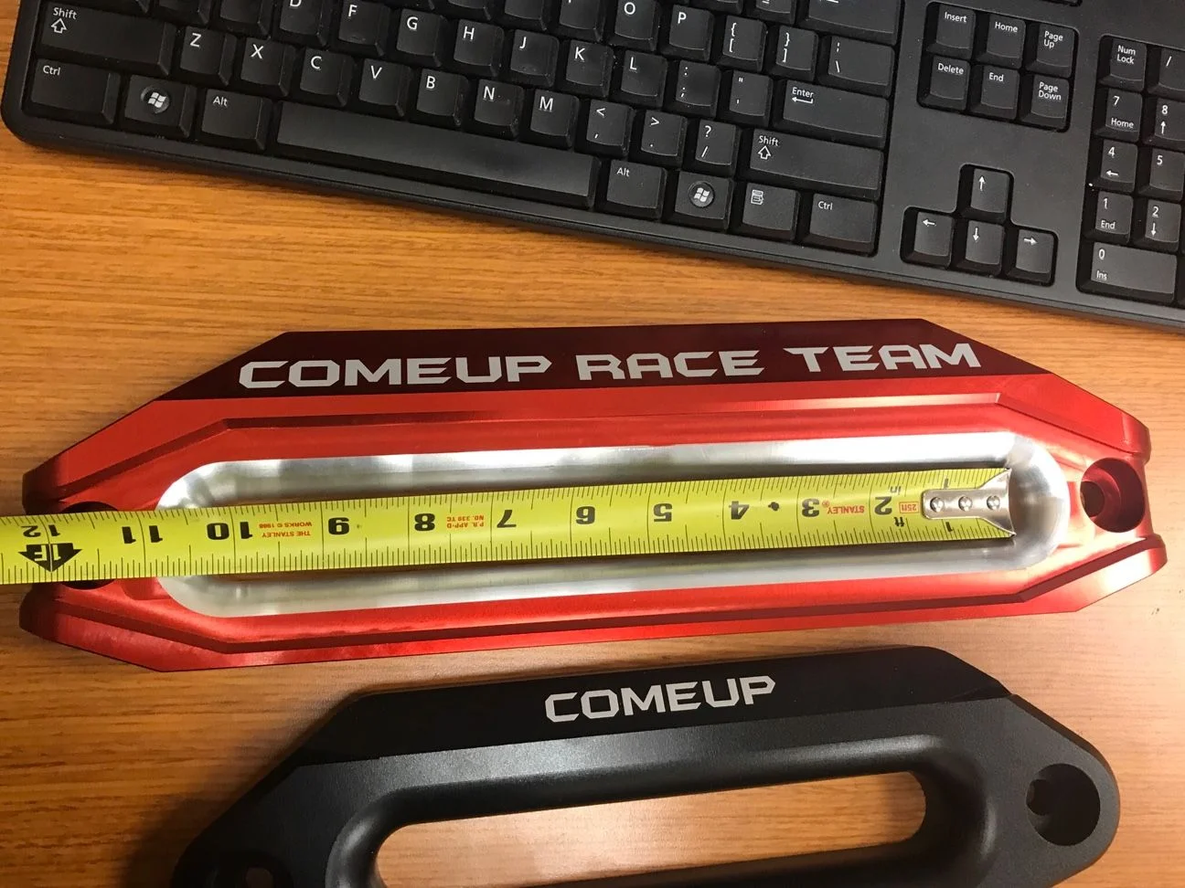

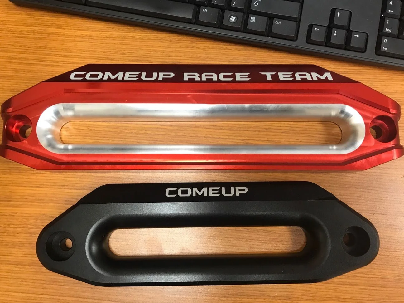

We have a wider fairlead which is designed for our Blazer winch.
Actually, we won't suggest to use the fairlead wider than drum length.

Bugsnbikes I'm going to post a couple of pic of how I recessed the hawse on the inside of my bumper.

A couple of thoughts: As the Comeup folks mentioned, it's not a good idea to have a fairlead wider than the winch drum. It should ideally match. Also, if you go with a hawse fairlead, it should have a generous, rounded chamfer on the opening as the Comeup models shown do. And regarding hawse versus roller, it is a myth that you should not use a roller fairlead with synthetic line.
