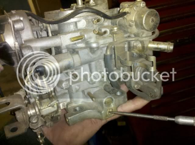

Mixture screw @ base of carb. See the pick pointing to it
Question, which way left or right is richer or leaner? left=lean, right=rich?
Turn it right (clockwise) to lean. It's been awhile since I worked with a carb, but I believe this will only affect your idle mixture, not your tune. The jets do that.
