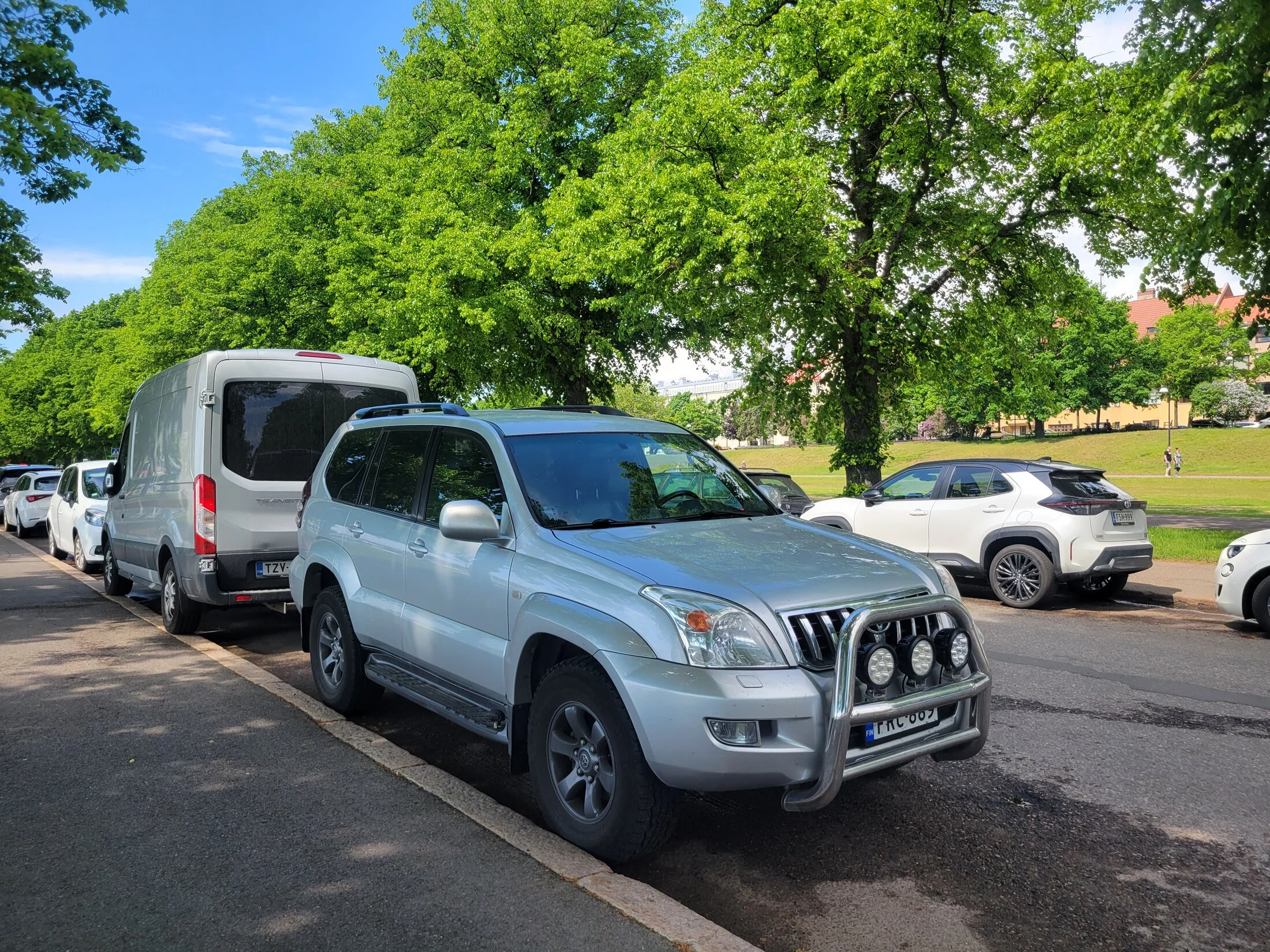

The Prado 120 has a drastically cheaper look than a GX. Not sure if it's due to the paint/finish quality, kind of fugly grille, or owner abuse due to the lower initial cost of the vehicle.
Here is one I saw in Finland. Screams work-rig for sure. Nowhere near the presence on a GX.
