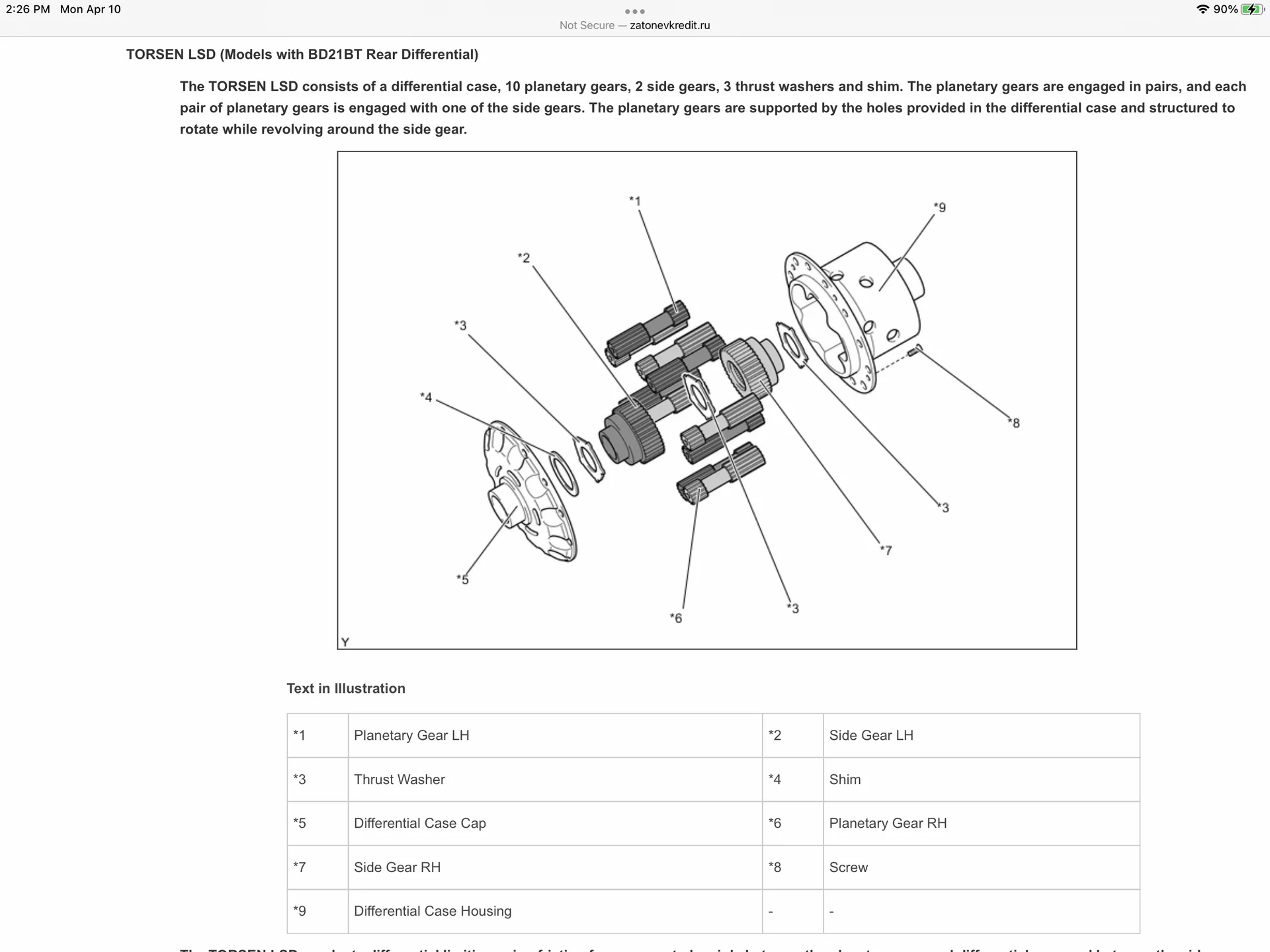

Toyota added the option of a Torsen rear diff to some late model 150 Series in non- North American markets. Part number for the differential is 41301-60200, which can be purchased in the low to mid $1k range. The complete diff chunk is also available with it, but only with 3.73 and 3.90 ratios.

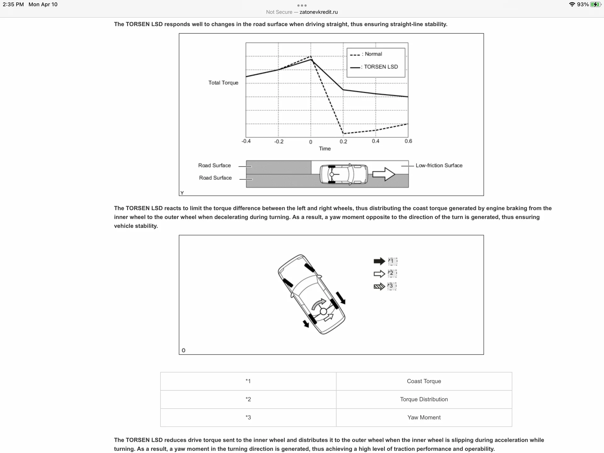

Here is a great explanation behind the mechanicals of it.
Very cool technology!
Your center differential is a Torsen-C differential.
It’s still the same BD21 series diff.

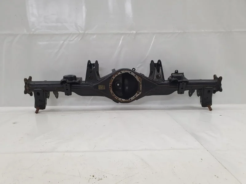

Not talking about North American model. I know they still use 8.2 diff. I ask some Australian Prado owner and the housing look a bit different. There is a bit massive trusses under the housing. I need to find that picture again.
If you go to ARB Australia, no locking diff are available for 2017+ model.
The elocker version are available. The non elocker are much harder to find.

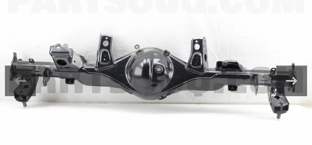

You could see the truss underneath. Makes the axle housing stronger but also can Rob ground clearance.
So the bottom of the housing to the left and fight of the differential housing are the gussets on the HD version?
