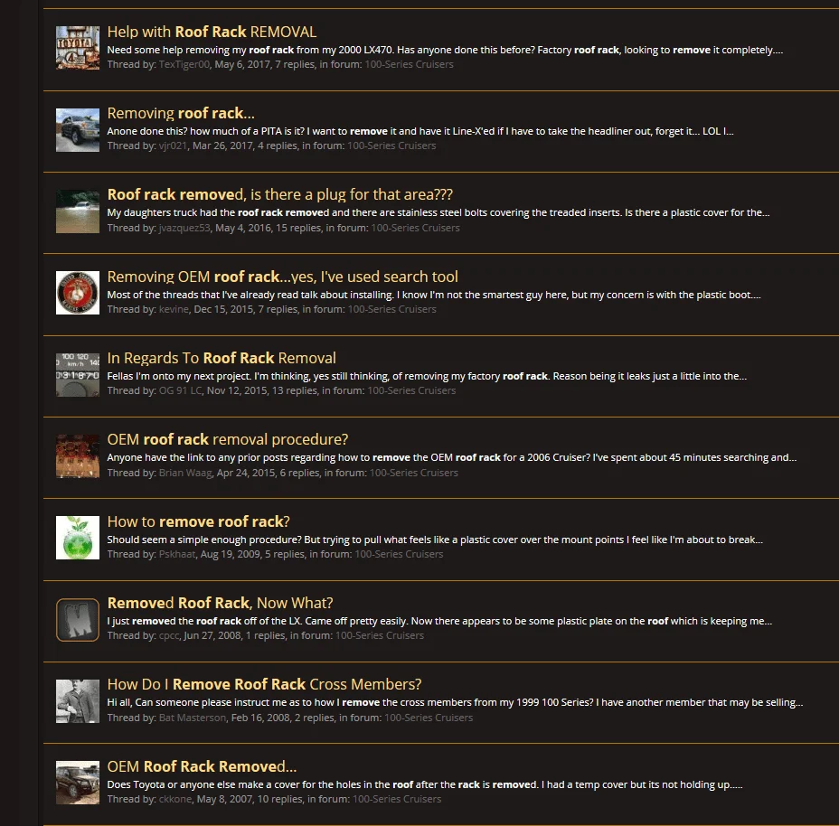

Hey all, I am wanting to delete my factory roof rack. Search bar was largely fruitless. It is causing some clear coat peel, and I just want to get rid of it until I decide whether or not I get an aftermarket rack, and which I'll get. I have seen people delete roof racks on multiple LX470s, though I noticed they have 2 feet per side as opposed to the 3 per side on the TLC. Has anyone done this, or know if all 6 blanks have the same P/N? Or are some longer/shorter than others?
