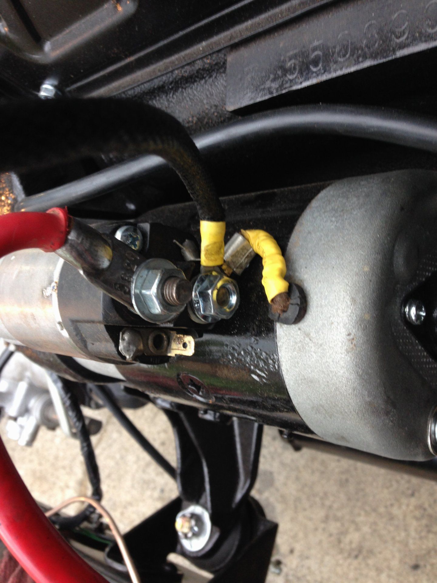

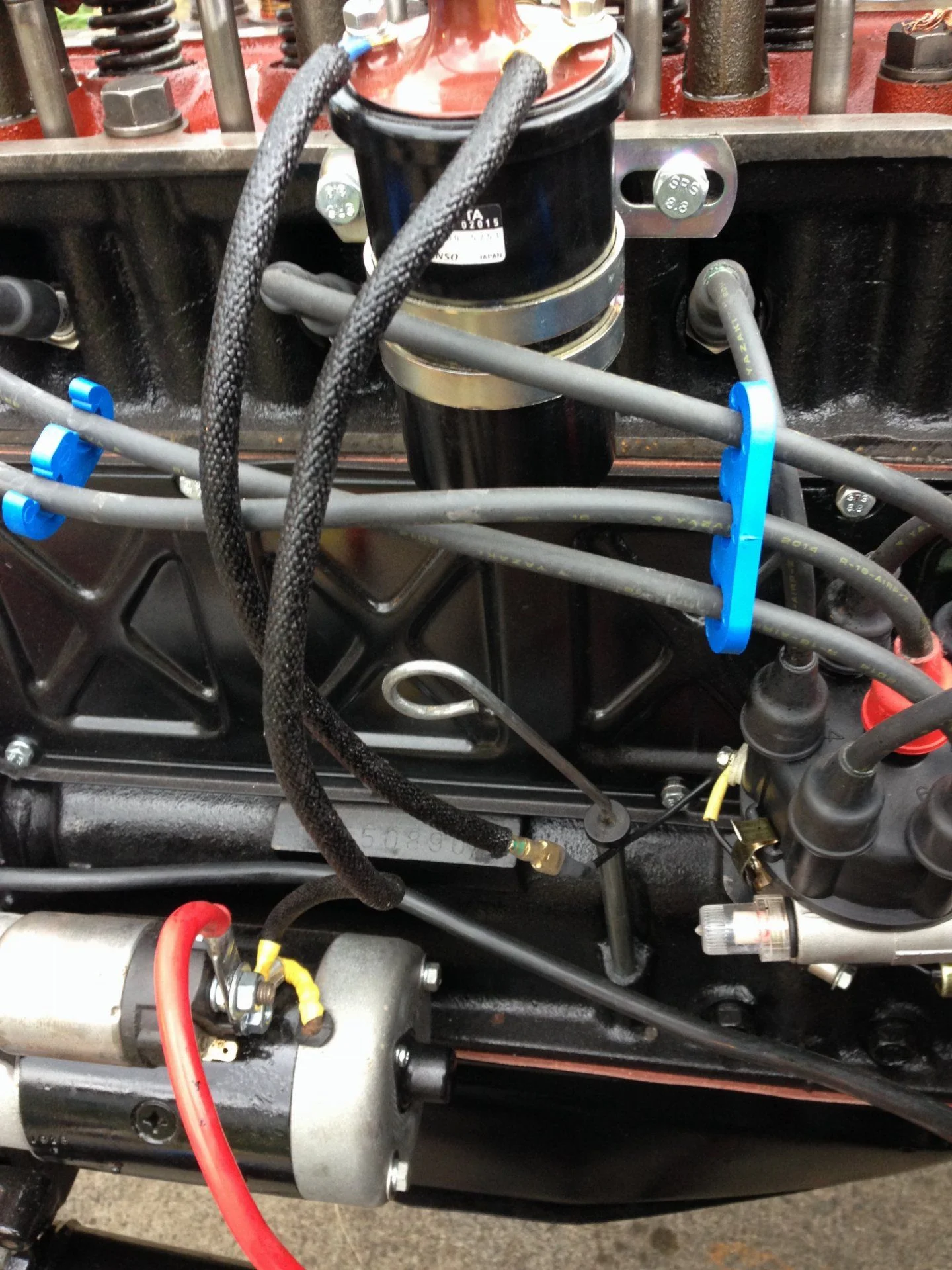

It looks to me like your + coil wire is connected to the starter motor side of the starter solenoid. If so, power to the coil goes away once the starter solenoid is de-energized.
When I test fired my F Engine (exact situation you are in) I used alligator clips to supply power to the carburetor solenoid, and to the + terminal on the coil, and then another to the flat-tab male connector (bare terminal at 9:00 in your pic) on the starter solenoid for momentary contact to run the starter. Alligator clips to be quickly removed (yanked) in case of unanticipated 'flare ups'. All of these temporary power supplies get disconnected the moment you decide to abort attempted starts or shut downs, just like turning the ignition key to "off".

My OEM coil, for my '73 F engine, needs an external ballast resistor for continuous running. I don't know about your coil.

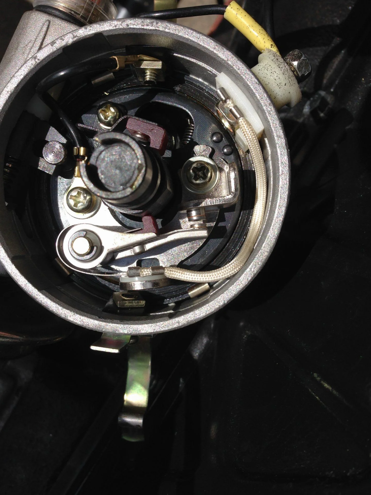

It looks like a new distributor; did you double-check the points gap? Regarding timing, while cranking I turned the dizzy back and forth (more forth than back!) until it fired up.

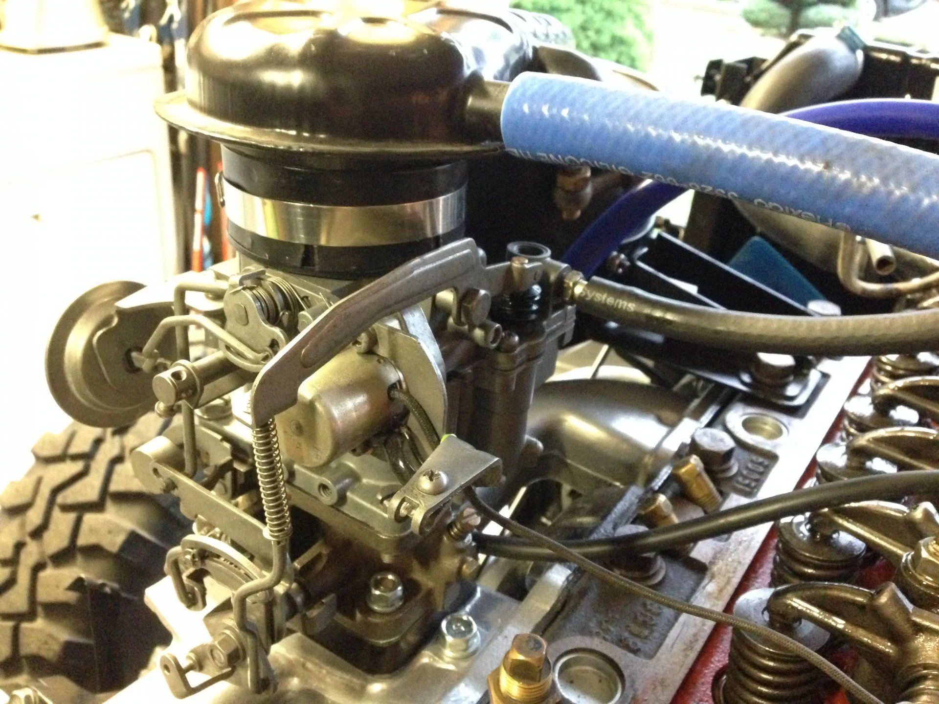

I see a bolt missing on the carb, just above your fuel inlet.

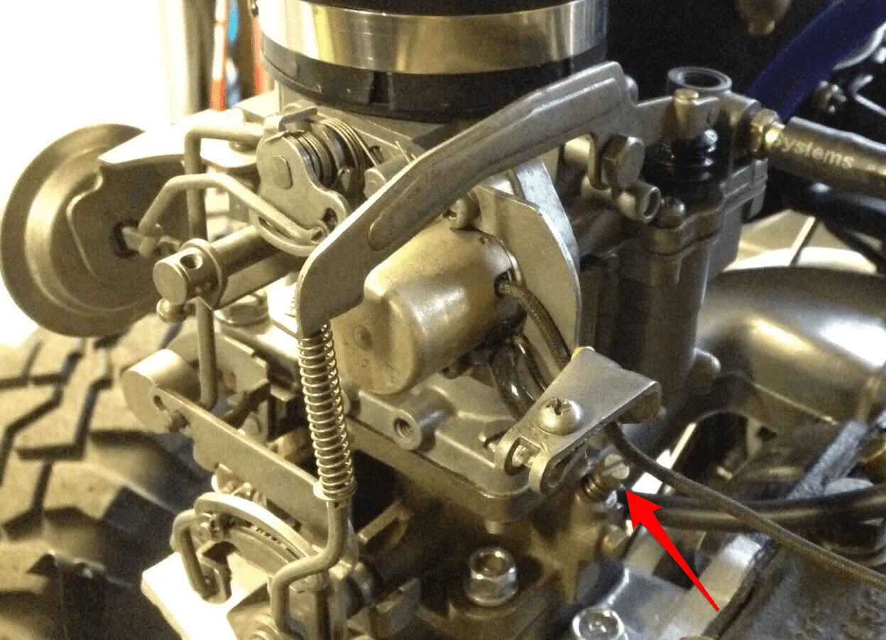

When you apply 12v to the idle fuel cutoff soleniod, a magnet retracts the brass plunger needle. This allows fuel to flow to the idle circuit. You should hear it click when juice is applied.
You should be able to see fuel in your sight glass whether the idle solenoid is hooked up properly or not. It will obviously take some extra engine revolutions to prime the fuel pump.
Everything is primed, and she fired up today! The solenoid (+) was connected to the wrong part of the starter.

points gap set correctly at .031"
It appears you may not be consulting a Factory Service Manual (FSM) regarding how to perform standard adjustments.
For instance, the "points gap" set at .031" seems to be the spark plug gap (0.8 mm) from the FSM. Typical points gap is almost half of that.
Oops, I was using the Haynes manual and confused the "electrode gap" with the "breaker points" gap. That helps.
