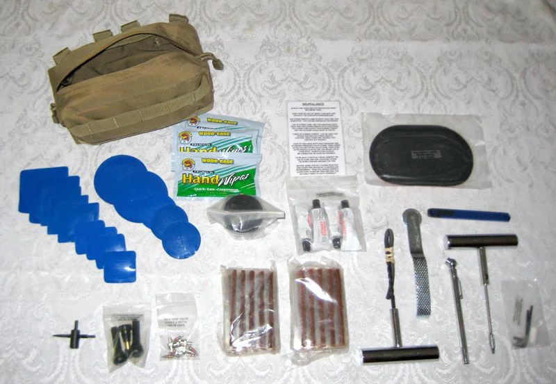

For me it was just too small, limiting really. I wanted something that would not only take care of my needs but of everyone within the group I happened to be with. So I found this:
01. Ultimate Puncture Repair Kit
This pack has everything you could need for a few dozen punctures and can probably cure everything except tread separation. The Military type pouch its in and handy although I wonder if putting it in a hard case wouldn't be safer for it all. Not sure yet.
In the set in also includes a pencil gauge which are all trash. I have an ARB deflator gauge but its home is with the CO2 stuff. So now trying to decide what gauge to use with this kit in case I need to hike the kit in and I forget the gauge. Who knows.
The price is a little steep at $90 but to be honest it probably saves you a bunch of time trying to assemble the entire kit yourself.
Anything else you would recommend to have for tire repair?
Nice kit, I like the bag. But you might want to look at the industry standard. Safety Seal.

The safety seal kit has nothing on the extreme outback kit. EO took every tire repair component they could find and tested it all to find the best possible of everything. They chose the best plug tool, the best plugs, the best patches, etc.

Yeah I think the Safety Seal One IS the ARB one. And those seem pretty specialized.

I recommend the safety seal kit for the following reason:
- in order for you to patch up the tire from the INSIDE, you need to break the bead, pry one sidewall out so that you can access the hole. Then using a die grinder, rough it up a bit and then apply the seal from the inside. Then, you need to put the sidewall back inside the rim, set the bead using LOTS of air.
Most of us don't have this ability to do this on the trail or even in our garage. So, paying the extra $45 for materials that you can't use it pointless to me. All we're going to be able to use is the plug kit which is essentially what Safety Seal provides.
My .02 cents.
