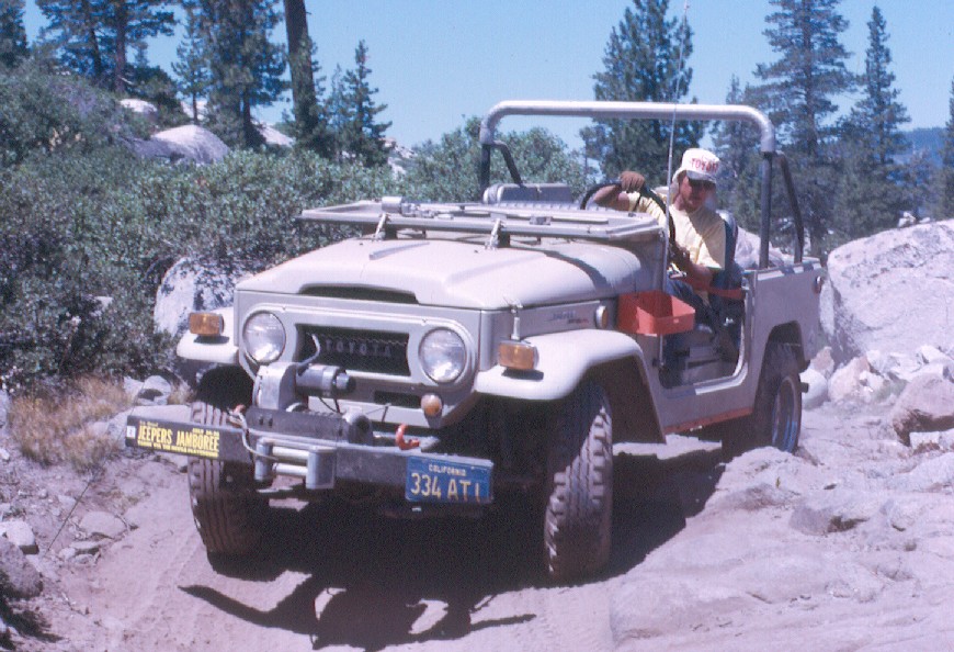

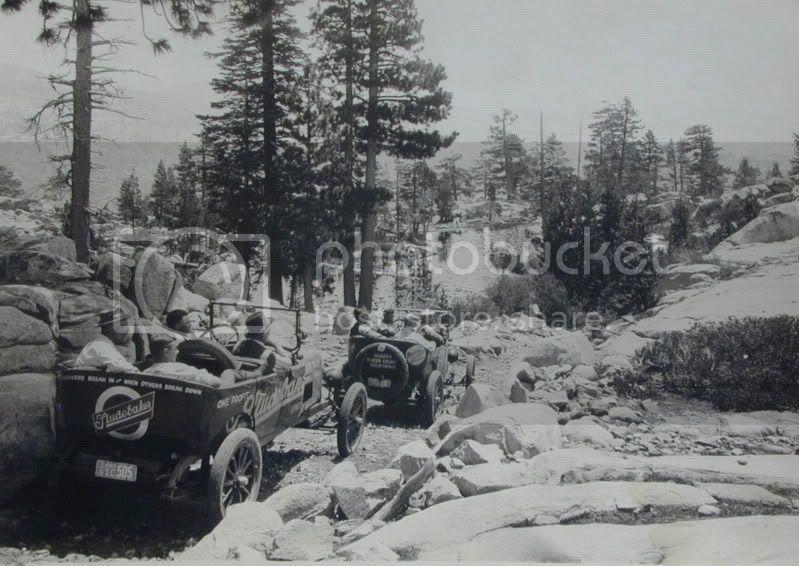

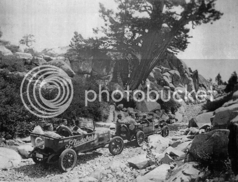

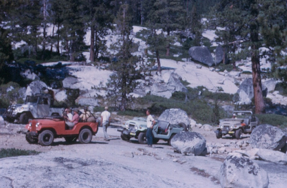

Consider the Rubicon, do these guys think all the magic fabricated crap that they're building was around in the '70s?
The Rubicon Tr was very different in the '70s and even more different earlier. It was originally run in 2wd cars on wooden rims (originally a wagon road). Every time someone runs through there it gets harder.

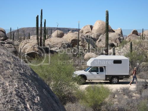

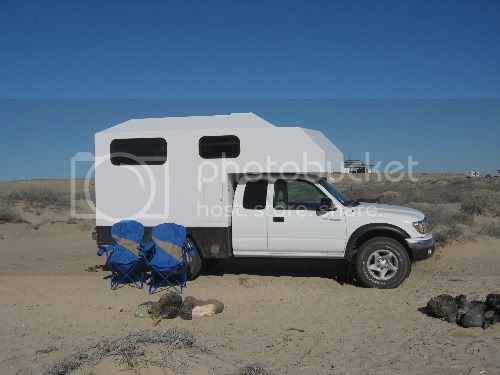

FWIW, I would build something very similar to this:
I'd build it on a 4door tacoma with a TRD rear locker and leave it mostly stock.
The beauty of this one is that it was built out of polypropylene honeycomb panels. I'm building a sailboat in more or less the exact same process: PP honeycomb core with fiberglass/epoxy on each side. It's about 1/4 the weight of plywood, well insulated, waterproof, and stronger. AND.... the best part is that it's also cheaper than marine plywood. A sheet of 10mm PP is only around $30. That entire camper when empty probably weights under 300lbs, probably less than 200lbs, but I'm not sure what the doors and windows add.
Anyway, this is all stuff anyone can do in their home garage. And I think it would make a more capable and comfortable expedition style vehicle than a typical SUV plus trailer combo.
Here's a link to the blog. The Super Camper
That's pretty slick! Sounds like it would be good stuff to build a hard-shell roof rack too.
