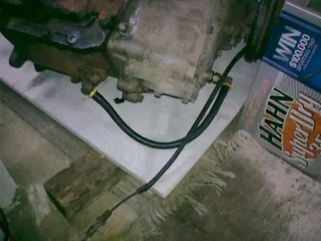

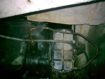

both mine have a return line from the transfer to g/box. ill try snap a few pics for you guys.

i remember seeing some mods to level out the tranny and transfer case fluid levels if the seal is bad. Anyone know what that's about? Better to just drop the setup and fix the seal?
i think you have actually moved on to replacing seals but here is an aussie solution for the bad gearbox-transfer seal.... HTH
TOYOTA LANDCRUISER GEARBOX "FIXIT" KIT. - eBay, Other Car Parts, Accessories, Car Parts, Accessories, Cars, Bikes, Boats. (end time 28-Dec-09 15:02:00 AEDST)
flexible silicone hose type
solid copper pipe, that i have damaged during the motor/transmission swap :(
