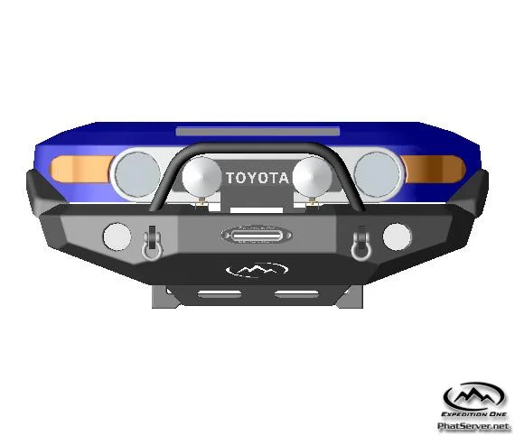

You might have just sold me with this pic:
When it comes out will it be with fairlead or will that be optional? One other thing, what will fit in the holes for the lights?
Great work! Looks awesome and lovin' the logo on the skid. Mine would be with just the 'A' bar FYI.
If you won't to get one of the fairlead from us you can. There aluminum, designed for use with synthetic rope. We also will have, & do have, a synthetic winchline that works with the fairlead.
For the light holes we are going to have 2 or 3 different option (so far) one is a basic driving light. Nothing fancy, and it would be reletivally inexpensive. Another would be a fog light, again nothing fancy. Then the other option(s) (the preferred option) would be PIAA 510s either in fog or pencil beam... Or you could just figure out your own thing. the hole size is a bit over 4 inches....
Also the design you have referred to has changes just a bit.
attachment.php
Mostly just the "A" hoop shape has been widened so the classic Toyota logo can be viewed....
