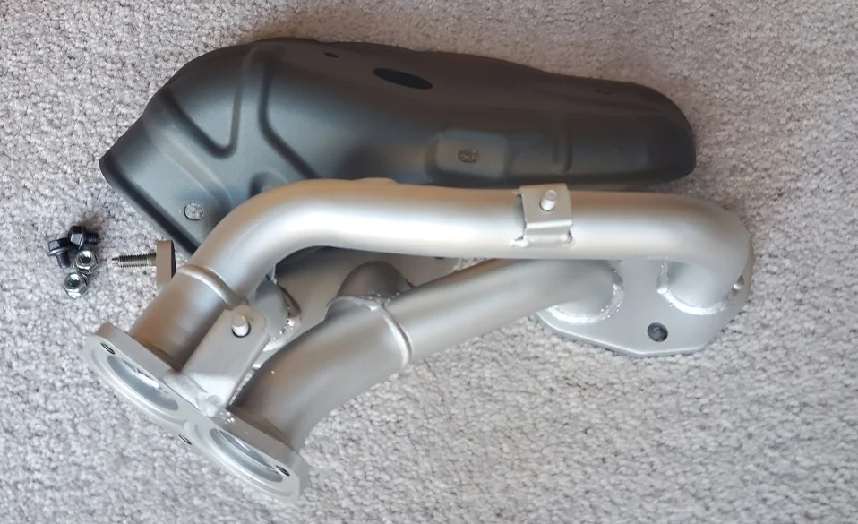

What is the move with the stock manifold? Is there a high-temp coating that is preferred to clean it up and make it look nice?
Ceramic coat it. Here is a picture of my 3RZ manifold and heat shield. You might consider taking the manifold to a machine shop and make sure it's flat.
