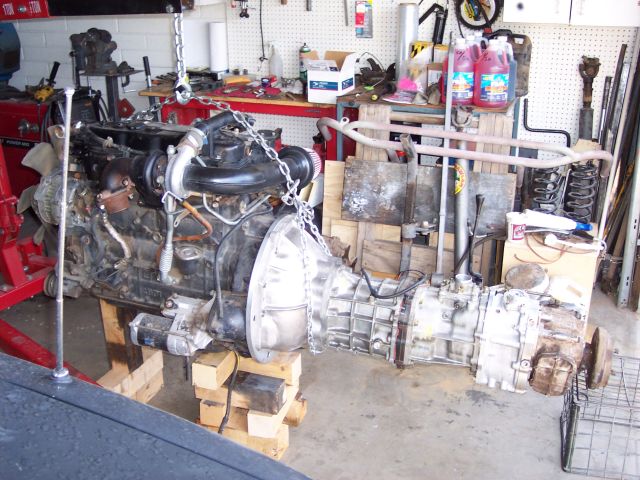

overall shot of new drivetrain:
engine, dieselswapper adapter, AAbellhousing adapter, 5 speed, 4.7 toybox, and 4 speed case.

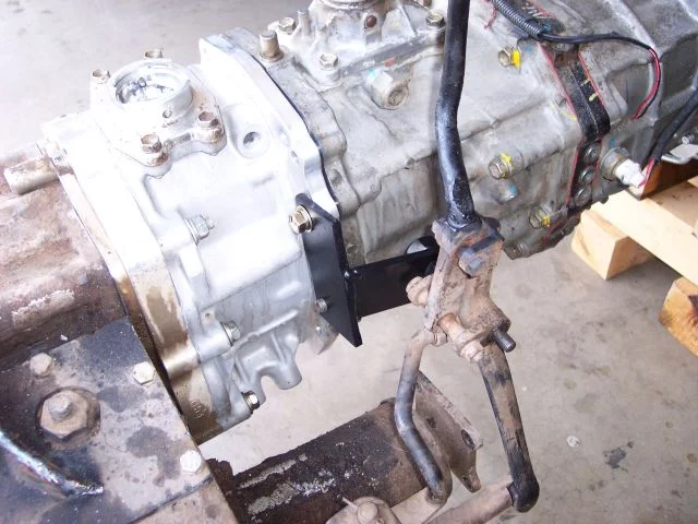

and a shot of the bracket i made for the tcase shifter, as you can see it will come up next to the tranny shifter and the toybox shifter right behind it.

looks great...glad that thing is goin in a 55.
if i put that combo in my 40, i could use the tcase as a rear bumper, ha ha
haven't read up much on the isuzu...i assume the "T" in 4BD1T is for turbo? are you goin to toss an intercooler into the mix as well?

yeah i wanted the length, F/R driveshafts are the same length now so i can carry one spare for either end.
intercooler is not high on the list, its a solid maybe.
just for reference, the oil pan gasket is level with the bottom of the frame in that pic, the engine is now 2" higher in its permanent locale, lots more vertical room than a cummins. and before anyone asks, i'll be posting a few more detail pics shortly.
Cool man..! I forgot the details of your adapter again.. It is a Isuzu Diesel Swappers ring and then which bellhousing? How did the clutch disk setup go, the Isuzu clutch and the Toyota R151 disk, or were they all the same spline count? Killer man! Andre
yeah diesel swapper ring, AA bellhousing to mate SBC to tranny, chevy flywheel, centerforce pressure plate and special centerforce disc for chevy clutch w/ toy splines. clutch fork uses landcruiser clutch slave. pretty cool set-up i guess, would have been nice to be all toyota but oh well.
if you get a chance have a read at some of my posting on the isuzu thread, i went into a bit of detail on it, i didnt post pics of the adapter part cause dieselswapper has great pics on his site. basically its both flywheels with a spacer in between to make up the distance. i took them both to a machine shop and had weight taken off where i could, ended up just over 43lbs total flywheel weight.
its a little long, but with the doubler and other things its not bad. closeups of engine gearbox adapters? well, i only have one adapter, the isuzu swapper ring and i didnt take photos of it cause his site has as good a pics as i can take.

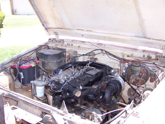

couple more pics, engine is in its final resting place. not the best pic i know, sun is going down over the house. just getting something for you pic hungry wolves to look at:flipoff2:
i kept the oilpan about the same height as stock 2F, you can see how much underhood room i have.

Hey Rhino, this is great. Thanks for doing the hard work so I can come in and do this myself.:D I have read the other postings but I still have some questions. I may have read right past the answers but Ill ask anyway. I see you list the entire drivetrain but what 5-speed is that? The HP ratings are about the same as a 2F with more torque of course, how do you think it will move a pig down the road? Where are you located? If you are close, Id like to take a look at it. If not, I hope to see you at Surf-&-Turf. I am having a baby in mid November so I may not make it this year.
