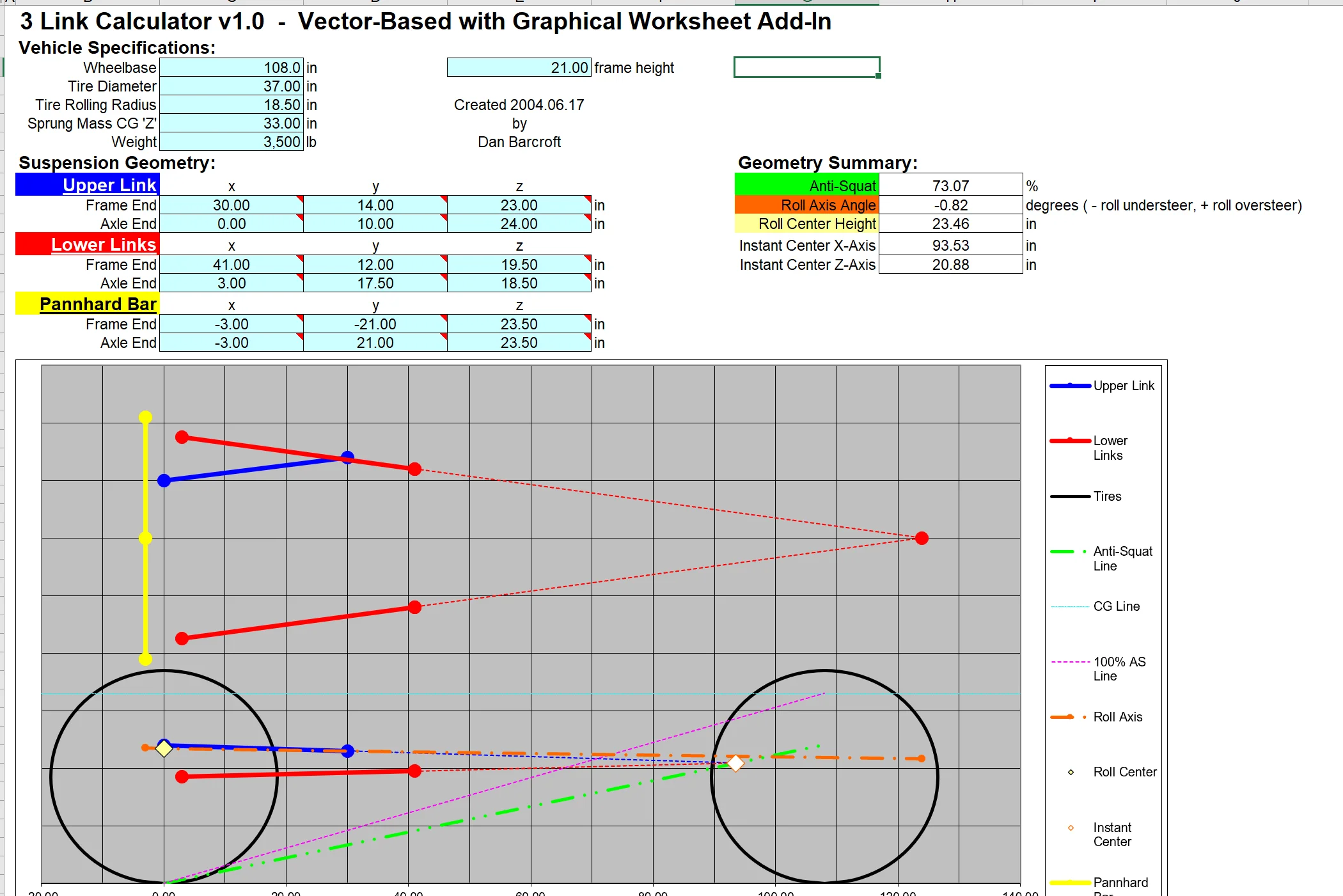

85 axle. IFS hubs. 17x9 3.5BS wheels with 37x12.5 tires. 21" frame height
3 link front, 38" lowers and 32" upper, 2.00x12 CO, summit joints, cut whatever I have to for 4" up 8" down
36" Trailing arms with triangulated 4 link rear with 2.5x14 CO

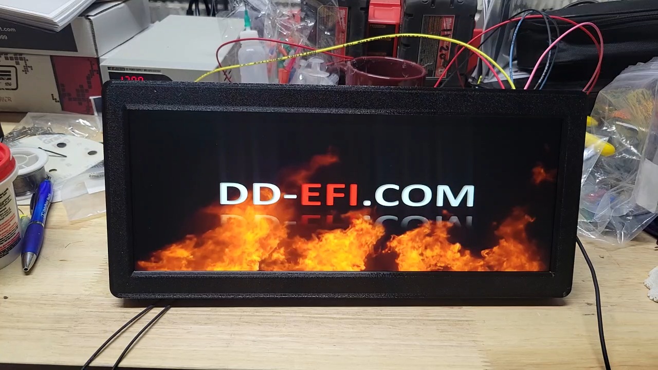

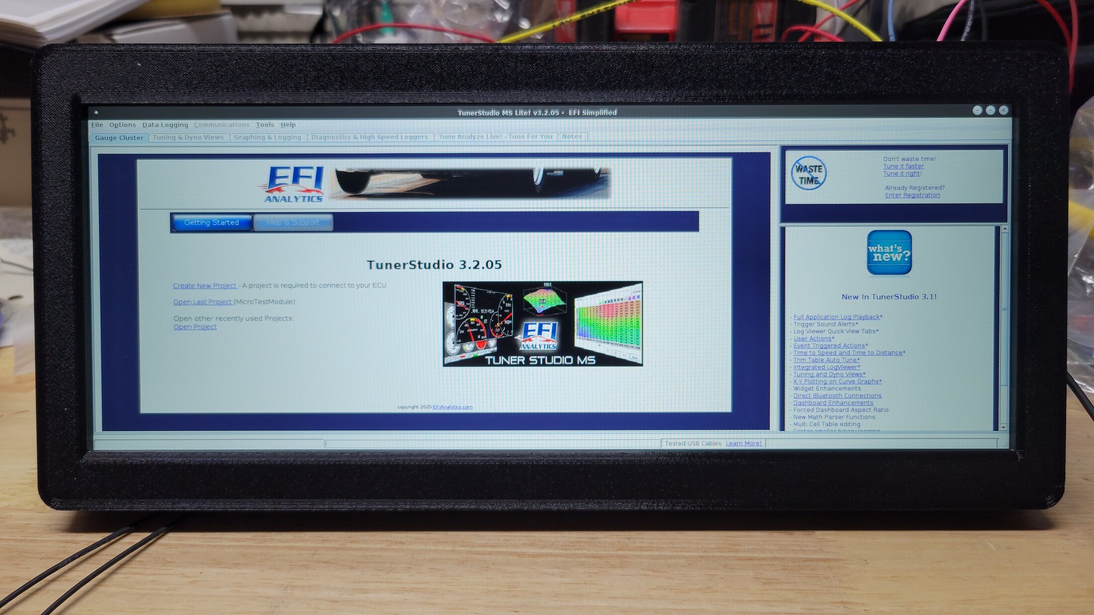

I've been eyeing them for a while because the MS2 has such limited analog inputs, so I finally caved and bought a DD EFI Pro digital dash.
Uniclutch and digital dash install coming this spring between diaper changes

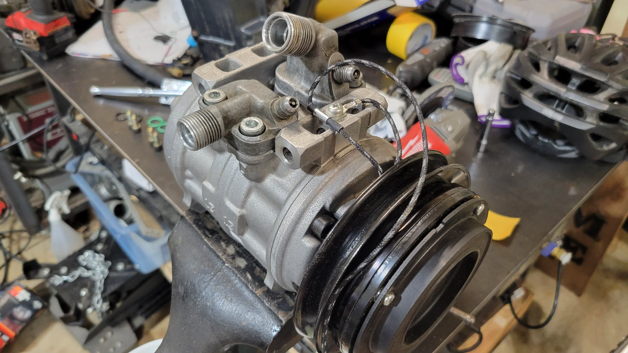

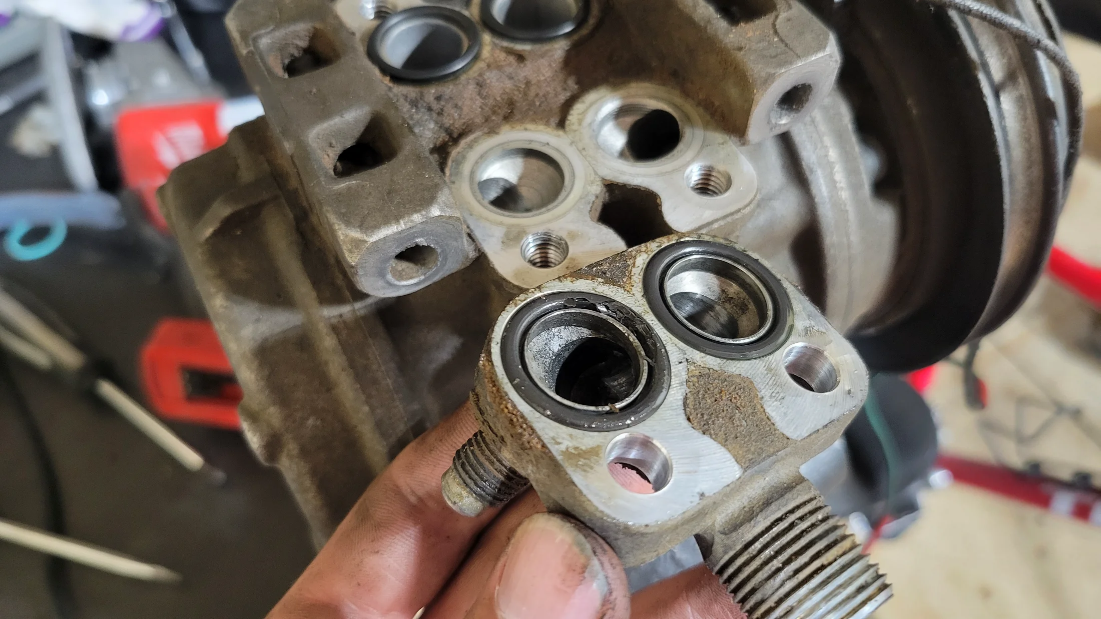

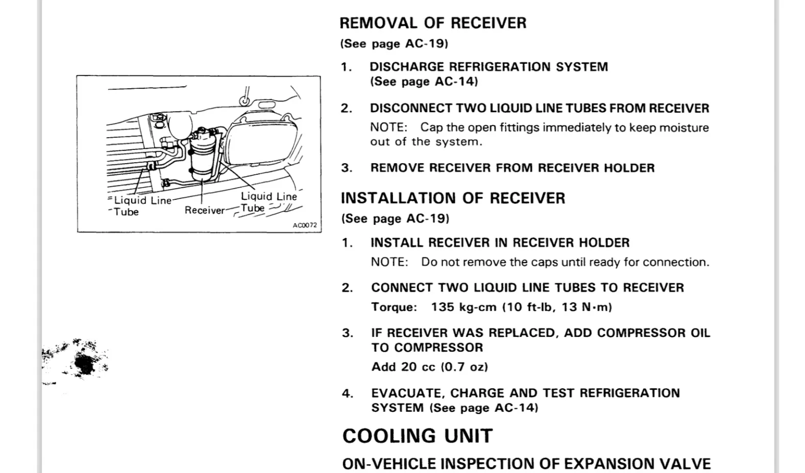

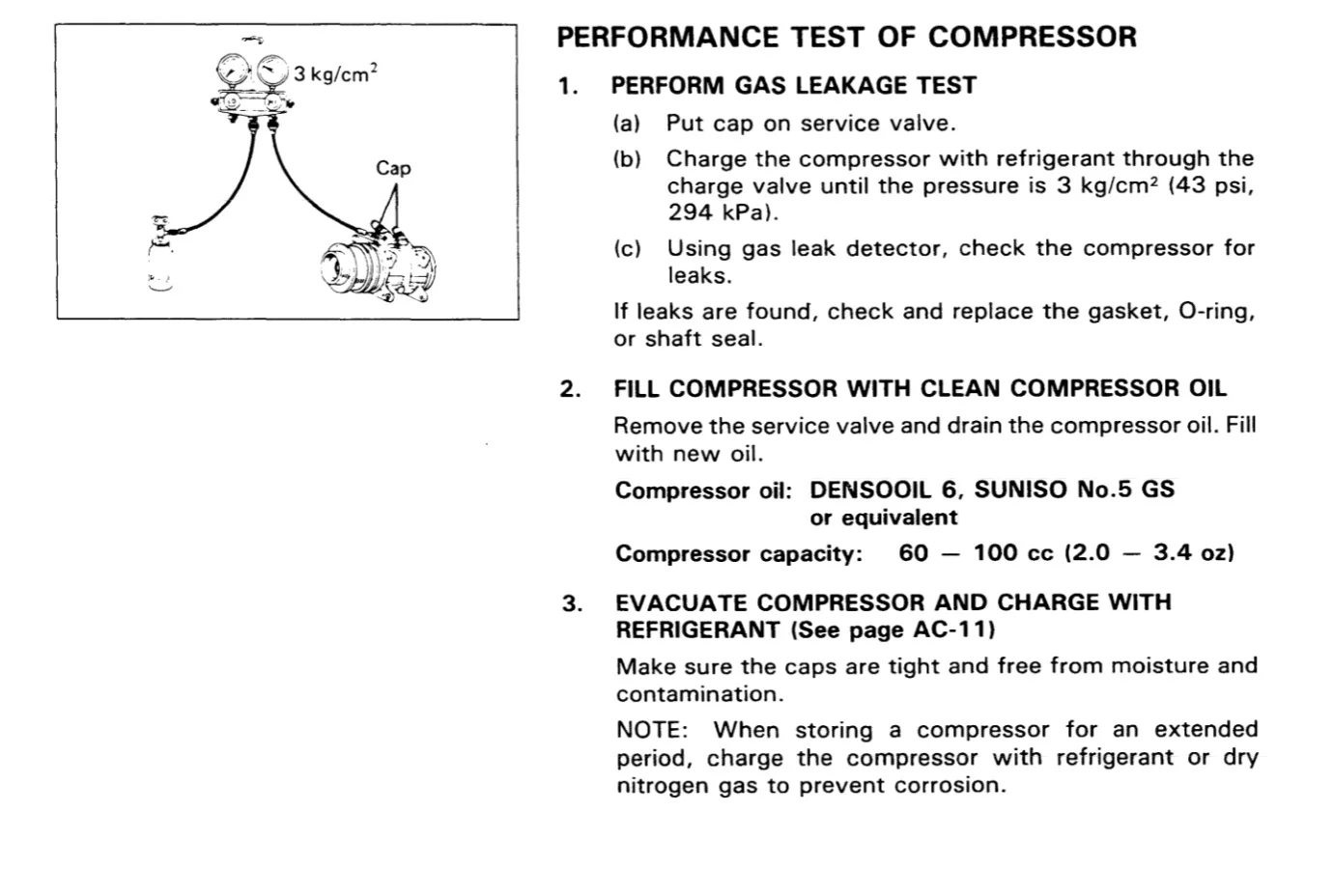

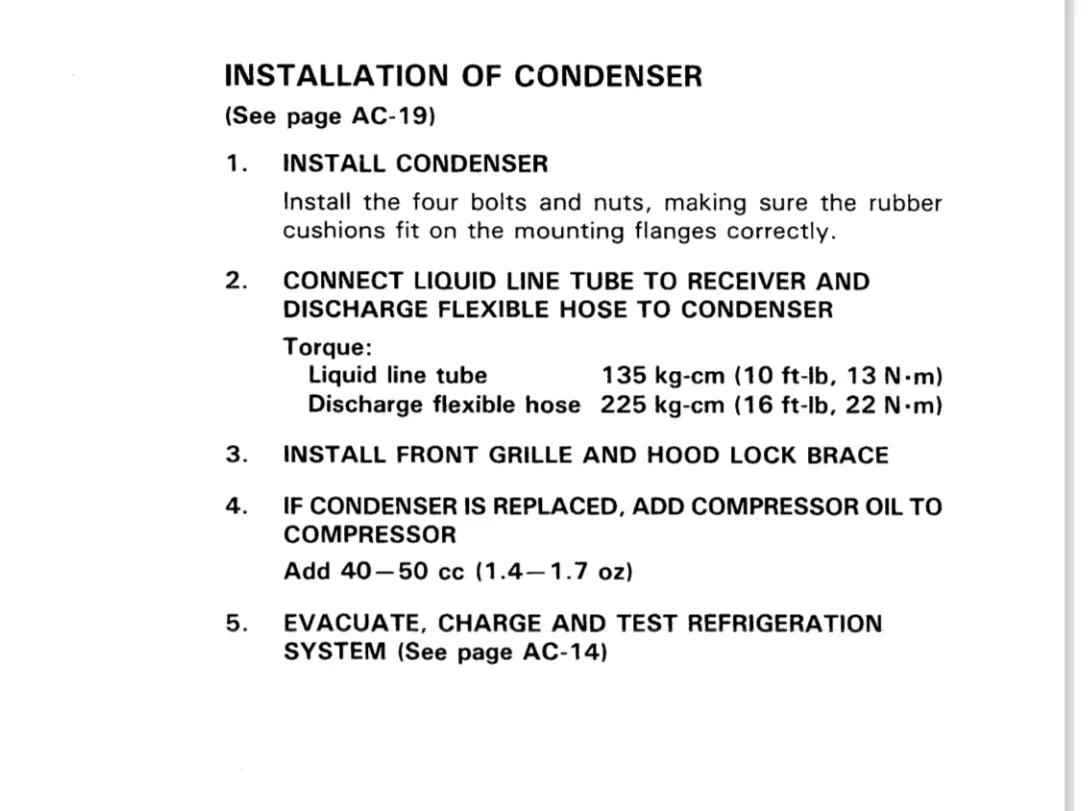

First on the list is air conditioning, tried to charge it and found leaks. Ended up just refreshing the whole system. Still in progress
Reman R12 Denso compressor and instructions from the 1985 FSM

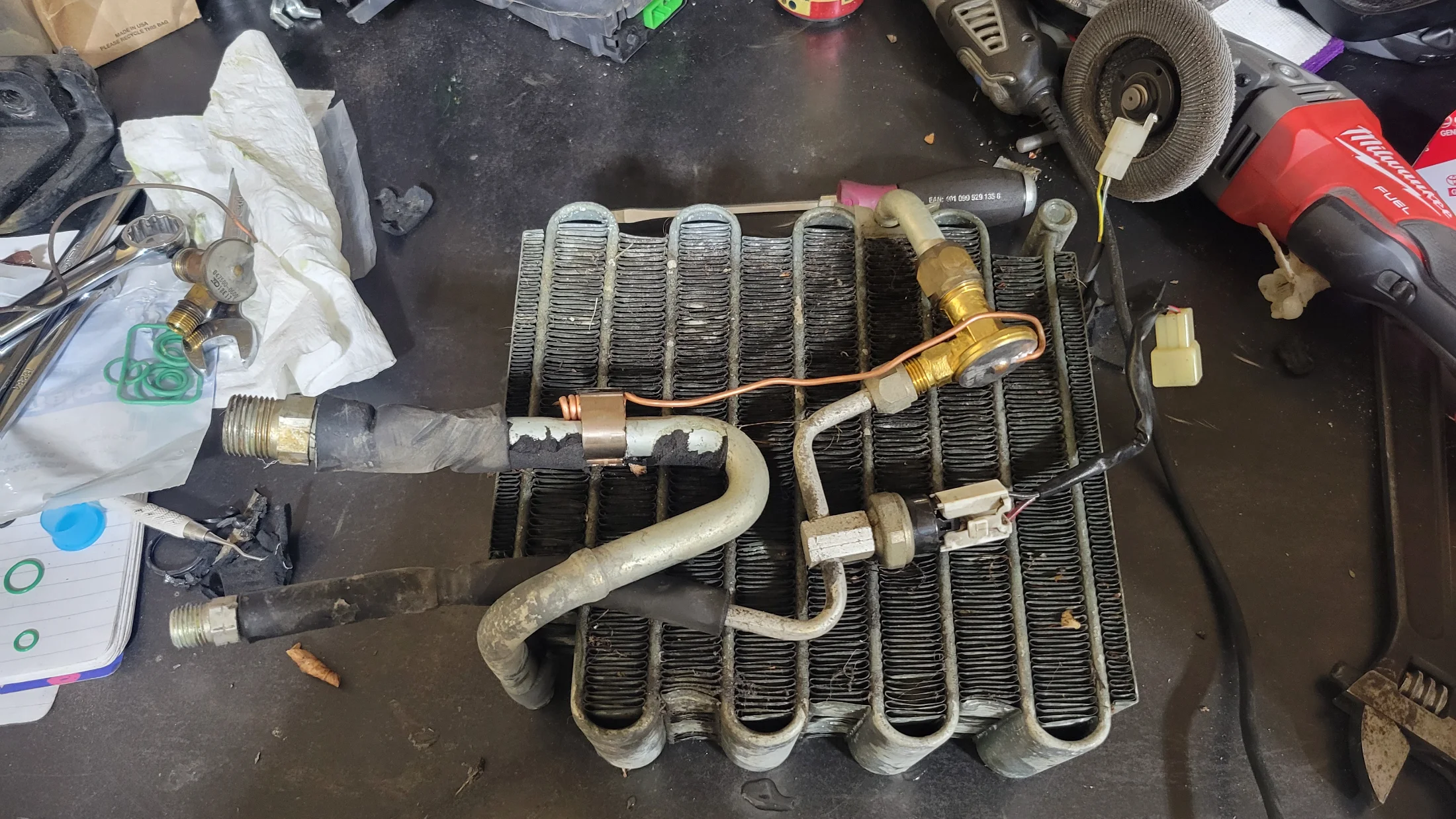

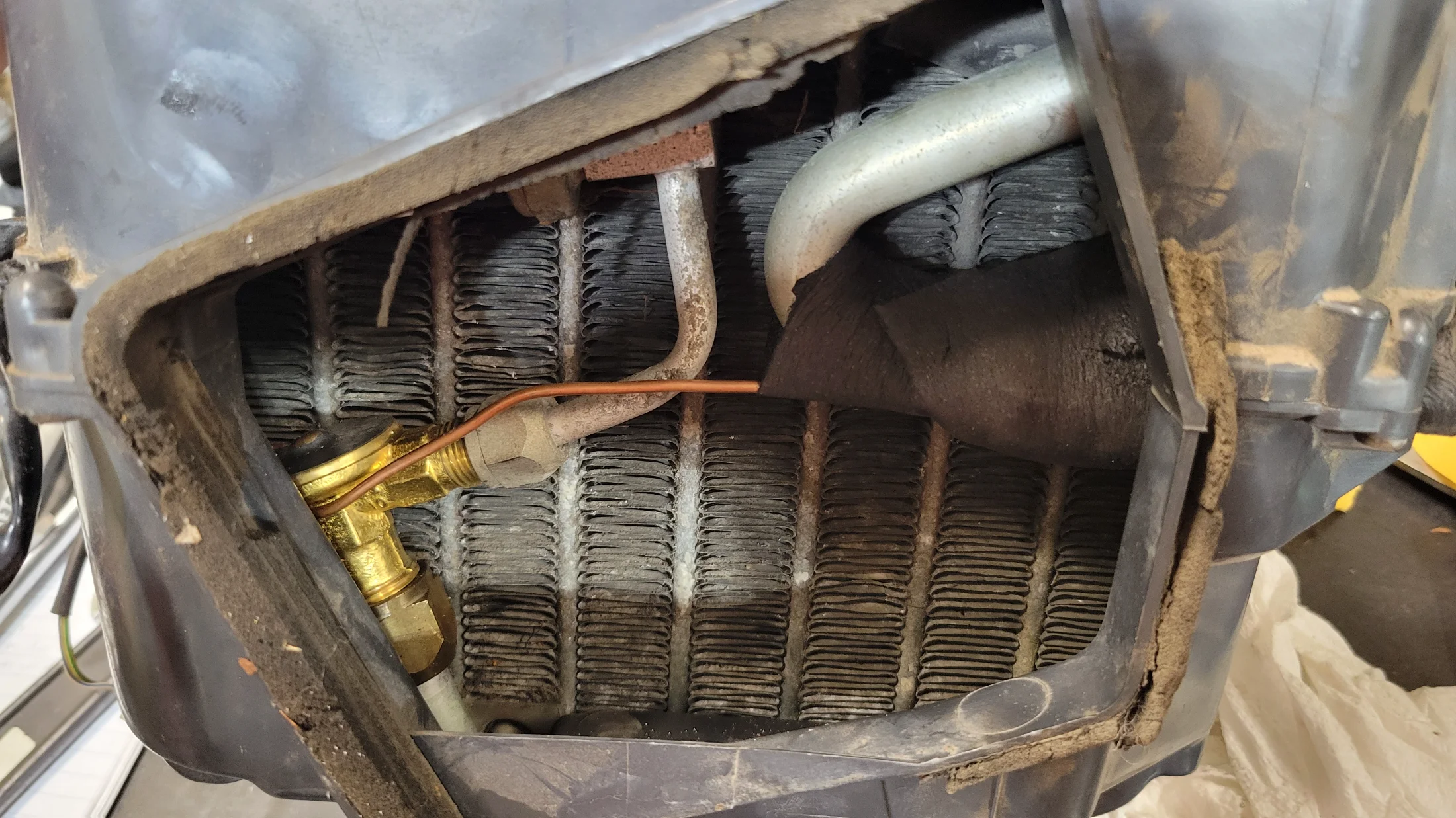

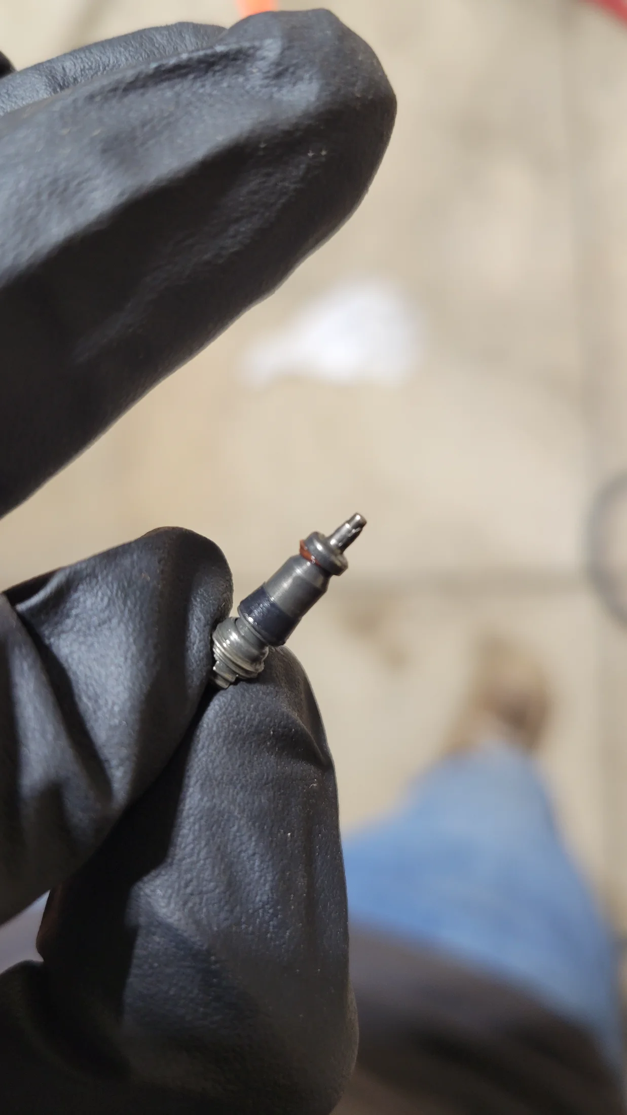

Evaporator box back in. Waiting for r12 compressor oil and new valves then it will be ready to vacuum leak test and R12 charge. I've thought about wiring a small pusher fan to the condenser and triggering it with the AC compressor switch
Pretty much everything has degraded

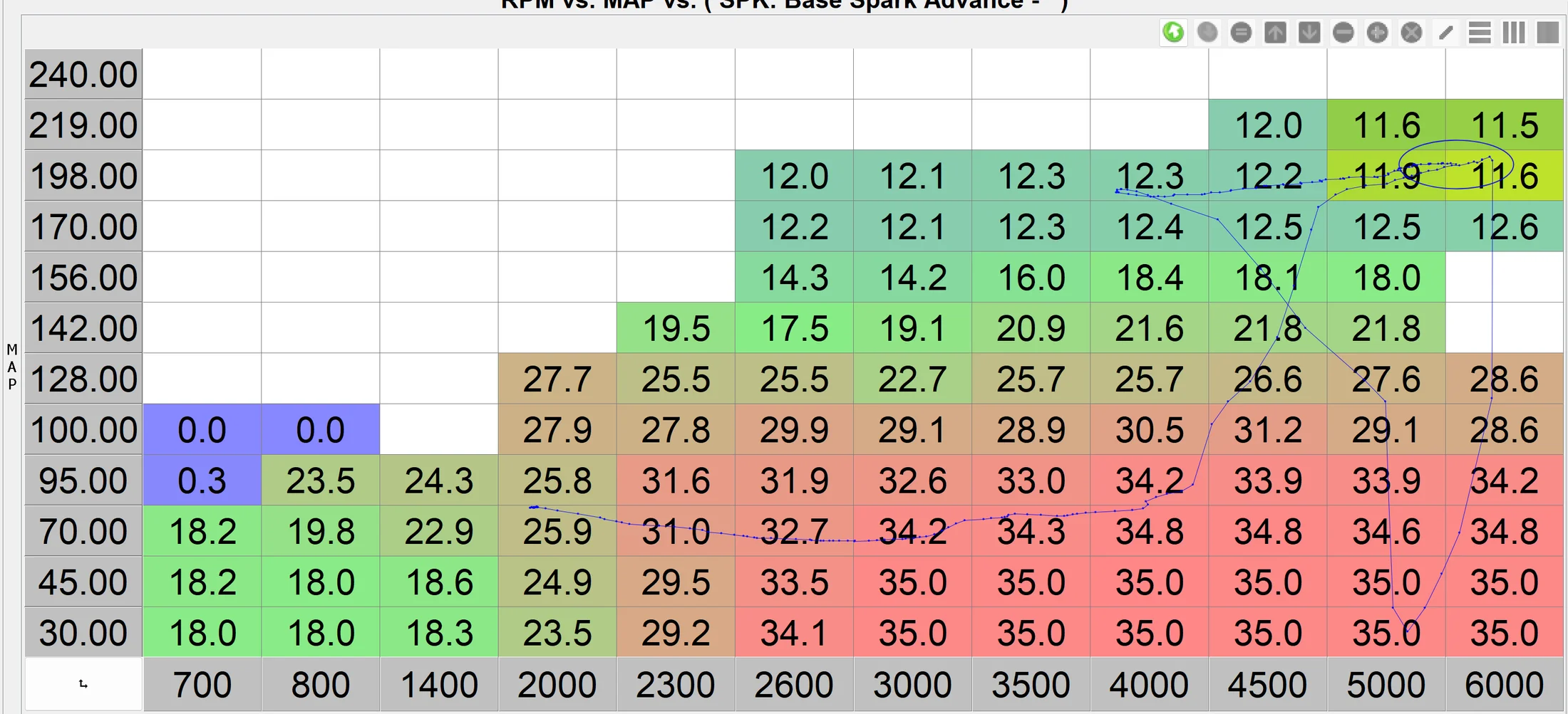

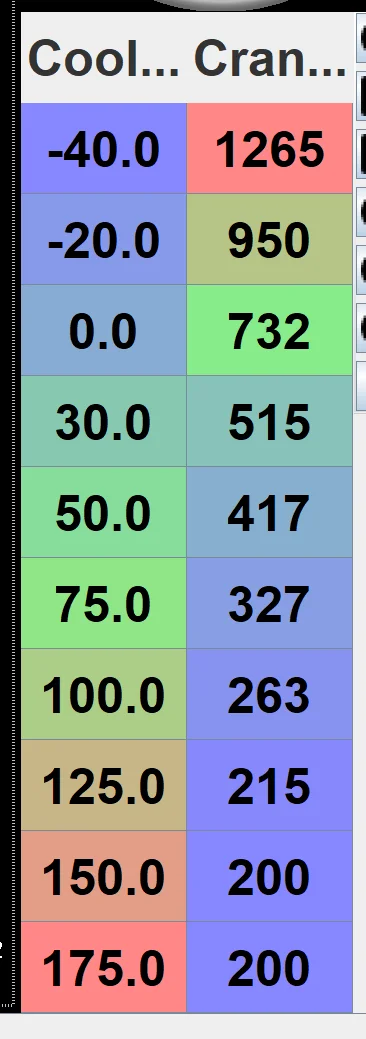

I was also playing around with megasquirt idle settings and now have timing adders based on target RPM. I'm curious to see if the compressor kicking on will hold idle speed with the timing advance

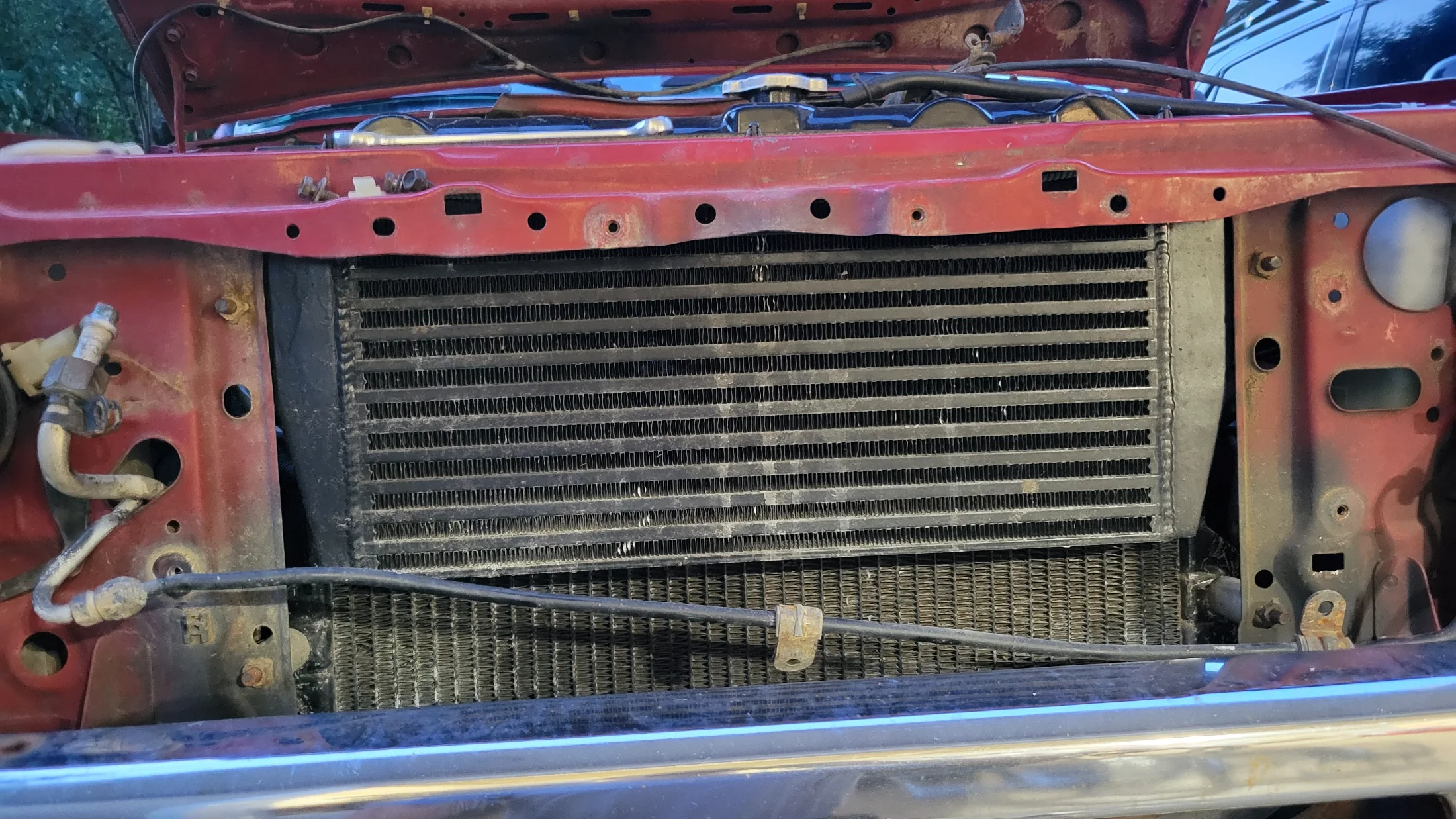

I see you have a more modern parallel flow condenser installed. Looks like the one I put on mine. I'm in AZ and I didn't need a condenser fan even with the original serpentine condenser. It couldn't hurt though. May lower your high side pressure. The new style condenser did lower my high side a bit. I don't remember how much. Maybe 10 PSI?? I'd have to go back in my build thread and find what I posted. I'm also running R134A so your system will probably be colder.

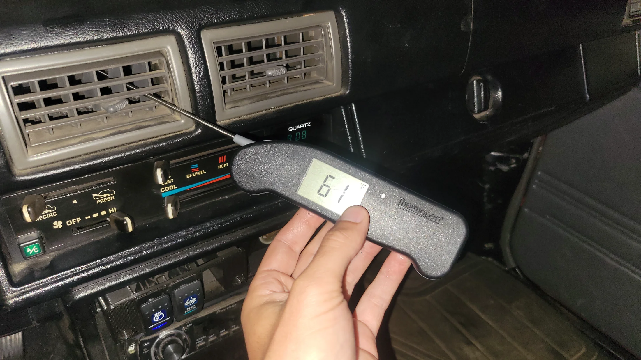

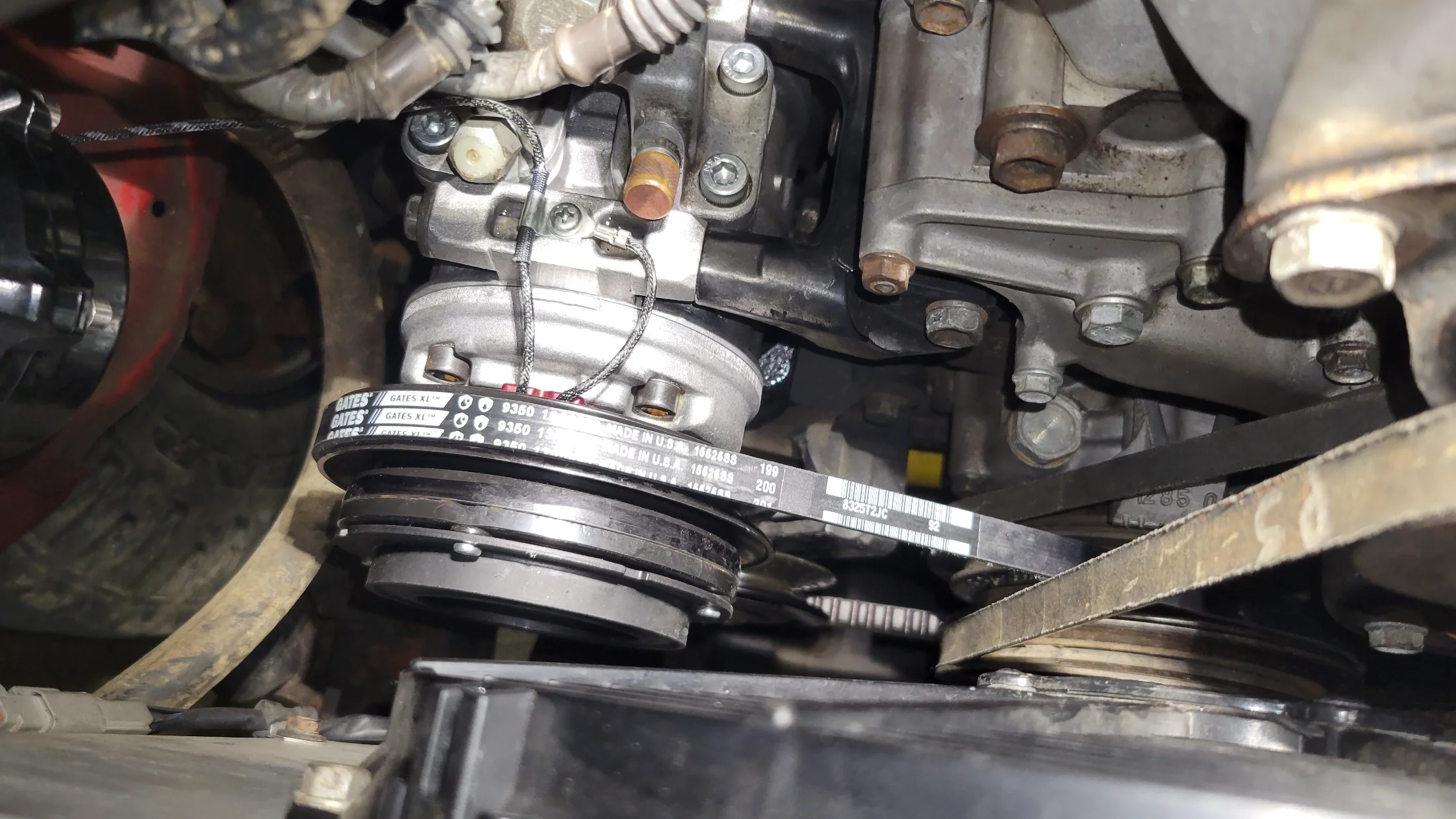

Ended up with a new belt and pulley.
Gates 9350 ac belt
AC blowing cold
Still ripping 14 PSI of boost with the AC on. With the hot condenser my MAT is still holding 20F over ambient while cruising. Radiator and fan are holding temps at idle with AC on today while it was 85F out. Fan kicks on at 205, temp peaks at 208 and after ~90 seconds kicks off at 202F.

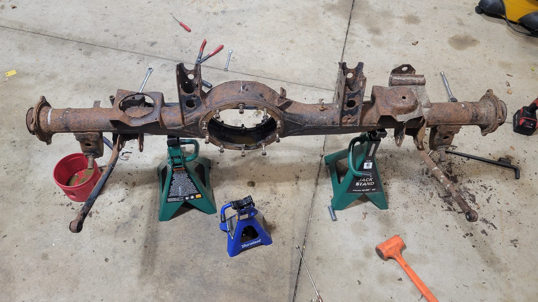

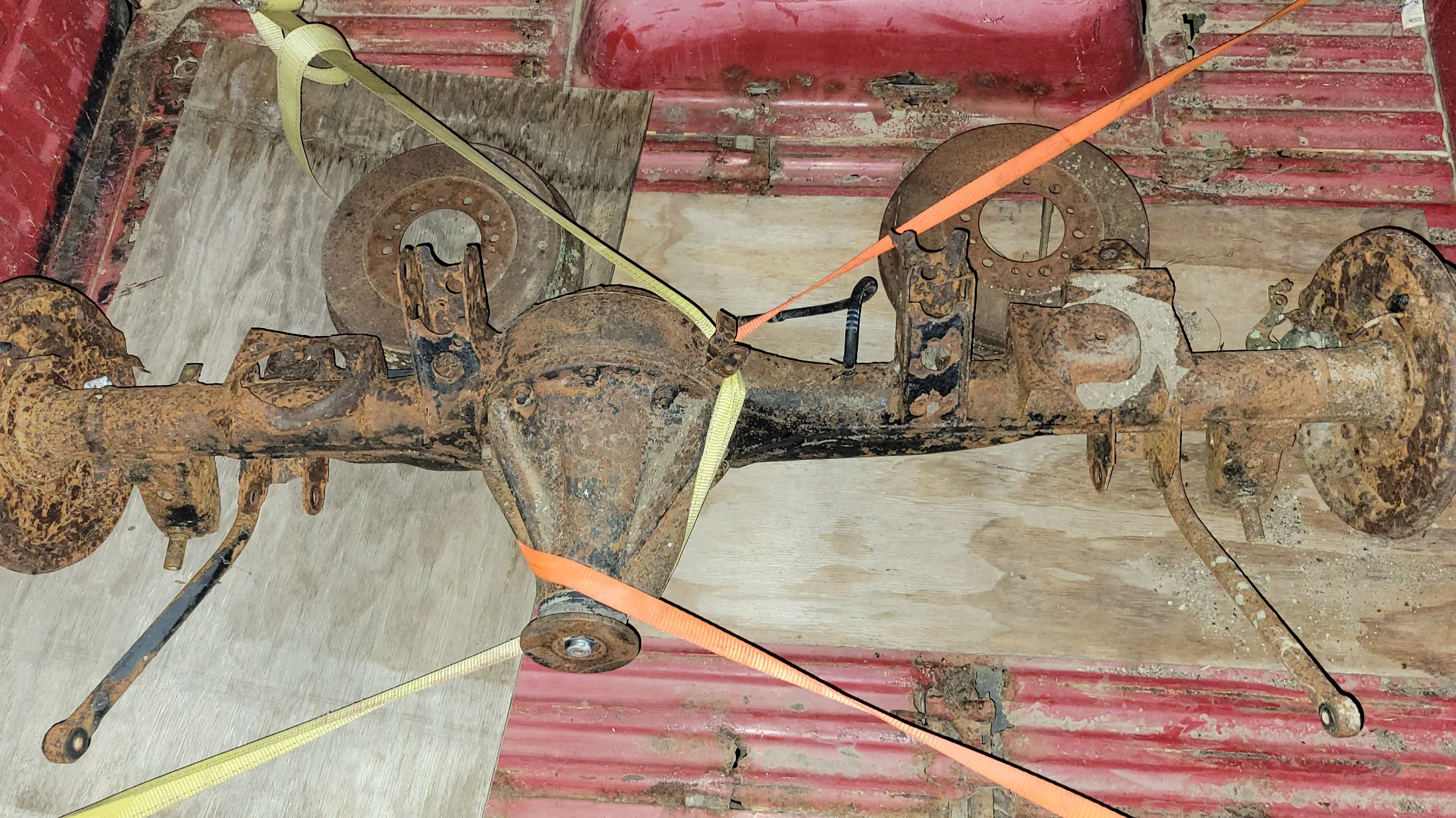

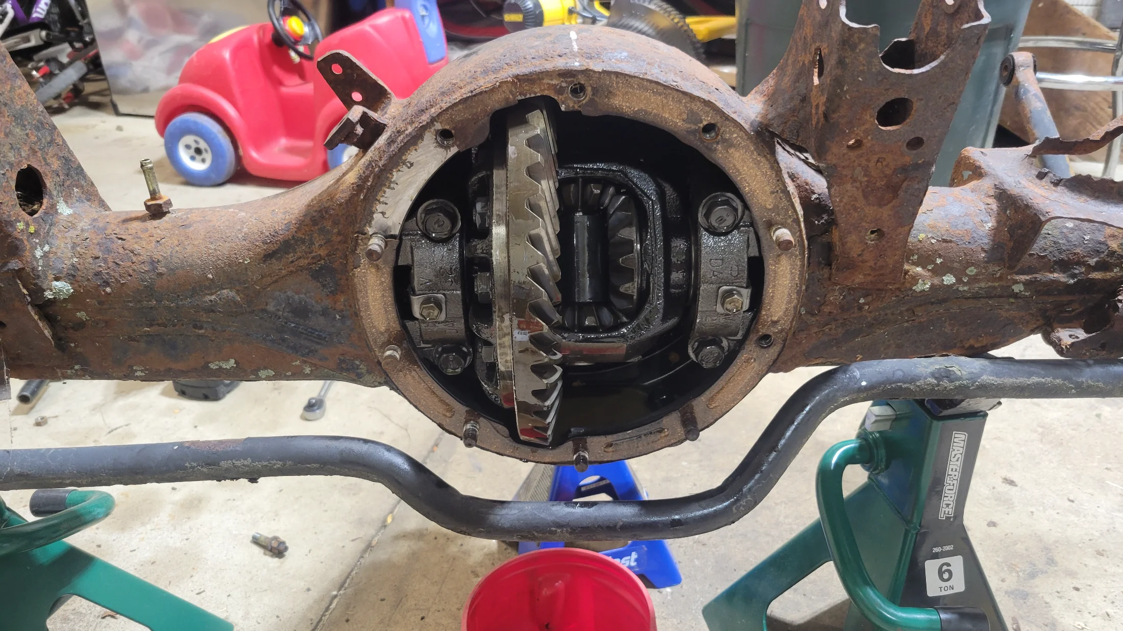

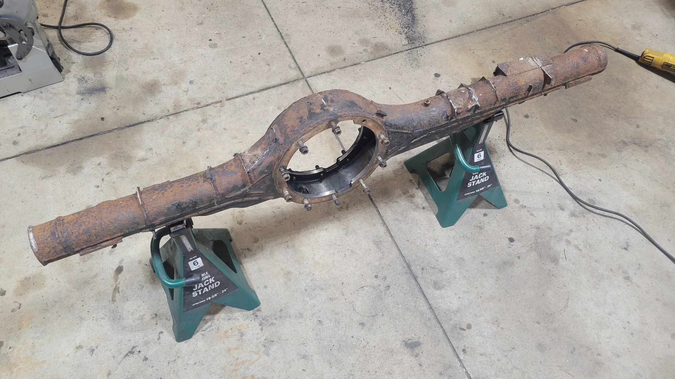

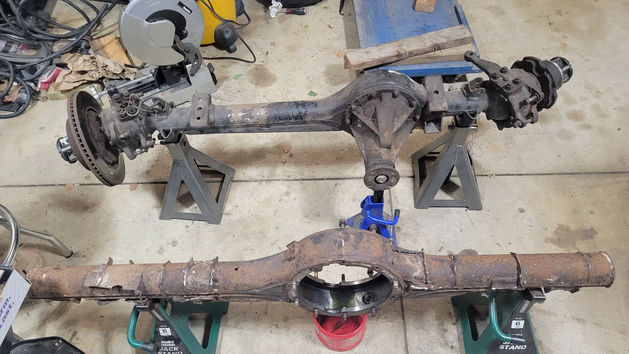

Oh and I picked up a 92 land cruiser rear end for $100 for a hybrid 9.5" mini truck rear end
Still had gear oil in it. No metal shavings.

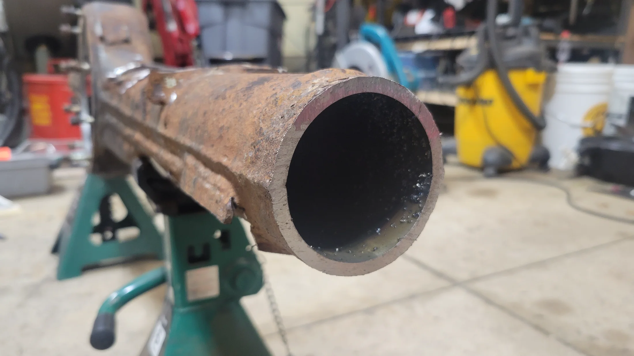

Ordered bearing pockets, weld on flanges, wheel bearings, and Yukon chromoly axle shafts. Plan is to shave down to the toyota 3" tube and sleeve with 3.5" 1/4 wall. Keeping it 58.5 Wms with a rear air locker

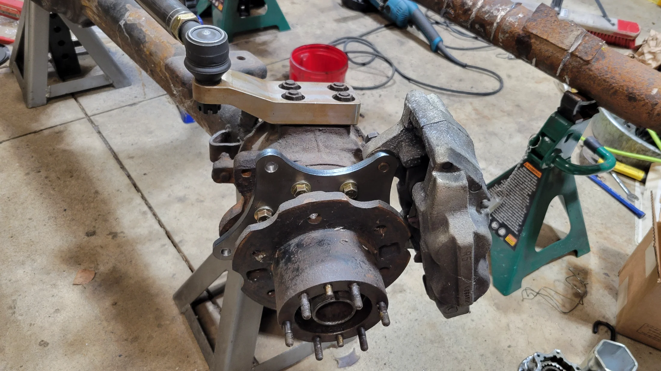

Dug the front axle out of storage and started playing around with steering and brakes.
IFS hubs turned down 0.600"
Pays off to keep old sequoia and Lexus brake parts laying around for mock up.
Rear axle is giving me trouble. OD is actually around 3.15" and I don't feel like grinding a perfect 0.200" for the tube to slide on. Waiting for an idea on that one
Playing around in photo shop for the digital dash background and the clutch finally let go at 3000rpm so I get to take the Uniclutch out of the box
