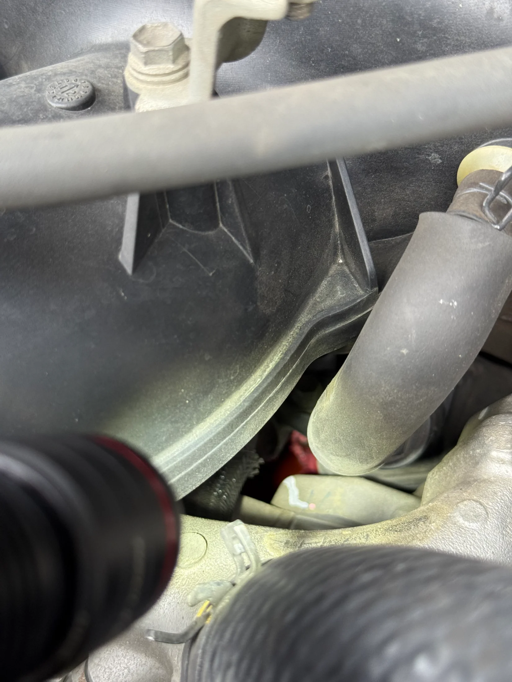

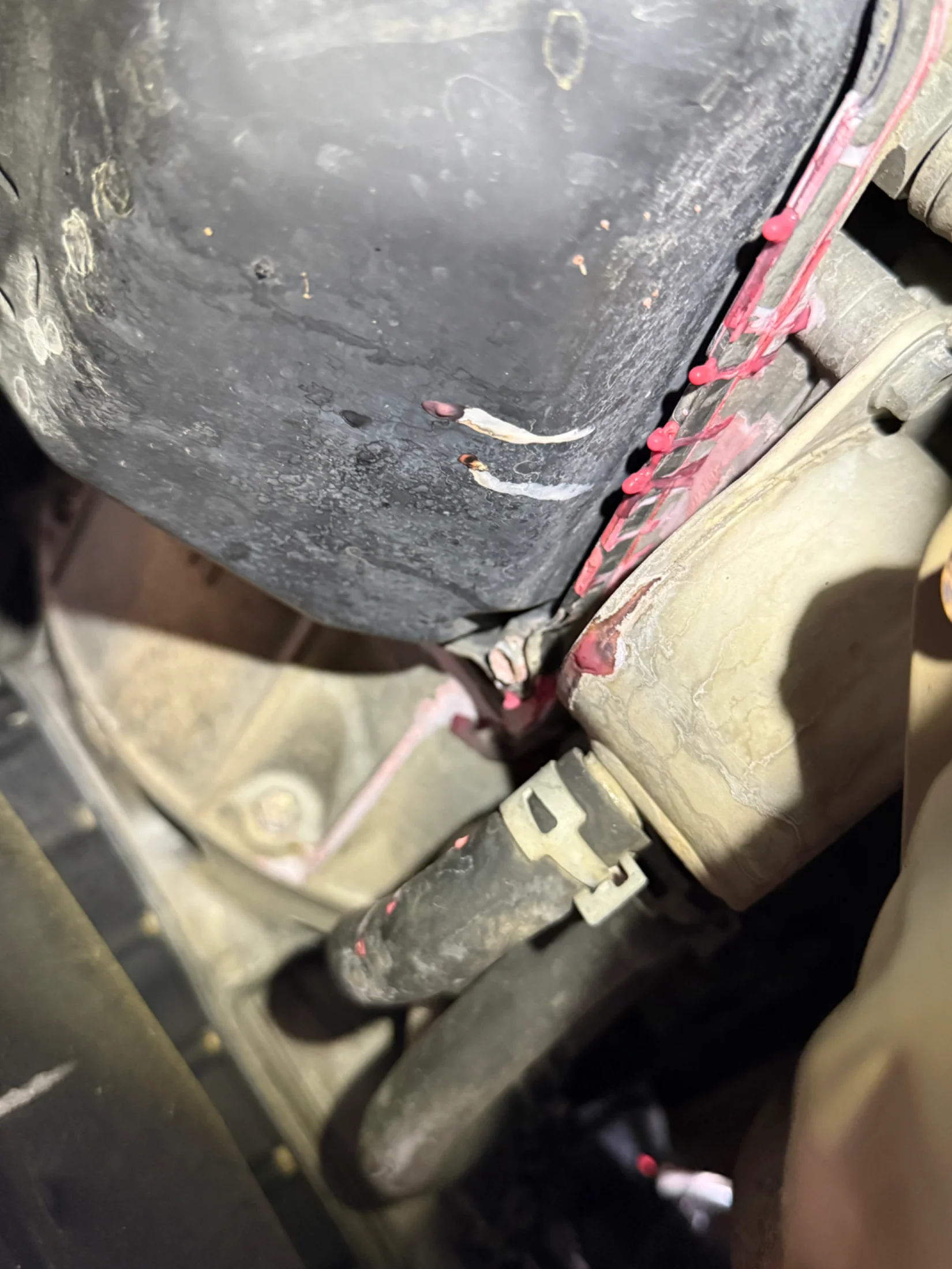

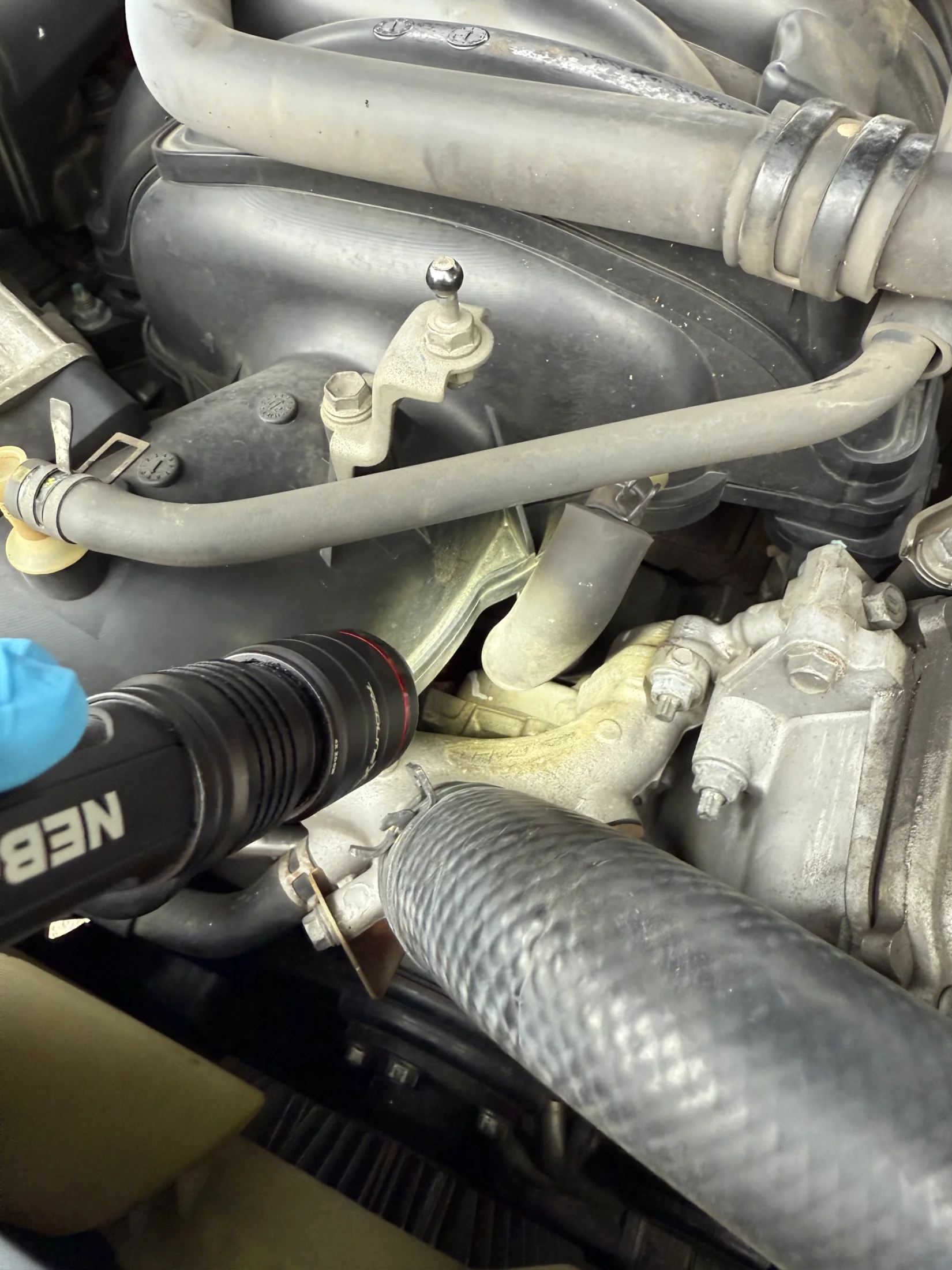

Hijack old thread…does this look like valley plate leak? 2013 LC200. Pics from above and below.

Yep.
Make sure your coolant stays topped up and find someone you trust to fix it. Risk of a catastrophic blow-out of the plate is basically zero, but if you let the coolant get low and the engine get hot your odds of a head gasket issue go up a lot.

Thanks! I grabbed a new jug of Toyota super LL coolant yesterday. Think it’s been leaking for a while now. Prob a week or two before I can get it in somewhere.
