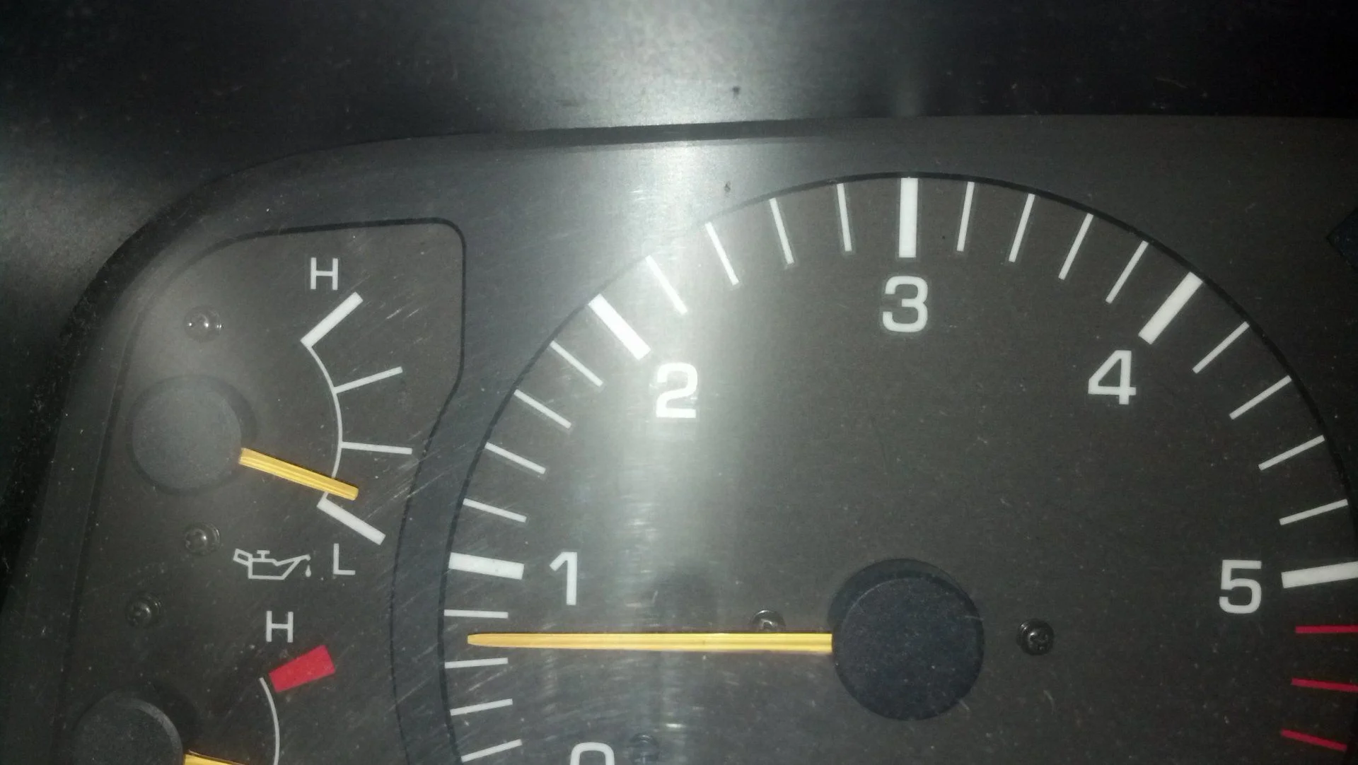

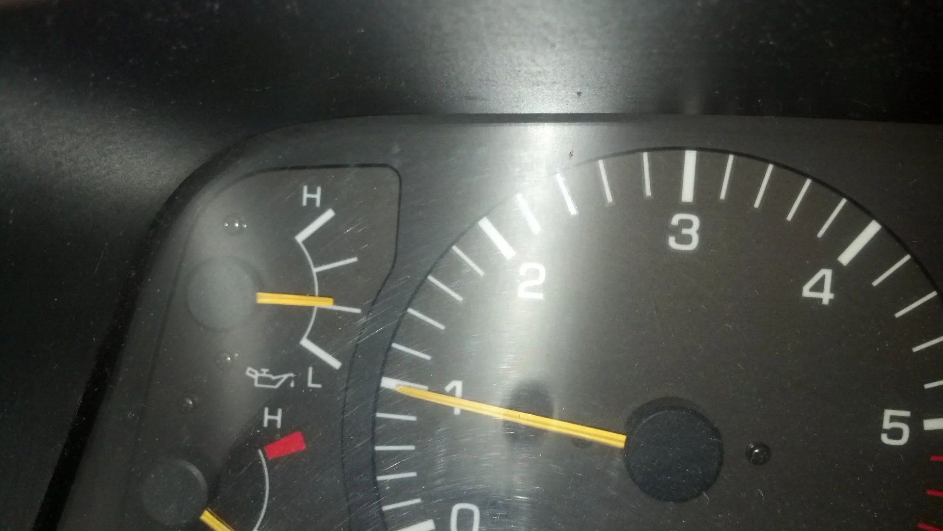

Also is this normal for oil pressure;
at start-up...
After approx 5 min after startup...
My 92 with a 3FE doesn't do that. It stays about the same. Goes up a touch when RPMs increase. Seems awfully low. Maybe someone wit a 1FZ-FE will chime in.
